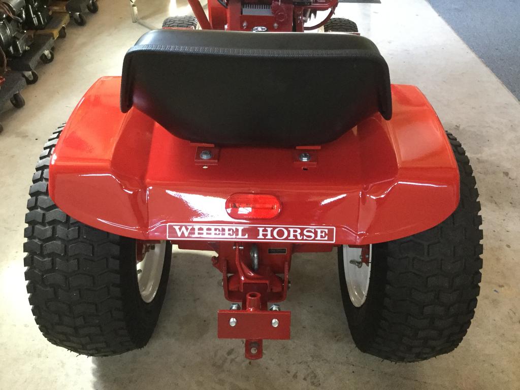

richmondred01 2,383 #6 Posted April 7, 2020 If you have slot hitches rather then clevis wheelhorseman1000 makes a very nice adaptor. 1 Share this post Link to post Share on other sites
