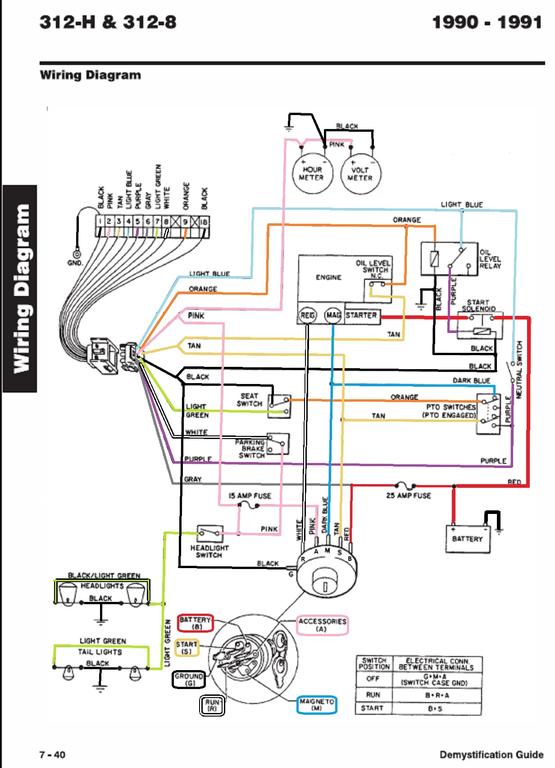

Achto 32,115 #6 Posted April 6, 2020 It really sounds like you have an electrical issue. A multi-meter or a simple test light will be very useful to help find the problem. Start by making sure that you are getting power to the switch, then move on to power coming from the switch to the various functions. 2 Share this post Link to post Share on other sites

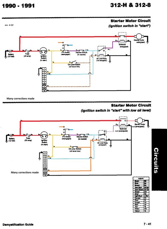

gwest_ca-(File Mod) 12,371 #7 Posted April 6, 2020 Adding some color to this one and making corrections. More pages to do for this model. Garry 1 Share this post Link to post Share on other sites
