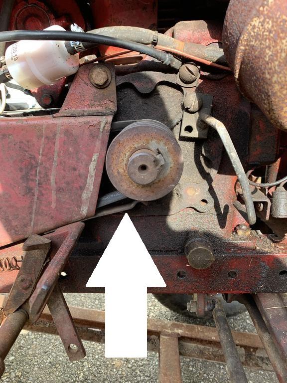

Crmaverick 91 #5 Posted April 8, 2020 On 4/7/2020 at 6:22 AM, wallfish said: At the brake band there's a 3/8 threaded rod with a nut (9/16) to adjust the brake band tension. Backing it off allows the idler pulley which tensions the belt to move down a little more to slack more belt. There's a fine line on adjusting it properly. The belt guard needs to be on the tractor to guide the belt or it will not slack properly. The engine pulley groove must be clean and smooth. No, you can not lock the differential. I adjusted the brake band, it works but you really have to burry the pedal far down to get that belt to fully disengage. Is the belt guide adjustable? Share this post Link to post Share on other sites
wallfish 20,724 #6 Posted April 8, 2020 Are there any small belt guides attached to the engine around the drive pulley? They would be made of 3/16 or 1/4" round bar and attached to the engine block with bolts. Share this post Link to post Share on other sites

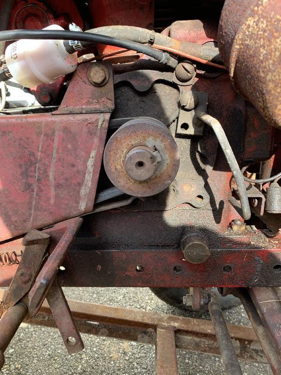

Crmaverick 91 #7 Posted April 8, 2020 1 hour ago, wallfish said: Are there any small belt guides attached to the engine around the drive pulley? They would be made of 3/16 or 1/4" round bar and attached to the engine block with bolts. Looks like I don’t have one for the drive belt? Share this post Link to post Share on other sites
wallfish 20,724 #8 Posted April 8, 2020 (edited) This tab on the belt guard can be adjusted. Bend it close to 1/8" from the belt with the pedal out and belt tight so you can just do it with it parked and not running. Is your main issue that the trans gears are grinding when shifting? Edited April 8, 2020 by wallfish Share this post Link to post Share on other sites
Crmaverick 91 #9 Posted April 8, 2020 1 minute ago, wallfish said: This tab on the belt guard can be adjusted. Bend it close to 1/8" from the belt with the peddle out and belt tight so you can just do it with it parked and not running. Is your main issue that the trans gears are grinding when shifting? Yeah exactly a little grind going in. Thanks Share this post Link to post Share on other sites
wallfish 20,724 #10 Posted April 8, 2020 (edited) The idea is to support the belt loop around the engine pulley enough so the belt doesn't drop in the pulley groove from the top or stay in the groove on the bottom. Sometimes bending that top section of the guard up or down will help as well, but keep in mind if you bend it down, it also raises that bottom tab and vise versa if bending it up. If the belt was too short to begin with, that could be a problem Make sure the pulley groove is clean an smooth. rust or paint in there will cause that too Edited April 8, 2020 by wallfish Share this post Link to post Share on other sites
