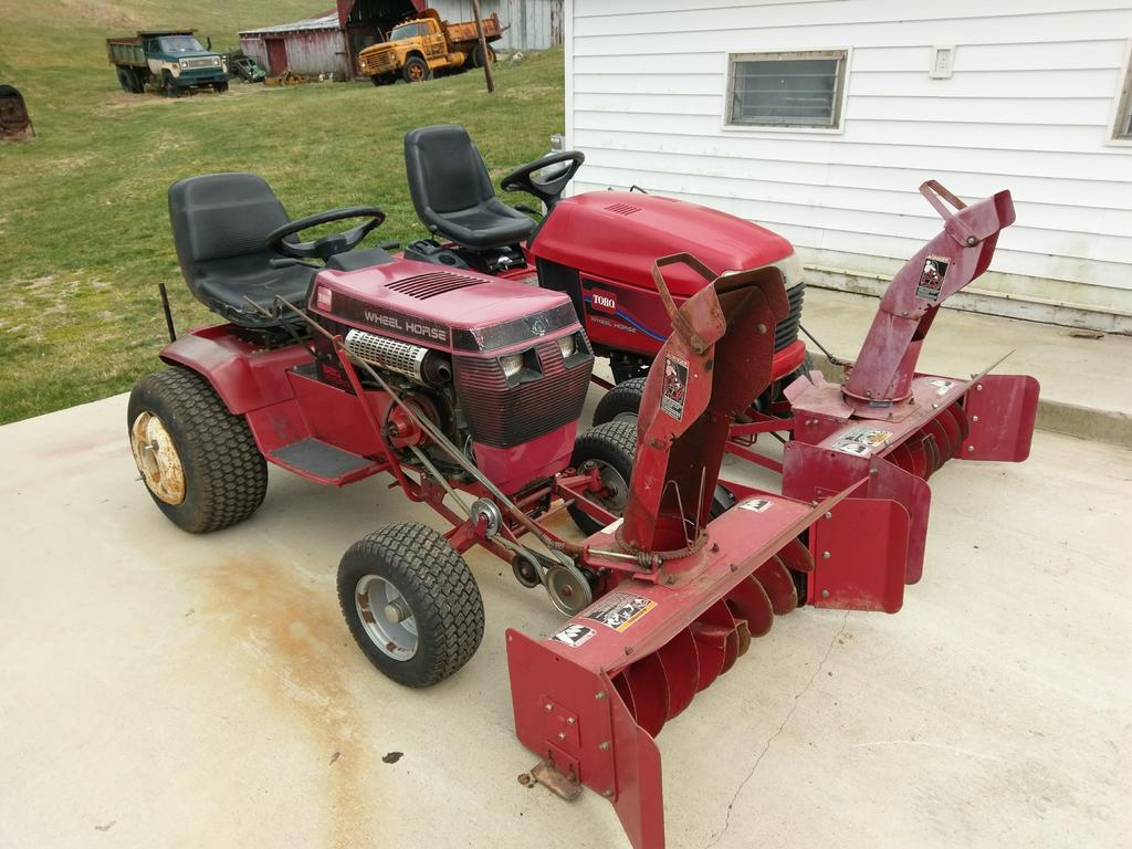

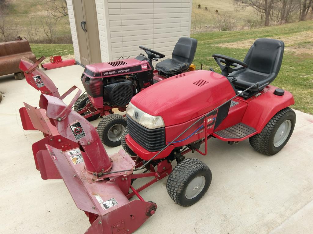

WVHillbilly520H

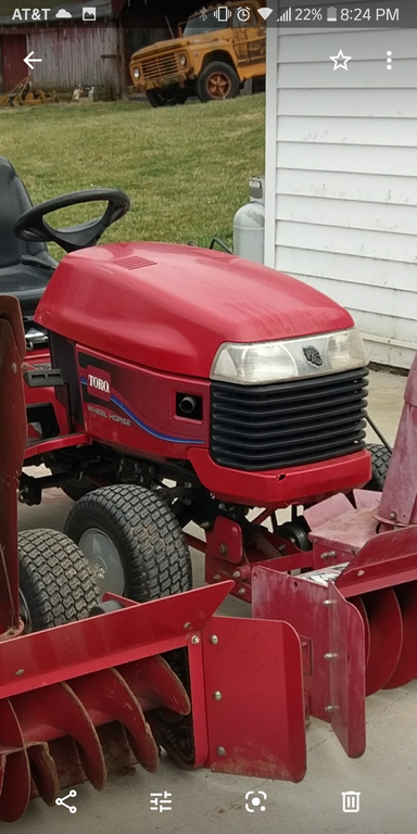

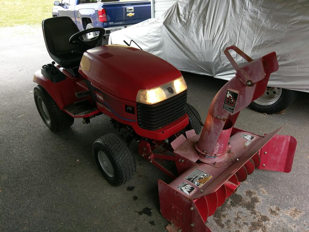

Is it a 520xi with foot pedal motion control and 2 spd hydro? If so that engine needs to be pulled and tins removed periodically, the oil leak makes it worse as this attracts and holds debris like dust grass and chaffe. Those Kohler Command can still be had new for around $1200, but honestly it should only take you a weekend to pull, clean and repair that engine vs replacement JMO. (BTW the 520H is the classic no engine side shields with the opposed twin Onan). Here they are side by side on the left 520H right 520xi.

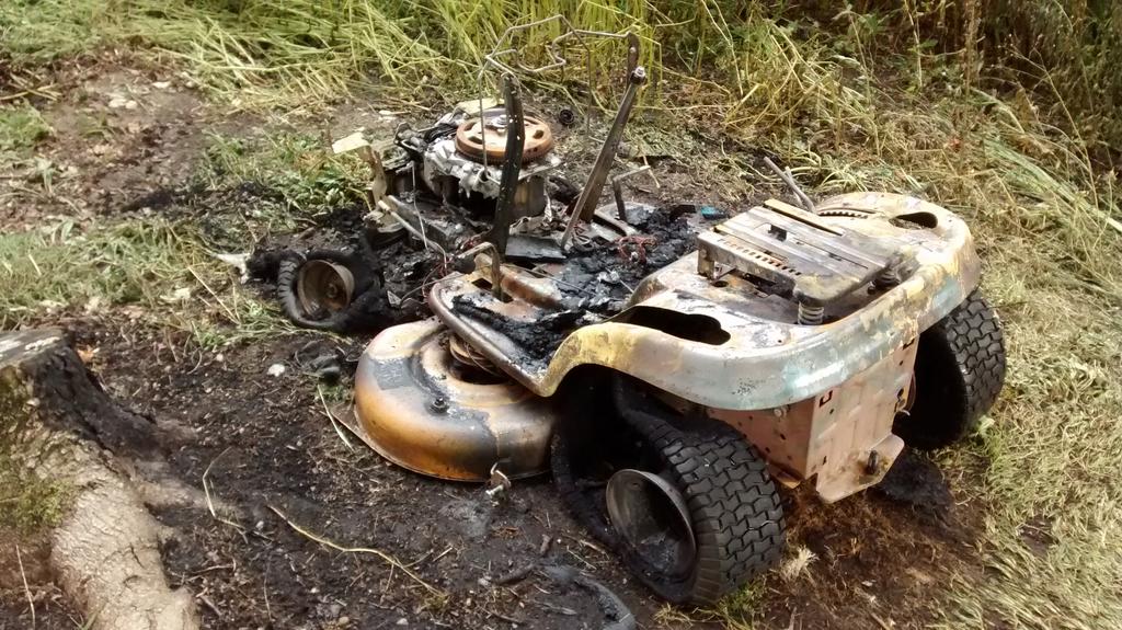

I'm going to add one more reason to periodically clean out inside the tins and around the engine. One photo tells it all. The critters haul all kinds of grass, acorns, and other nesting materials into the tractors. When I blew everything out of the other tractors after this incident my mother in law had, I had to dodge all kinds of debris. It wasn't caused by a fuel leak, but grass and mouse nests. By the time the FD got there there wasn't anything to do but break out the hot dogs and marshmallows. Fortunately nobody got hurt, it didn't spread, and the insurance company covered it at full replacement cost minus deductible..

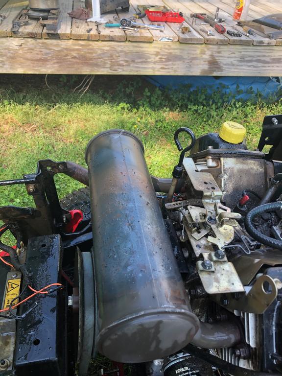

I tried the cleaning and it was terrible dirty, grass cuttings and dirt clogging some of the fins.  I believe the wrong muffler is on the 520 XI. Someone had cut part of the heat shield off to make room for the muffler exhaust out the side.  Muffler also looks as if it has over heated as the outer can has bubbled and is discolored.  Not sure what I am going to do at this point.  I am considering a CH750 as a replacement.  I will not scrap this beast as I detest the throw away mentality.  Even if I can buy another for close to that price I might do both and just keep the old engine and rebuild it for a project.
IMO get you some Gunk engine degreaser  (Simple Green or Purple Power degreaser full strength) get that engine fired up running 15-20 minutes or longer then spray it down with the degreaser (even brake cleaner/oven cleaner) let set 10 minutes or so agitating with a brush or scraper to get the worst off then rinse whether with a garden hose sprayer or a pressure washer to get most of that crap off the engine. Those series Kohlers seem to have crank seal issues and while you're at it replace those as well as the valve cover gaskets will help relieve some of the crime issues... Once back together compressed air cleaning after (each) mowing will help greatly as well. The muffler I can't help you with maybe @shallowwatersailor can shed some light on whether that's factory or not but on the 520xi I had for a very short time the exhaust did exit out the right side engine shield/cover.
Chestnut
That's a pretty oily dirty mess. I checked on Jack's Small Engines at the parts list for a generic Kohler CH22-66507 and the replacement sheet metal looks like it's available and not too expensive. There are a couple of different muffler configurations listed but I don't know what that tractor came with. The mufflers are on the pricey side, anyway. All that said, it's your call whether to pull that engine, replace, and use it for another project or just clean it up, correct any oil leaks, correct the airflow issues, and see how it runs. The same website shows three different part numbers for mufflers that exit on the starter side. Not obvious what's different between them. It's possible that previous owner got the wrong one and decided to do some surgery to make it fit.
