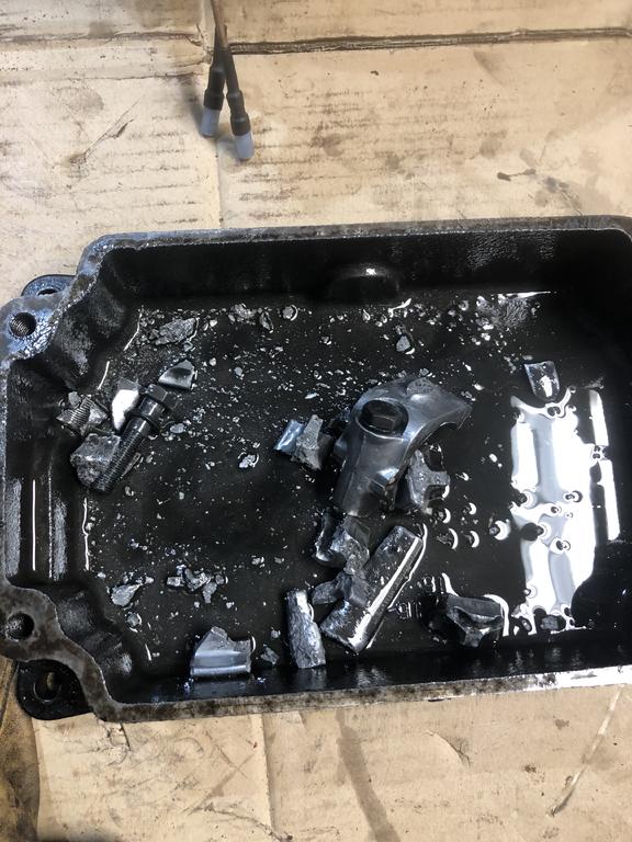

The Tuul Crib 7,354 #10 Posted April 7, 2020 This is what you dont want to happen! 1 2 Share this post Link to post Share on other sites
