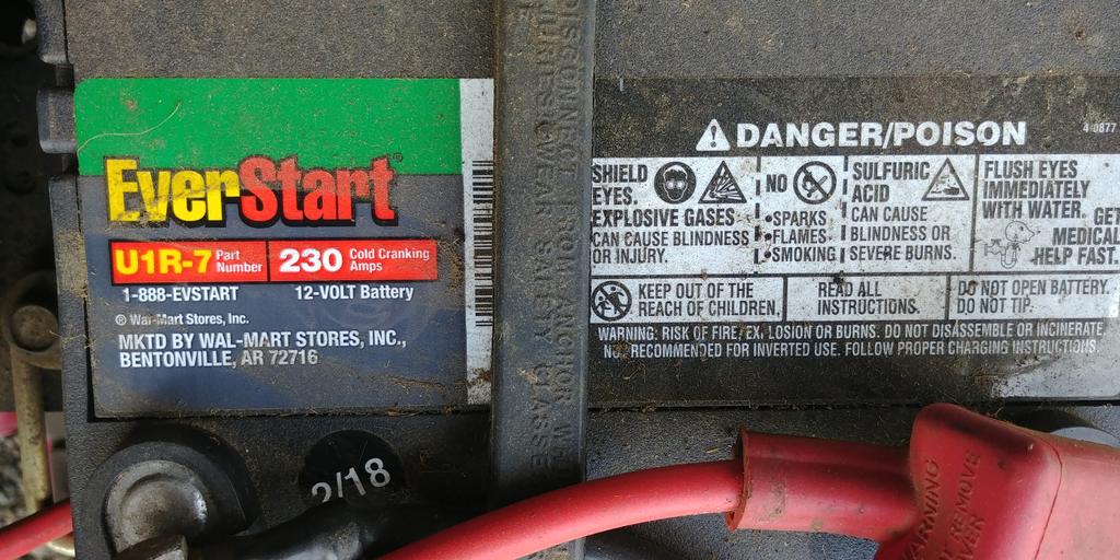

WVHillbilly520H 10,378 #3 Posted April 5, 2020 2 hours ago, blackwater73 said: What battery would be good to use in this tractor? How many cranking amps would it require? I'm currently using a Wal-Mart Everstart U-1 230CA in my 315-8, about $25.00. 2 Share this post Link to post Share on other sites

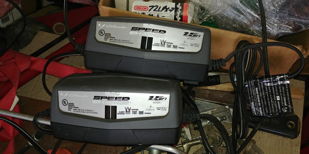

peter lena 9,993 #4 Posted April 5, 2020 agree with others above , i like the walmart everstart 360 , i live in cold country and the extra zap is very good . while you are at wally world , you can also check out the , BATTERY TENDER , charging set up . i have the quick plug in wired onto all three of my tractor batteries , letting me plug in for battery maintenance at any time. pete 1 Share this post Link to post Share on other sites
lynnmor 8,970 #5 Posted April 5, 2020 1 hour ago, peter lena said: agree with others above , i like the walmart everstart 360 , i live in cold country and the extra zap is very good . while you are at wally world , you can also check out the , BATTERY TENDER , charging set up . i have the quick plug in wired onto all three of my tractor batteries , letting me plug in for battery maintenance at any time. pete I use batteries made by East Penn with good results, not sure who makes Walmart batteries. I look at the lower end, (under 300 CCA) batteries as half a battery, priced to sell. I too, use the Battery Tender brand chargers for their multiple stage charging, and would not use the cheap things. I rotate the charger so that each battery is on it at least three days per month, disconnecting it just after the light turns green is not a complete charge. The quick connect plugs are a real convenience, but again, don't buy the cheap junk on eBay, ask me how I know. Keeping a battery fully charged is necessary for long life. 1 1 Share this post Link to post Share on other sites

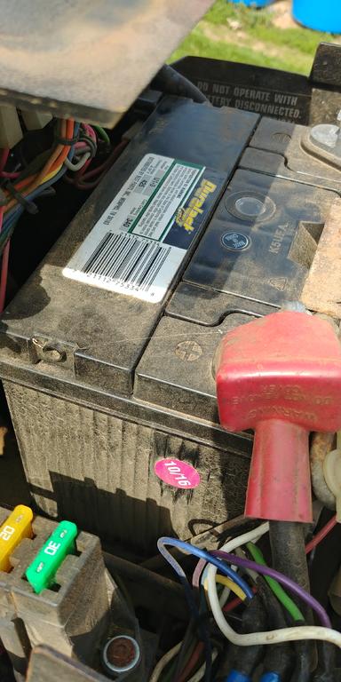

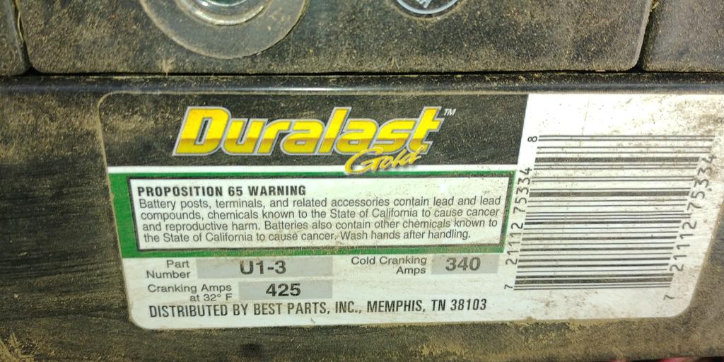

ZXT 2,402 #8 Posted April 5, 2020 From my experience, I've found that spending the extra $10 on the 350CCA battery over the 230 is a wise choice. When you're cranking on an engine, if the battery is undersized it will be working harder and heating the plates up. Plate warpage = quicker death of the battery. I've never found the bottom of the line cheapo batteries to last more than a year. I tend to use Duralast lawn mower batteries. They're the only brand I've ever bought and had last more than 3-4 years. I've had a couple to last 9 years, and they never once saw a battery tender. I did have one mower battery from Tractor Supply that was still good on a cheapo mower that I was given in 2018. Battery was dated mid 2009, so it looks like they might be good as well. I bought a new battery about a week ago for my yellow tractor and did some looking at reviews. I looked at Walmart first since their 350CCA battery is something like $39 whereas everywhere else they're $49. Every review on the battery said that it died in less than 2 years. Oreilly's (Superstart) has one that has decent reviews and I do own one of them. It's about 1.5 years old and no problems yet. Autozone (Duralast) is the only one that I found numerous reviews of people stating that the battery lasted 5+ years. It also has a 4.7 rating whereas the others were in the low 3 range. So, if you have an AutoZone near you, I'd suggest a 350CCA Duralast. 2 Share this post Link to post Share on other sites
