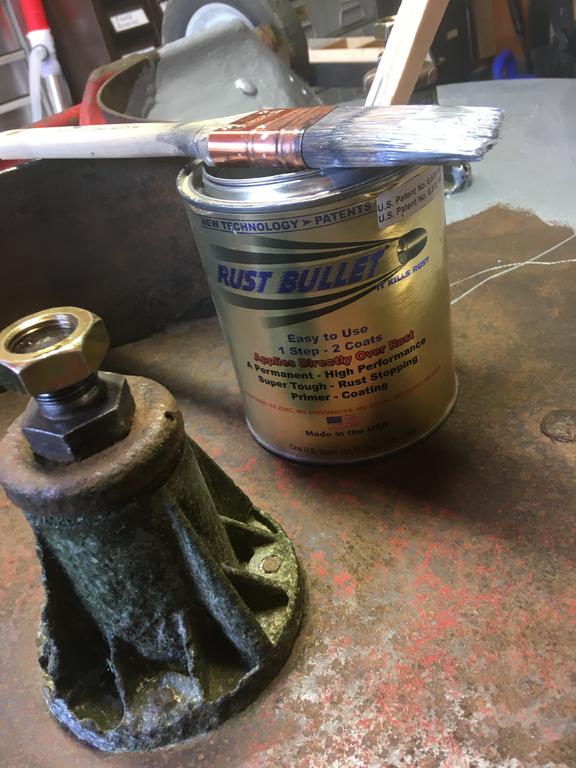

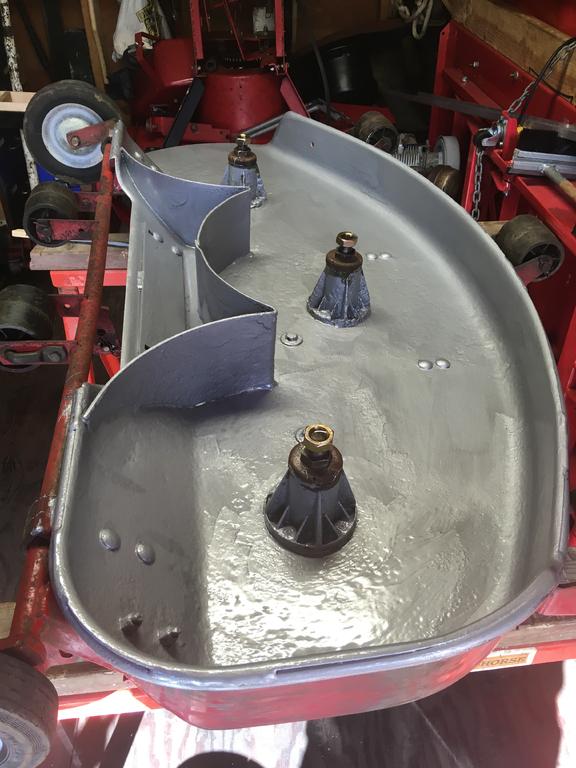

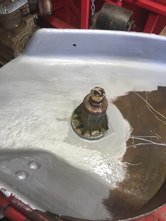

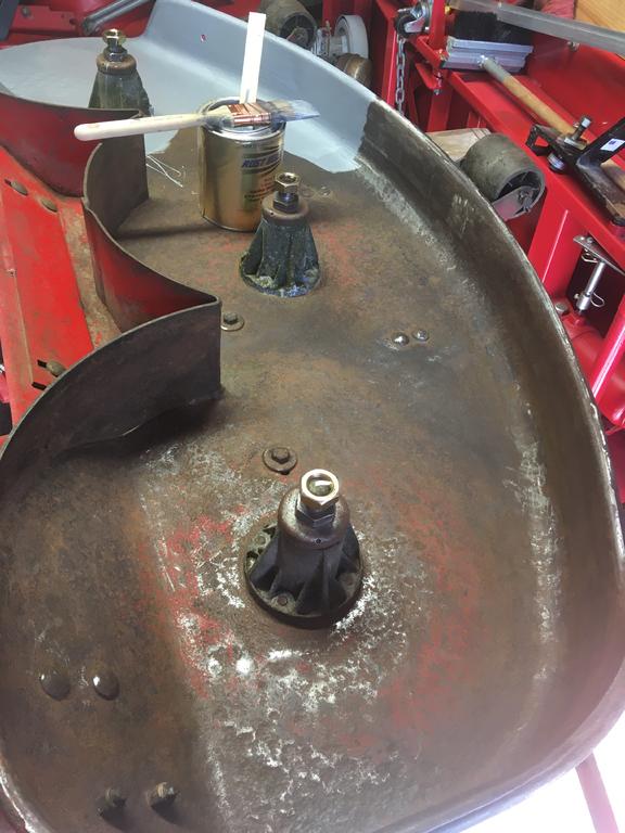

formariz 12,051 #1 Posted April 4, 2020 (edited) Cleaned my deck using a descaler and now coating it with this stuff I had here left over from keeping my old Toyota truck from falling apart. This stuff works really well. No more rust once it’s applied. It’s almost like an epoxy. Edited April 4, 2020 by formariz 6 10 Share this post Link to post Share on other sites
JoeM 8,497 #2 Posted April 5, 2020 I take it drys smooth and pretty non stick? Share this post Link to post Share on other sites
hotajax 229 #3 Posted April 5, 2020 That looks good. The smooth surface should make it more difficult for clippings to consolidate. I'm sending mine over to you. 1 2 Share this post Link to post Share on other sites
formariz 12,051 #4 Posted April 5, 2020 (edited) 57 minutes ago, TractorJunkie said: I take it drys smooth and pretty non stick? It dries extremely smooth. It will take a second coat in a couple of days. It is thick and it also dries extremely hard. Very hard to scratch it with a screw driver. Adhesion is also insane. Almost impossible to remove. https://rustbulletuk.com/en/ Edited April 5, 2020 by formariz Share this post Link to post Share on other sites

formariz 12,051 #8 Posted April 5, 2020 (edited) @pfrederi Thank you, copied wrong link. 1 hour ago, tunahead72 said: So it should stand up to frequent routine cleanings with a putty knife for example? I never used it before in this application but it should. Right now running a putty knife on it it feels just like glass in smoothness and hardness. My experience with it started with a Toyota truck that I had. Frame was rusted pretty badly so we removed be and cleaned what we had access to in the exterior of frame. For about 8 years there never was a single point of rust on what was painted with it until one day frame broke. Upon inspection frame of course kept rusting from the inside out leaving only a very thin metal part with intact paint attached to it. I am sure it made truck last a few years more than it would without it. Bad thing about it is that it is not cheap. Should read on web site about it on drying and how it works. Its nothing like paint. It was originally developed by or for the US Military to coat the wing tips of jet fighters so there would be no wear at supersonic speeds. Edited April 5, 2020 by formariz 1 1 Share this post Link to post Share on other sites
formariz 12,051 #9 Posted April 5, 2020 As I mentioned before after an initial scraping with a putty knife to get the bulk of grass out, I used a descaler to finish cleaning deck. That was a first for me. Although it is a slow and noisy process I believe it is the tool which does the best job. In tight corners and other areas where grass has a tendency to accumulate heavy rust start to eat away at deck. This tool will get into the tightest spots and remove rust all the way to the metal. I am pretty fussy with these things and I have never been able to clean a deck this well. I believe that this method combined with the Rust Bullet will add many years to the deck. 1 Share this post Link to post Share on other sites
