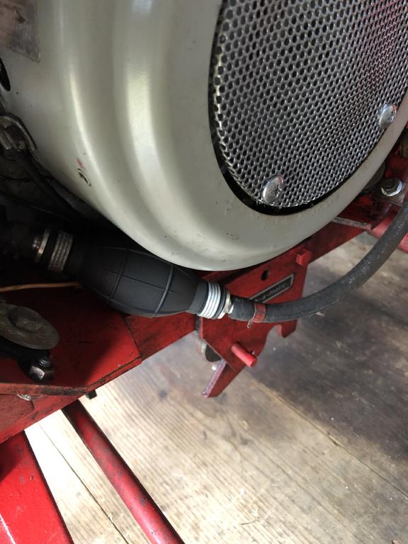

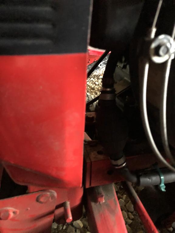

Rob R 980 #18 Posted April 4, 2020 (edited) My two cents like to stay OEM and adding an electric pump is fine but to me just adds another point of failure and drain on the battery etc. ..... just add a simple marine in line fuel hand pump two gentle pumps after the machine has been sitting all winter and it will start right up end of issue...… just saying...… p.s. the hand pump has and internal check valve so once you do this the line stays charged for a long period of time. Edited April 4, 2020 by Rob R Share this post Link to post Share on other sites
hotajax 230 #19 Posted April 4, 2020 (edited) 2 hours ago, Rob R said: My two cents like to stay OEM and adding an electric pump is fine but to me just adds another point of failure and drain on the battery etc. ..... just add a simple marine in line fuel hand pump two gentle pumps after the machine has been sitting all winter and it will start right up end of issue...… just saying...… p.s. the hand pump has and internal check valve so once you do this the line stays charged for a long period of time. Thanks, Rob. Can't beat simplicity. And never a risk of a battery drain. Very cool. PS: What's with your motor-mouth governor? Edited April 4, 2020 by hotajax Share this post Link to post Share on other sites
