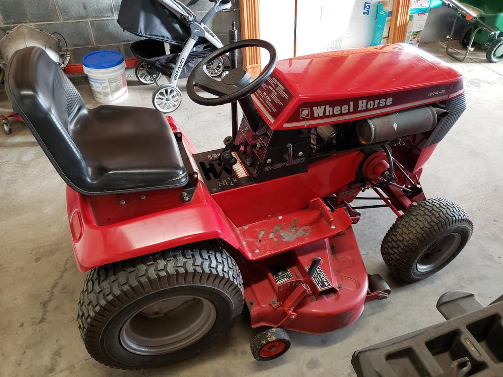

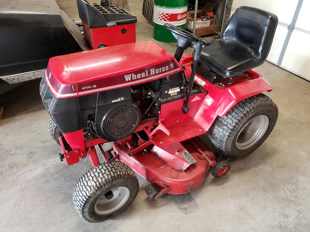

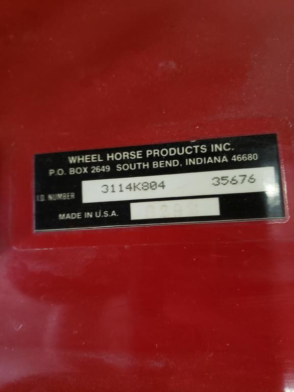

DavidCozzi92 3 #1 Posted April 2, 2020 Hello, this my first post on the forum and I'm hoping you all can help me. I have a 414-8 wheel horse in my shop for a customer and I'm looking for a missing piece. He has a rear discharge deck and wants to block off the back side but cannot locate the part to do so. Our local Toro/Old wheel horse dealer looked for it based on his serial number and told him it has been discontinued. I'm hoping someone has one, if not even just a picture of one would help as I cam fabricate something to bolt on. I will post pics of the mower and the serial number in Hope's that someone has information on this part. Thanks for the help -Dave C. 3 Share this post Link to post Share on other sites

troutbum70 858 #5 Posted April 2, 2020 I can't help either but your customer has a pretty nice looking older horse. I did not know wheel horse even made the piece, was that to turn the deck into a mulcher? Share this post Link to post Share on other sites

peter lena 9,943 #8 Posted April 2, 2020 agree with varosd , with making up a rubber bolt on strip on the deck , T/S or related hardware stores have rubber matting that can be easily cut and fit to the job. b t w. you do not want to block the discharge off , you want to slow down the discharge and deflect it , reducing the clumping . nice looking 4-14-8 you have there . pete 1 Share this post Link to post Share on other sites

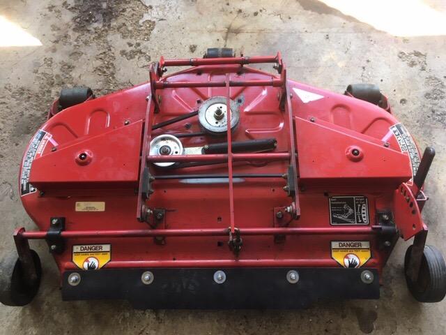

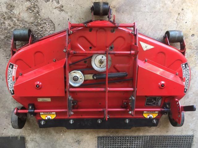

tom2p 2,394 #9 Posted April 2, 2020 (edited) 15 hours ago, DavidCozzi92 said: He has a rear discharge deck and wants to block off the back side but cannot locate the part to do so. I'm not aware of a part that blocks off the back side of a 42" RD deck I believe a defector was offered at one time (?) - but if I saw one it has been so long can't recall As you stated - could fabricate one (metal) - or make a fairly crude one from industrial belt / rubber / plastic material similar to one pictured below. Edited April 2, 2020 by tom2p 2 Share this post Link to post Share on other sites

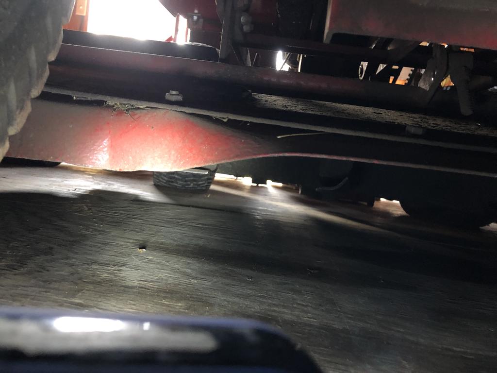

JoeM 10,098 #12 Posted April 2, 2020 Rear add on defector, I think this is what you were wanting?? 1 Share this post Link to post Share on other sites
varosd 1,185 #13 Posted April 2, 2020 Sorry for such a poor picture! looking from rear to front, you can see the down turn on the left and straight back in the middle. Not shown is the right side down turn Share this post Link to post Share on other sites
