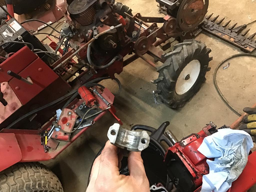

Pullstart 70,767 #1 Posted March 30, 2020 I can just polish the crank with emory tape, right? This is the product of a K-161 that I rebuilt the summer I joined the forum, when I bought Putt Putt from Bob Rock. Lesson learned? Turn your crank! The benefit to a sad loss after all this time, it’s the same piston and rings in the K-181 as the K-161. Bad Wolves was on the radio when I took this picture. “If I only knew then what I know now, then what I know now!” 3 7 Share this post Link to post Share on other sites

ZXT 2,402 #6 Posted March 30, 2020 So you got another 7 years out of an engine simply by cleaning the crank with emory tape? Doesn't sound too bad to me. 6 Share this post Link to post Share on other sites
The Tuul Crib 7,354 #7 Posted March 30, 2020 Kevin l would definitely think about having the crank checked or turned you can always go .010 under on the rod to make it work. 3 Share this post Link to post Share on other sites

Pullstart 70,767 #10 Posted March 30, 2020 33 minutes ago, ZXT said: So you got another 7 years out of an engine simply by cleaning the crank with emory tape? Doesn't sound too bad to me. No, about 2 or 4 hours... it’s just been in the barn that long! 1 3 Share this post Link to post Share on other sites

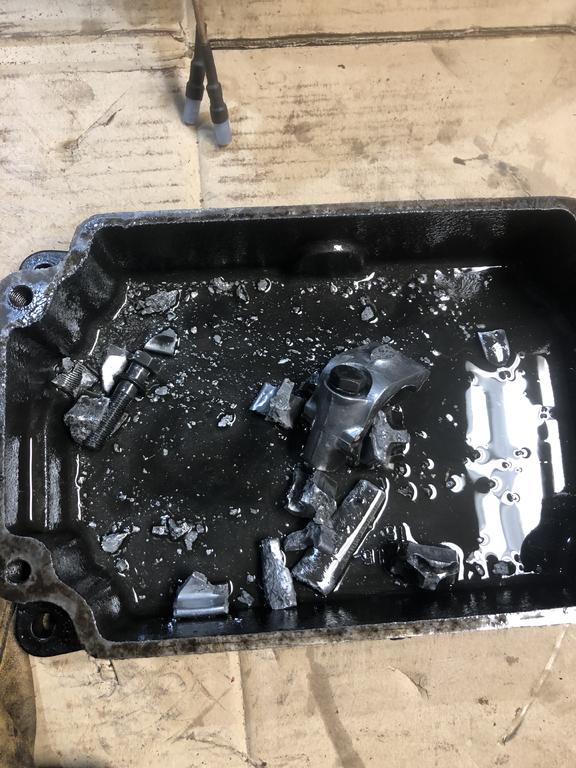

953 nut 67,489 #11 Posted March 30, 2020 At least it didn't ventilate the side of the block and bust up a bunch of good parts. 2 Share this post Link to post Share on other sites
Pullstart 70,767 #12 Posted March 30, 2020 12 minutes ago, 953 nut said: At least it didn't ventilate the side of the block and bust up a bunch of good parts. That would have been next, I’m sure. The rod cap came apart by hand last night 1 Share this post Link to post Share on other sites

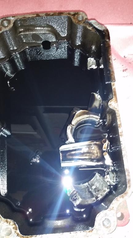

The Tuul Crib 7,354 #13 Posted March 30, 2020 This is what happened to a 341 put together without checking tolerances! 3 Share this post Link to post Share on other sites
WHX?? 57,470 #14 Posted March 30, 2020 Is this the part where we start showing ungly pics?!?!? 11 hours ago, nylyon said: Yes, you get the test, then the lesson follows Quiz after the lesson … What happens when you don't check your oil at plow day?? 6 Share this post Link to post Share on other sites

oilwell1415 563 #17 Posted April 2, 2020 On 3/29/2020 at 9:01 PM, pullstart said: No, about 2 or 4 hours... it’s just been in the barn that long! But what shape was it in before you "cleaned it up"? You were in there for a reason. For all you know, that was 1.9-3.9 hours more than it would have gotten other wise, but splash oiled journal bearings aren't nearly as forgiving as pressure oiled either. Share this post Link to post Share on other sites
Pullstart 70,767 #18 Posted April 3, 2020 5 hours ago, oilwell1415 said: But what shape was it in before you "cleaned it up"? You were in there for a reason. For all you know, that was 1.9-3.9 hours more than it would have gotten other wise, but splash oiled journal bearings aren't nearly as forgiving as pressure oiled either. It was knocking when I bough it, really bad. Share this post Link to post Share on other sites

oilwell1415 563 #21 Posted April 3, 2020 13 hours ago, pullstart said: It was knocking when I bough it, really bad. So it was dead and gone already. What you did didn't kill it, but it wasn't the medicine it needed either. 1 Share this post Link to post Share on other sites
