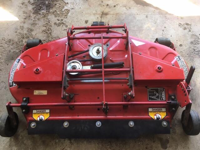

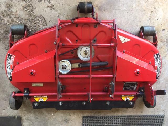

tom2p 2,396 #18 Posted March 30, 2020 (edited) have a 42" RD deck on one tractor don't have a mulching kit - but I have noticed the grass clippings are better dispersed when the front of the mower deck is adjusted with the front up a bit I use the standard OEM Wheel Horse blades ; standard Wheel Horse rotary (deck) belt like squonk and others on this board I also installed a flap on the rear of the deck flap is made from a 4" multi-ply rubber belt material ; notched on the ends to provide clearance for the rear tires Edited March 30, 2020 by tom2p 1 Share this post Link to post Share on other sites
tom2p 2,396 #19 Posted March 30, 2020 (edited) first pic above - note the bare spot on the rear part of the deck shell from the belt bouncing and contacting the deck I eliminated most of this with a new belt and some maintenance (new washers on belt tensioner bar, etc) - but some on this board (Pete and or Ed or lynnmor or ?) took another step and installed an additional pulley to properly support / tension the belt in that area Edited March 30, 2020 by tom2p Share this post Link to post Share on other sites
