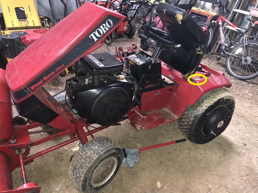

MNWheelHorse 5 #1 Posted March 29, 2020 Hey guys, New here to the forum and I just inherited a "new to me" Wheel Horse 416-H and was curious what the oil filter # and oil capacity is? It did not come with a manual, so a link to that would be helpful too. Here's a picture of her: Thanks! 3 Share this post Link to post Share on other sites

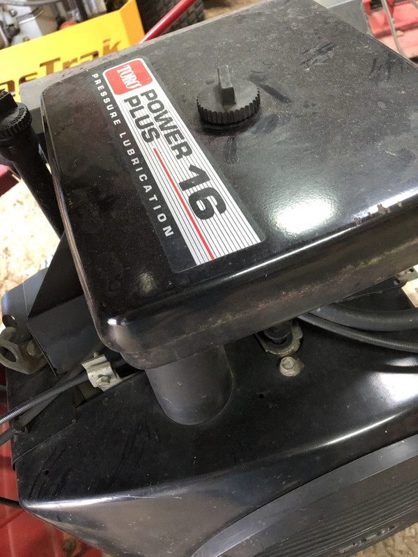

tom2p 2,393 #3 Posted March 29, 2020 (edited) welcome ! Onan 16 (P216) oil capacity - 1.8 qts oil filter - Toro NN10143 Onan 122-0800 Fleetguard LF-3339 Stens 120-517 Wix 51762 NAPA 1516 Edited March 29, 2020 by tom2p 2 2 Share this post Link to post Share on other sites

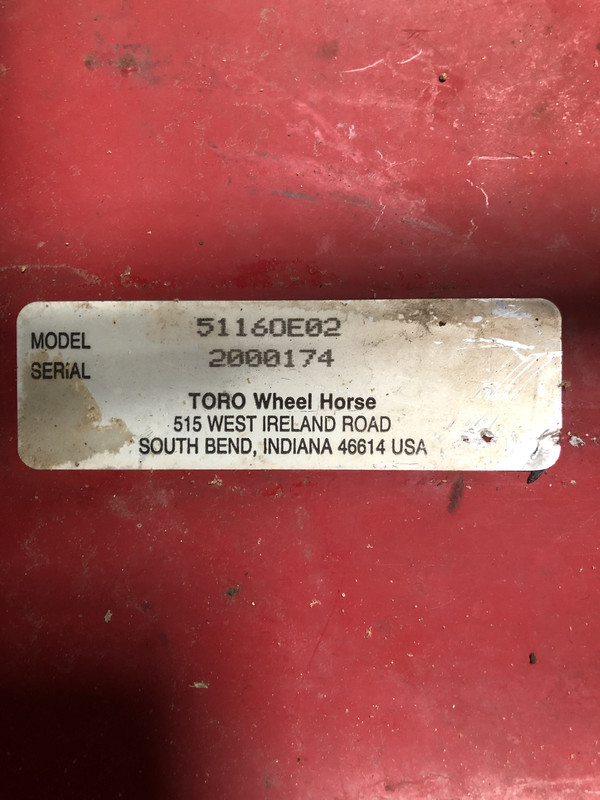

gwest_ca-(File Mod) 10,478 #4 Posted March 29, 2020 Let us know what is on this decal so we can link you to the correct manuals Garry Share this post Link to post Share on other sites

MNWheelHorse 5 #7 Posted March 29, 2020 Here is the model info: Share this post Link to post Share on other sites

gwest_ca-(File Mod) 10,478 #9 Posted March 29, 2020 Here is some info. It is in no particular order so look through them all. https://www.wheelhorseforum.com/search/?q=51-16oe02&quick=1&type=downloads_file Garry Share this post Link to post Share on other sites

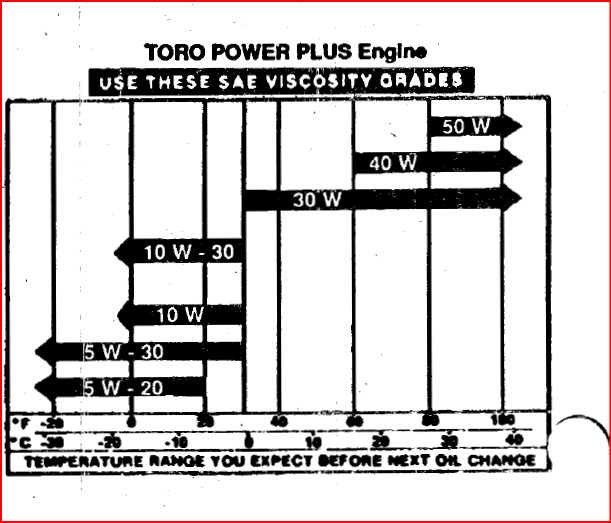

WHX?? 46,681 #15 Posted March 31, 2020 1 hour ago, MNWheelHorse said: Mobil 1 full synthetic 10w30 for the hydro change Good choice there. When refilling the hydro leave the filter a little loose to help in burping it. A drinking straw down next to the funnel works too. Idk about you choice of motor oil. All I can tell you is here is what the manual says. Share this post Link to post Share on other sites
tom2p 2,393 #16 Posted March 31, 2020 (edited) 4 hours ago, MNWheelHorse said: Interesting I will keep that in mind the next time I buy. I bought Mobil 1 full synthetic 10w30 for the hydro change and amsoil synthetic 0w40 four cycle for the motor. I’ve run this in my hustler fastrak and Honda rancher with good results. Is their issue with that? note Fram is not on my list of filters - and not by accident Mobil 1 would be good for both the hydro and engine ; I used Mobil 1 in my 416-H and 312-8 for decades with good results (1000 and 800 hours with no issues and still very little oil consumption ) any quality motor oil should be fine - provided it is changed at the proper intervals some motor oils will break down sooner than others - and issues could surface earlier if not changed at regular intervals just recently switched from Mobil 1 to Quaker State Ultimate Durability after I read some favorable reports - and price is lower also lost some faith in Mobil products because of their advertising and claims for Mobil 1 Annual / annual oil change intervals ( which is not smart ) - but I still have a gallon jug of Mobil 1 and plan to use it also read good reports on Amsoil so it appears the performance matches the hype - but never tried Amsoil due to lack of availability (in my area) Edited March 31, 2020 by tom2p Share this post Link to post Share on other sites
