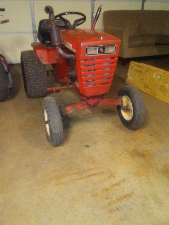

Sam Pasch 450 #52 Posted April 15, 2020 The headlight lens I ordered came today. It really completes the look of the tractor. 3 Share this post Link to post Share on other sites

WHX?? 58,057 #56 Posted April 17, 2020 On the head light lens Sam and I don't know about Lowell's but the originals were not fond of the heat a regular bulb puts out and made them become brittle and crack. Ok for occasional use but a few of us went to led bulbs for less heat. 2 Share this post Link to post Share on other sites
Sam Pasch 450 #57 Posted April 17, 2020 2 hours ago, WHX24 said: On the head light lens Sam and I don't know about Lowell's but the originals were not fond of the heat a regular bulb puts out and made them become brittle and crack. Ok for occasional use but a few of us went to led bulbs for less heat. I've been thinking about doing the same, not just for the heat but also put out a little more light. 1 Share this post Link to post Share on other sites
ebinmaine 80,608 #58 Posted April 17, 2020 3 minutes ago, Sam Pasch said: I've been thinking about doing the same, not just for the heat but also put out a little more light. Be sure to check the Color Temperature before you purchase them. Old-style incandescent bulbs have a color temperature number between 2500 and 3500 normally. They appear to be kind of yellow in comparison to a lot of the modern LED lights. Those LED lights will have a Color Temperature between 5000 and 6000. Part of the reason they appear to be Brighter is because they are Whiter. 1 Share this post Link to post Share on other sites

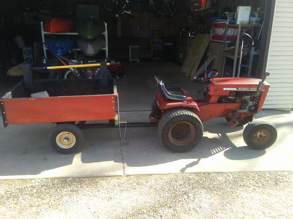

Sam Pasch 450 #60 Posted April 21, 2020 Hauling cinder blocks on a beautiful sunny day. 2 1 Share this post Link to post Share on other sites

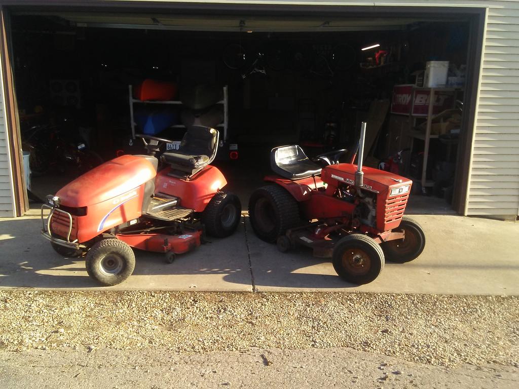

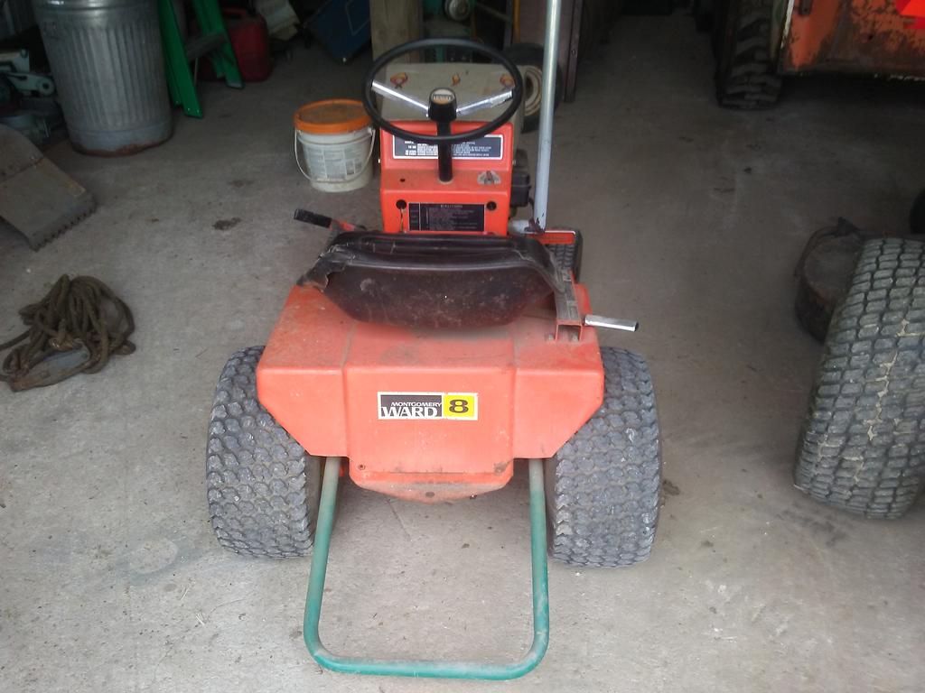

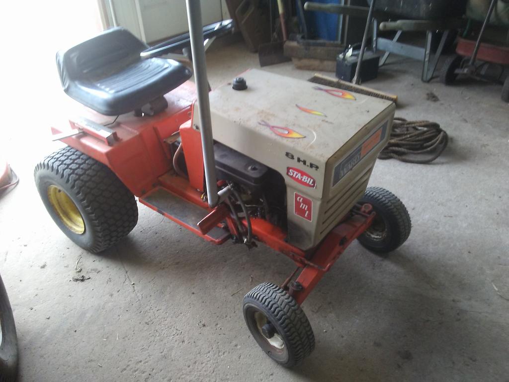

Sam Pasch 450 #66 Posted April 27, 2020 (edited) It was sunny this afternoon so I decided to take a picture of both my tractors together. Also, I had to get rid of the tractor I've had the longest. My hot rodded montgomery ward 8 series. luckily it went to a friend of mine. Edited April 27, 2020 by Sam Pasch 3 Share this post Link to post Share on other sites

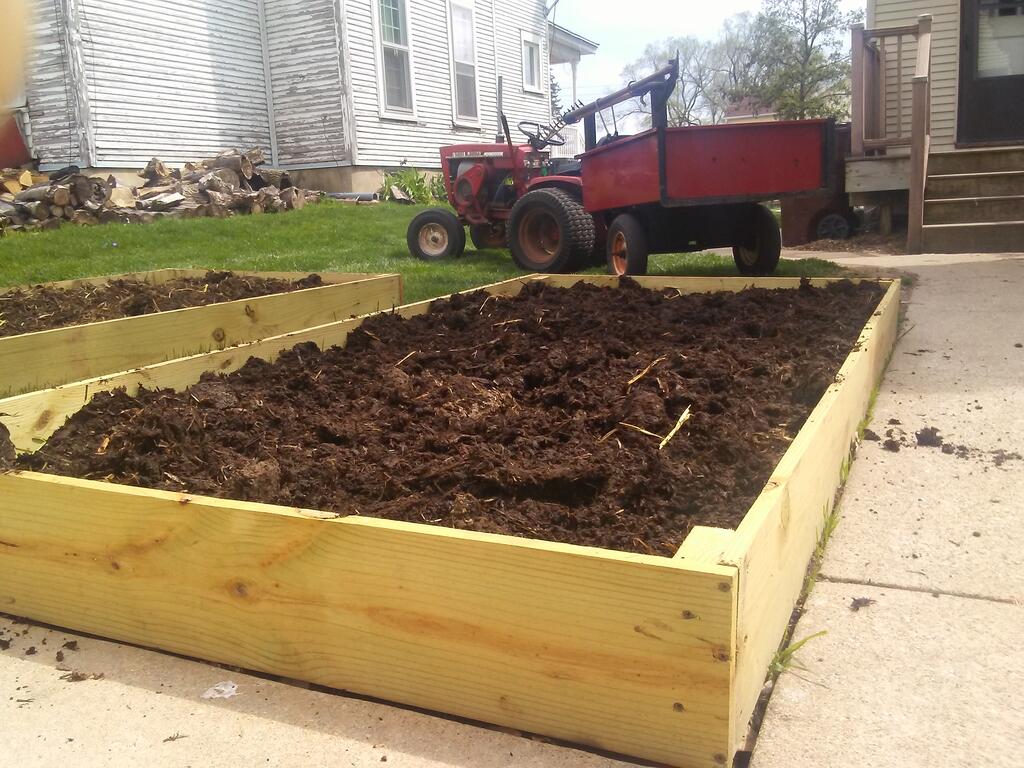

Sam Pasch 450 #67 Posted May 1, 2020 I took the 867 and dump cart to my grandparents house today to get some composted dirt for the raised beds. It barely noticed the load going up hills. These tractor truly are great workers. 1 1 Share this post Link to post Share on other sites

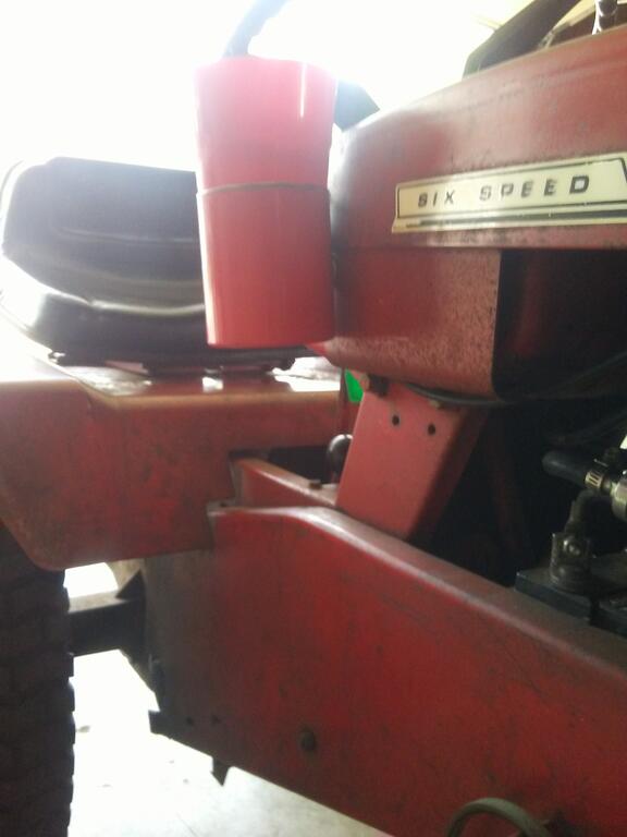

Sam Pasch 450 #71 Posted May 2, 2020 I made a cup holder for the 867 today out of the bottom of a fire extinguisher, some washers, and 5he bolt that holds the sides if the dashboard. 1 2 1 Share this post Link to post Share on other sites

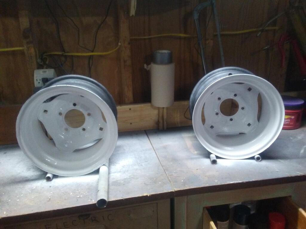

Sam Pasch 450 #73 Posted May 18, 2020 (edited) I got the turf savers stripped off of the rear rims and gave them a coat of paint. Now they are awaiting the new ags that I ordered. I hate waiting. Edited May 18, 2020 by Sam Pasch 1 Share this post Link to post Share on other sites

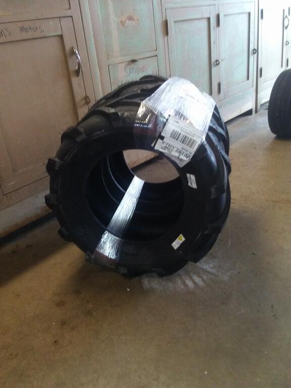

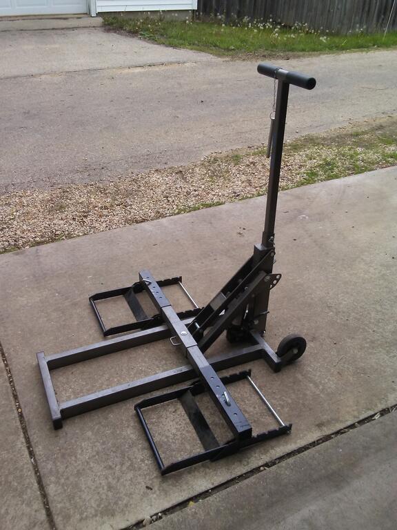

Sam Pasch 450 #74 Posted May 22, 2020 (edited) The new ags came the other day but didnt get time to post. I took them to the local tire and lube place to get them mounted today. I would have done it my self but they were 6 ply and a pain in the butt to install. I also acquired a tractor jack today. It should make servicing the deck easier. Edited May 22, 2020 by Sam Pasch 2 Share this post Link to post Share on other sites
lynnmor 9,037 #75 Posted May 23, 2020 3 hours ago, Sam Pasch said: The new ags came the other day but didnt get time to post. I took them to the local tire and lube place to get them mounted today. I would have done it my self but they were 6 ply and a pain in the butt to install. I also acquired a tractor jack today. It should make servicing the deck easier. I have that jack, real junk! Look at the bottom of the hydraulic jack and you will see that it isn't supported well, mine tore loose and bent to the floor. You might want to add a block under that to prevent failure. 1 Share this post Link to post Share on other sites
