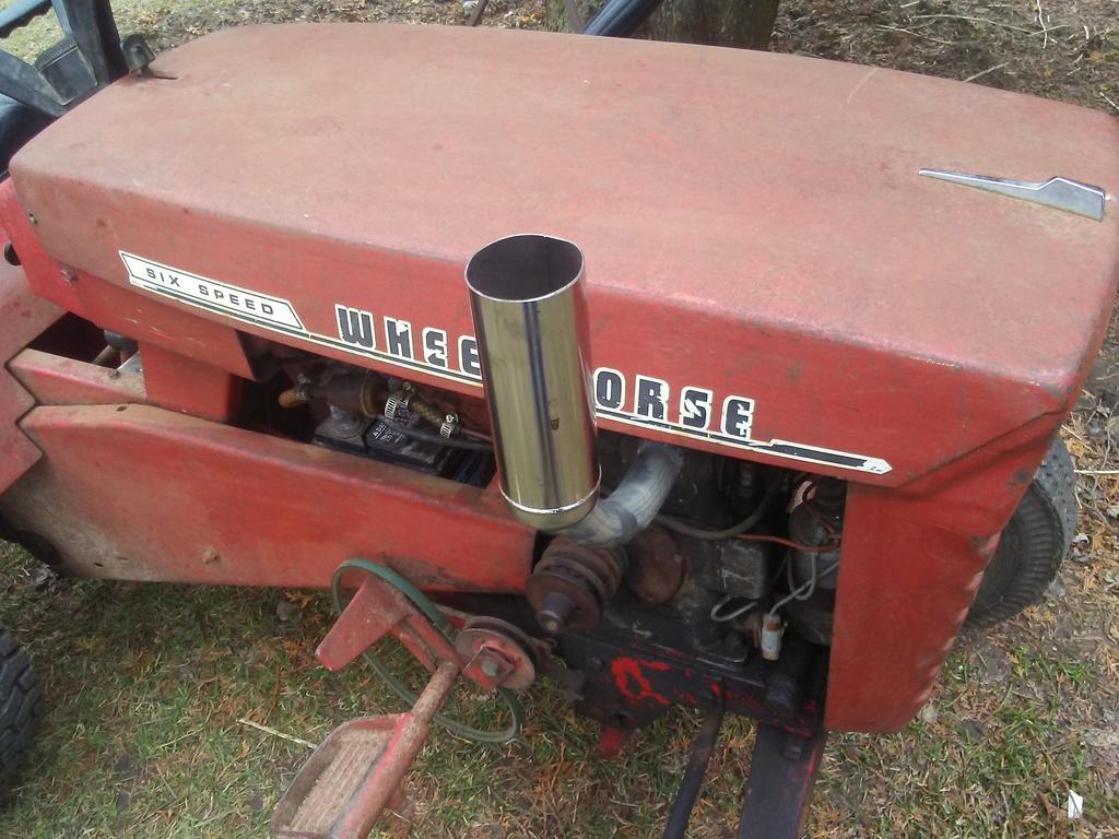

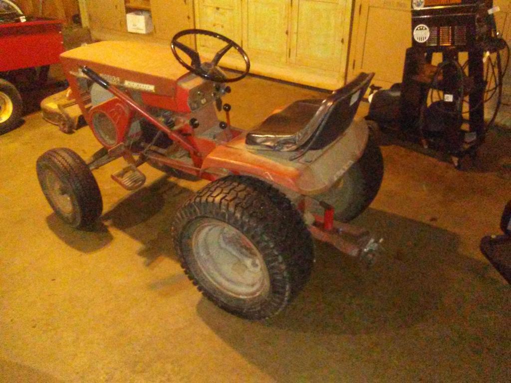

Sam Pasch 450 #1 Posted March 28, 2020 As long as I remember there has been a well rusted (or as some people like to call it "patina") 867 wheel horse sitting in my grandparent's barn. I loved that thing, and I always promised myself that I would own it one day. Well now, 15 years later, it's sitting in my garage. The best part is, it was free and it runs perfect. I drove it all the way to my house, which is actually only about a 1/2 mile from my grandparent's house, but it felt like a very long time. The first thing I did was put a stack on it. It just felt right that it should have one. Today was a very rainy day, but that doesn't get in the way of having some fun on my horse! I decided to take the 867 for a rip around the block. My neighbors probably hate me because it so loud with its stack, but I don't care. I own my dream tractor. 18 6 1 2 Share this post Link to post Share on other sites

The Tuul Crib 7,354 #4 Posted March 28, 2020 That my friend is a wonderful story and great tractor! Looks like a little clean up as well as a good tune up and you'll be good to go! Keep us posted on your progress! TO 3 Share this post Link to post Share on other sites

ZXT 2,402 #6 Posted March 29, 2020 Nice tractor, but that stack looks like it would be deafening and would definitely catch a ton of rain water. I would personally put a Nelson style muffler on it. The quieter the better. 3 2 Share this post Link to post Share on other sites
Sparky-(Admin) 26,693 #7 Posted March 29, 2020 Nice tractor! I’m a fan of stacks but not the noise of an open exhaust, mine still “muffles”. 10 1 Share this post Link to post Share on other sites
Sam Pasch 450 #8 Posted March 29, 2020 22 minutes ago, ZXT said: Nice tractor, but that stack looks like it would be deafening and would definitely catch a ton of rain water. I would personally put a Nelson style muffler on it. The quieter the better. I put a can over it if its sitting outside, but I agree I'll probably put a muffler on it. 2 1 Share this post Link to post Share on other sites
ZXT 2,402 #9 Posted March 29, 2020 4 minutes ago, Sam Pasch said: I put a can over it if its sitting outside, but I agree I'll probably put a muffler on it. I'd put a stack with a muffler, and pipe that you can put a flapper on. Should work pretty good to keep the water out! 4 Share this post Link to post Share on other sites

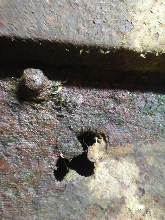

Sam Pasch 450 #11 Posted March 29, 2020 (edited) I started pulling the deck apart to restore it. Some of the bolts are rounded off and there is a rot hole in the back section. Edited March 29, 2020 by Sam Pasch 2 Share this post Link to post Share on other sites
ZXT 2,402 #12 Posted March 29, 2020 (edited) 4 minutes ago, Sam Pasch said: I started pulling the deck apart to restore it. Some of the bolts are rounded off and there is a rot hole in the back section. Do you own a welder or a torch? Holes can be fixed pretty easily with a welder, and rounded off rusty bolts can be removed with the heat wrench. Vise grips are good at securing rounded off bolts as well, but it looks like your bolts are a little past that! Edited March 29, 2020 by ZXT 3 Share this post Link to post Share on other sites
Sam Pasch 450 #13 Posted March 29, 2020 I can fix the hole pretty easy, but I dont have a torch. I might end up having to grind the bolts off. 1 Share this post Link to post Share on other sites
oliver2-44 11,824 #14 Posted March 29, 2020 Great story, always nike to keep a horse in the family. If you have a 55 gallon plastic barrel and a battery charger you can set up an electrolisis tank. It's a great way to remove rust and old paint down to bare metal. Google electrolisis tank or E-tank for instructions, quite simple. 3 Share this post Link to post Share on other sites

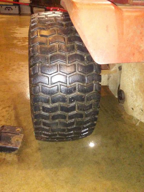

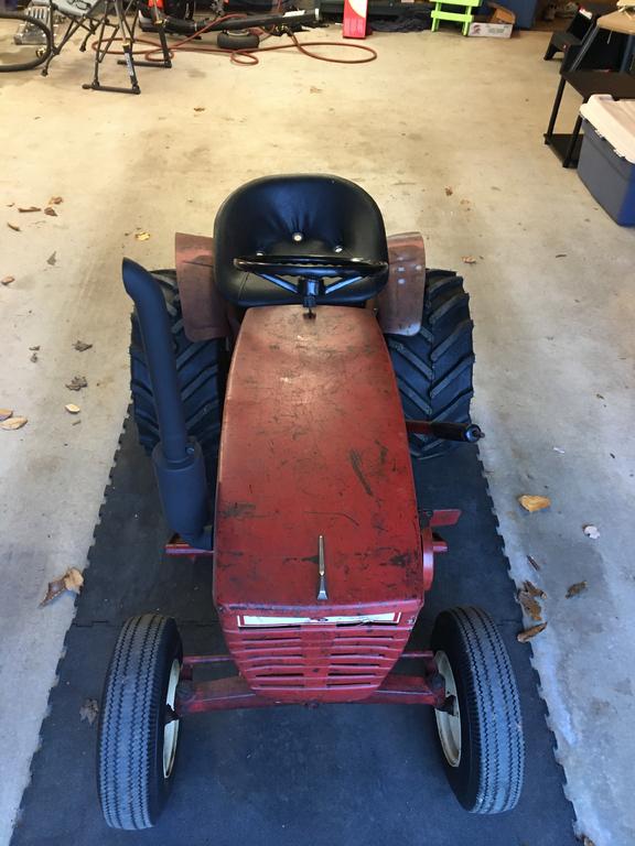

Sam Pasch 450 #15 Posted March 29, 2020 I think some ag tires in the back would improve the look. 5 Share this post Link to post Share on other sites

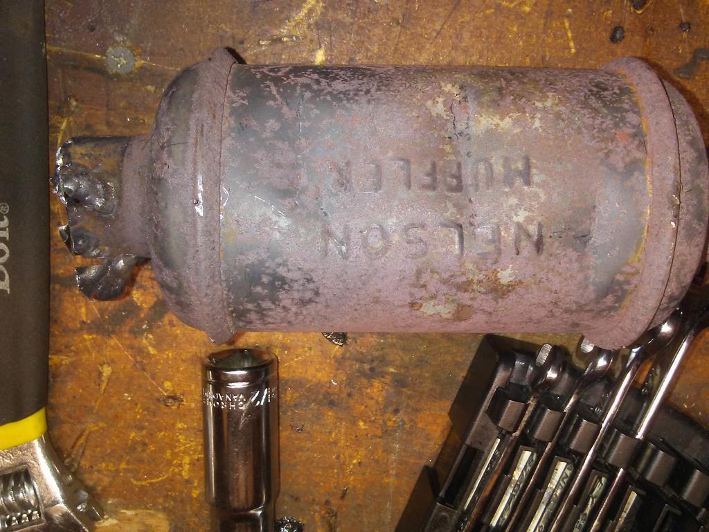

Sam Pasch 450 #16 Posted March 29, 2020 Look what I found in my stash. 8 Share this post Link to post Share on other sites

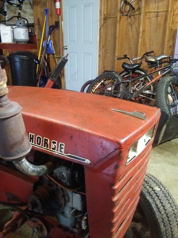

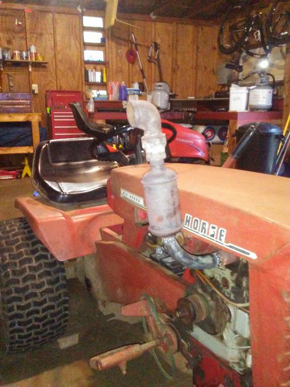

Sam Pasch 450 #20 Posted March 29, 2020 I got a muffler now. Much quieter and the neighbors should appreciate it. 4 1 Share this post Link to post Share on other sites
