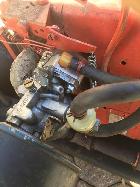

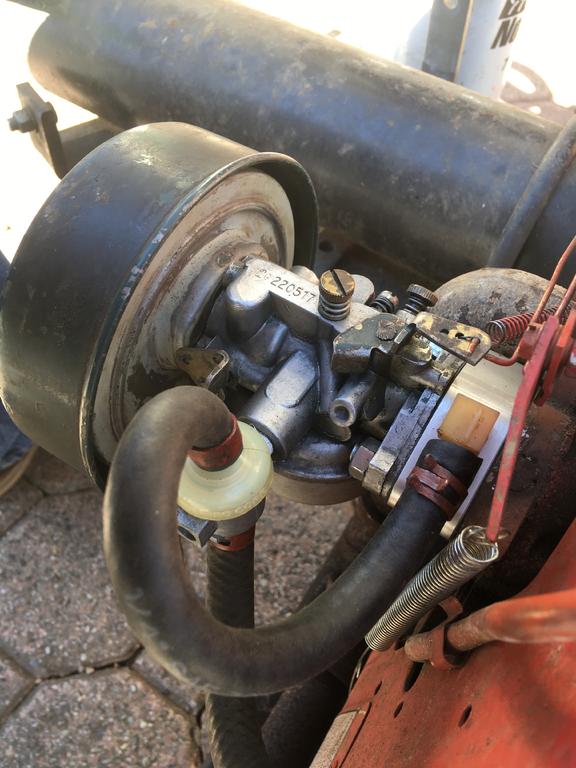

formariz 12,381 #1 Posted March 27, 2020 Here is the completed conversion including fuel pump. This thing never ran so well. 6 Share this post Link to post Share on other sites

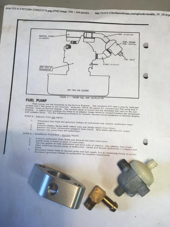

stevasaurus 23,857 #2 Posted March 27, 2020 I like that adapter...did you make that?? Share this post Link to post Share on other sites
formariz 12,381 #3 Posted March 27, 2020 2 hours ago, stevasaurus said: I like that adapter...did you make that?? No I had a machinist friend make me several so I can use these little fuel pumps. 1 Share this post Link to post Share on other sites
953 nut 69,578 #4 Posted March 27, 2020 cool little vacuum fuel pump, don't think I have ever seen one like it. Share this post Link to post Share on other sites
formariz 12,381 #5 Posted March 28, 2020 1 hour ago, 953 nut said: cool little vacuum fuel pump, don't think I have ever seen one like it. They show up once in a while. They are Walbros. They are pretty efficient on small gravity fed engines. They are a little pricey though and useless if you don't have also the adapter. 3 Share this post Link to post Share on other sites
