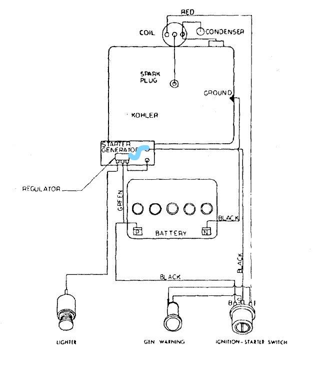

Tractor boy 239 #1 Posted March 26, 2020 Started working on the wiring on my 1056. Any ideas where i can find the wiring diagram? I can’t seem to find one. Thanks. Share this post Link to post Share on other sites
ebinmaine 79,513 #2 Posted March 26, 2020 You should have a regular battery ignition with points and a starter / generator. If that's the case, check the third diagram down. 1 Share this post Link to post Share on other sites
gwest_ca-(File Mod) 12,323 #3 Posted March 26, 2020 Garry 1 Share this post Link to post Share on other sites
Tractor boy 239 #4 Posted March 26, 2020 My tractor doesn’t have a soloind? Positive cable goes from the battery to the key switch Share this post Link to post Share on other sites
pfrederi 20,827 #5 Posted March 26, 2020 (edited) Pretty simple wiring system. You do NOT have a solenoid. Note the blue line in the picture. There is a wire that doesn't show up on the WH diagrams as it is a Kohler installation. There is a terminal on the bottom of your regulator and a wire runs from it to the "A" terminal on the generator. Edit the wires from battery to switch and switch to generator "A" terminal should be 6 ga or larger. rest can be 14. Edited March 26, 2020 by pfrederi 2 Share this post Link to post Share on other sites
Tractor boy 239 #6 Posted March 26, 2020 So the green would be a negative correct?along with the black wire coming off the starter Share this post Link to post Share on other sites
pfrederi 20,827 #7 Posted March 26, 2020 Green goes from the battery + terminal to the "BAT" terminal on your regulator Share this post Link to post Share on other sites
Tractor boy 239 #8 Posted March 26, 2020 I’m a idiot. Regulator is the box ontop of the starter? Share this post Link to post Share on other sites
pfrederi 20,827 #9 Posted March 26, 2020 (edited) The regulator has 4 terminals. 3 on the top L BAT F and one on the bottom A or sometimes GEN Genny Has two terminal one usually stamped with and A and thee other is F Field/. Edited March 26, 2020 by pfrederi Share this post Link to post Share on other sites
pfrederi 20,827 #10 Posted March 26, 2020 Yes the regulator is the box on top of the Generator Share this post Link to post Share on other sites
953 nut 67,240 #11 Posted March 26, 2020 This diagram is very much like your wiring, it was done to allow people to see the relationship of different electrical components to one another. You don't have lights on a 1056 but the cigarette lighter will be connected to the "L" terminal. 2 Share this post Link to post Share on other sites

Tractor boy 239 #13 Posted March 26, 2020 41 minutes ago, pfrederi said: Pretty simple wiring system. You do NOT have a solenoid. Note the blue line in the picture. There is a wire that doesn't show up on the WH diagrams as it is a Kohler installation. There is a terminal on the bottom of your regulator and a wire runs from it to the "A" terminal on the generator. Edit the wires from battery to switch and switch to generator "A" terminal should be 6 ga or larger. rest can be 14. Do you have a clearer picture of the key switch? Share this post Link to post Share on other sites

pfrederi 20,827 #17 Posted March 26, 2020 B S and I only 3 terminals. B goes to Battery positive (heavy Wire) S goes to "A" terminal on the generator (heavy Wire) "I" Ign goes to coil. 1 1 Share this post Link to post Share on other sites
Tractor boy 239 #18 Posted March 26, 2020 5 minutes ago, pfrederi said: B S and I only 3 terminals. B goes to Battery positive (heavy Wire) S goes to "A" terminal on the generator (heavy Wire) "I" Ign goes to coil. A Being first? Like A B C? Share this post Link to post Share on other sites
pfrederi 20,827 #19 Posted March 26, 2020 (edited) A = armature on the generator and bottom of the regulator. B= Battery F = Field (one on the regulator one on the generator.) S Starter goes from switch to "A" on the generator. Edited March 26, 2020 by pfrederi Share this post Link to post Share on other sites
953 nut 67,240 #20 Posted March 26, 2020 Did you look at the drawing in post 11? Share this post Link to post Share on other sites

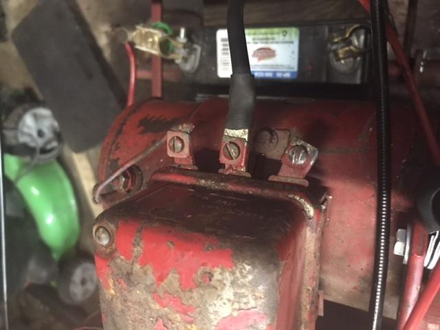

Tractor boy 239 #21 Posted March 26, 2020 1 minute ago, 953 nut said: Did you look at the drawing in post 11? Ya, question is what terminal am I pulling off of the regulator. Share this post Link to post Share on other sites
Tractor boy 239 #22 Posted March 26, 2020 The one all the way to the left is ground, middle or right is what I’m figuring out Share this post Link to post Share on other sites
953 nut 67,240 #23 Posted March 26, 2020 (edited) The body of the regulator is grounded. The one labeled "F" will connect to the S/G terminal labeled "F". The one marked "L" will go to the cigarette lighter. Edited March 26, 2020 by 953 nut fat finger Share this post Link to post Share on other sites

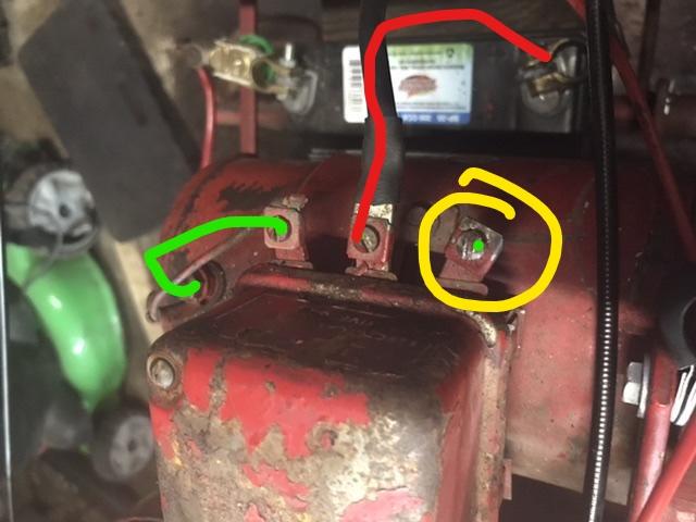

pfrederi 20,827 #24 Posted March 26, 2020 From your picture Last terminal is F it should go to F on the generator ( green marking) the center one is Bat (red) it should go to + terminal on your battery. the last one yellow is irrelevant unless you are a smoker. Share this post Link to post Share on other sites
