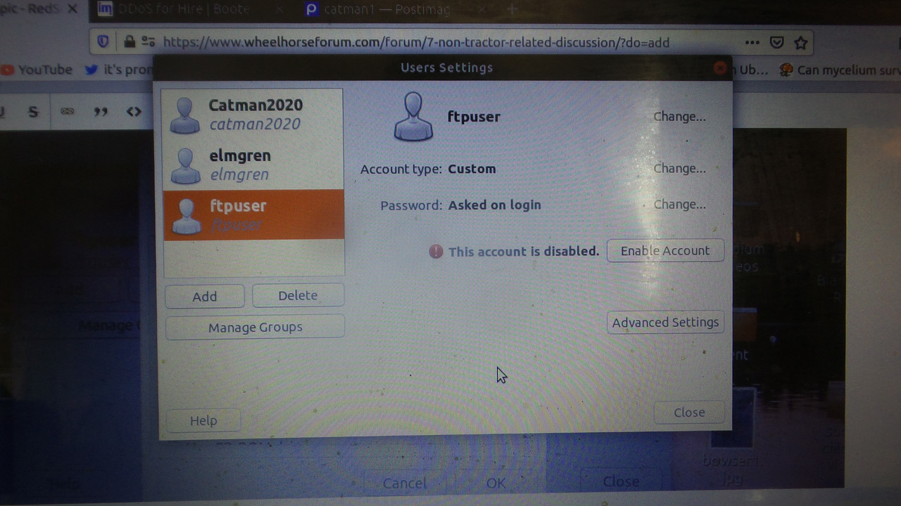

bc.gold 3,406 #1 Posted March 26, 2020 Turned on my laptop this morning to discover two new user accounts have been added, Catman2020 and the ftp account which is disabled for user elmgren. It would appear that my new friend left unattended would have used the FTP ports for his nefarious deed. since I do not have an FTP server as an added precaution set I'll close those ports in the firewall. For the time being I've changed the password on that new account, next on my list is to have my ISP flush our IP, once that's done a new number will be dynamically assigned. The new number breaks the chain for the purpose i believe my computer will be used as an addition to a botnet. DDoS for hire: Subleasing infected computers. To understand the business of DDoS-for-hire let’s take a look at what exactly the “product” is. In a nutshell, what these DDoS services are usually selling is access to DDoS botnets: networks of malware-infected computers, which are in turn being “subleased” to subscribers. Sadly, building such a botnet is simpler than you may think, considering the elaborate damage that can be caused a cluster of such “zombie” computers. For instance, a quick Internet search by any would-be botnet creator will pull up several popular botnet builder kits, often complete with a set of tips and instructions. Typically, such kits contain the bot payload and the CnC (command and control) files. Using these, aspiring bot masters (a.k.a. herders) can start distributing malware, infecting devices through a use of spam email, vulnerability scanners, brute force attacks and more. With enough computers, mobile phones and other Internet-connected devices “enslaved”, a new botnet is born—ready to do the dirty work of anyone willing to pay. 2 Share this post Link to post Share on other sites

nylyon-(Admin) 8,925 #3 Posted March 26, 2020 I would change your admin password as well and look into how they gained enough access to create 2 accounts. 1 Share this post Link to post Share on other sites
bc.gold 3,406 #4 Posted March 26, 2020 9 minutes ago, bottjernat1 said: I use to be a hacker. I have since grown up a bit. Got kicked out of school 3 days for it. I hacked the local schools computers many years ago. Anyways what i like to do now is hack the hackers and bombard them with crap emails and harass them while they are hacking. I overwhelmed a person a few months ago they stopped. I bet i actually over whelmed the device they were using to hack. The folks who do this bad voodoo need to get out of there moms basement and go get dam jobs! LOL I studied as Whitehat, lots of information on Astalavista on how to harden up your PC or server from abuse. 1 Share this post Link to post Share on other sites
bc.gold 3,406 #5 Posted March 26, 2020 5 minutes ago, nylyon said: I would change your admin password as well and look into how they gained enough access to create 2 accounts. Good idea, but I don't think the hacker will return anytime soon, he/she already added the bot script, found an open port, have my IP address to carry out the dirty deed. After installing a SSD along with a fresh Ubuntu install pretty much left it as a basic install, should have installed tripwire. How Tripwire works A Tripwire check compares the current filesystem state against a known baseline state and alerts on any changes it detects. The baseline and check behavior are controlled by a policy file, which specifies which files or directories to monitor, and which attributes to monitor on them, such as hashes, file permissions, and ownership. Share this post Link to post Share on other sites

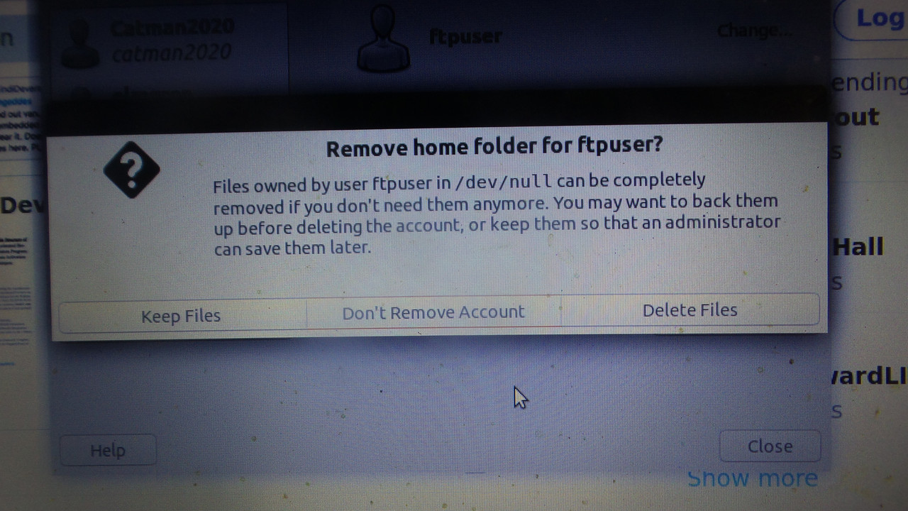

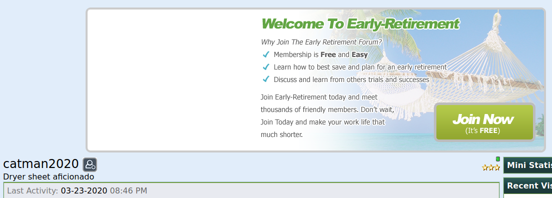

bc.gold 3,406 #9 Posted March 27, 2020 (edited) Not sure if this is my friend Catman2020, if it is the dude has sense of humor. Was going to delete the ftp account but a notification came up advising there are files in the folder. Think I'll mossy on over and see what he's hiding, I'll also get to see the creation dates when those files were uploaded into that folder. Edited March 27, 2020 by bcgold Share this post Link to post Share on other sites
bc.gold 3,406 #10 Posted March 27, 2020 I love Linux, no board room directors making decisions based on how many people are being compromised versus dollars to fix the problem - share holders come first. The new account was set up for mailing spam, the ftp account held the flies to be attached to the outgoing messages. Share this post Link to post Share on other sites
