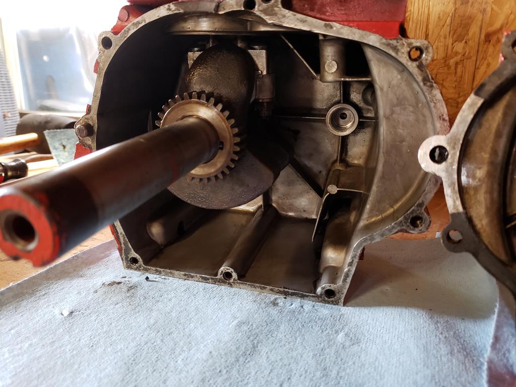

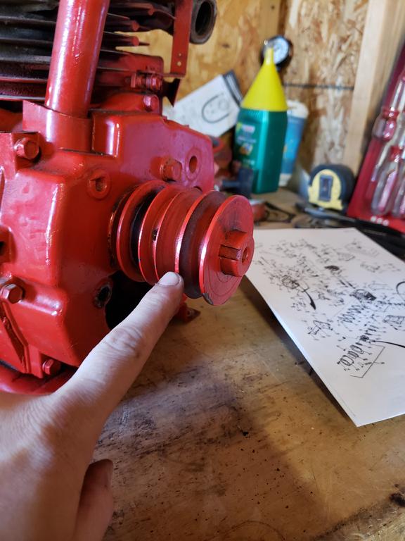

Also what's the best method for removing this piece?
pfrederi
Remove the set screws (make sure non were doubled) and a device like this
Clean the paint off the crankshaft first.
And your best tool yet, might just be patience.  Remember you want things to happen NOW but it took upwards of 50 years to get stuck.

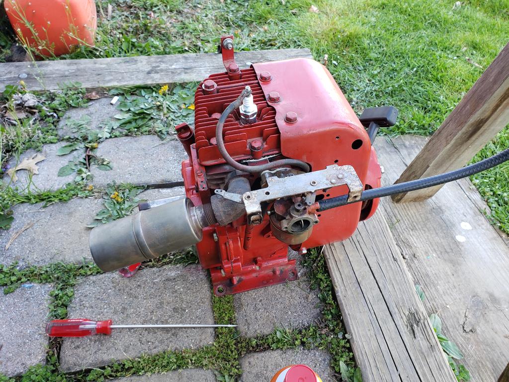

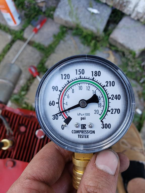

Didnt realise there were TWO pages now. I ended up getting it off with a 3 claw style puller for flywheels in cars. Didnt see the suggestions until today but it worked all the same. I took it all apart replaced the gaskets and got a new spark plug. Once I put it together did a compression test was around 65psi. Then I made a makeshift gas tank out of a milk jug and got the engine started with a little engine starter. It ran good and strong but quickly picked up RPMs before I started adjusting the carburetor. Once I touched the carburetor I couldn't really get it to start again even with starter fluid. Finally defeated I did another compression test and only got around 35/40(see pic below). Any tricks or tips?

After cleaning
Volleballogist

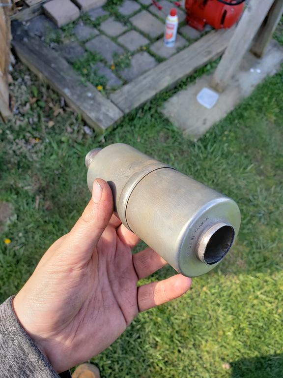

Vinegar did an amazing job in the muffler

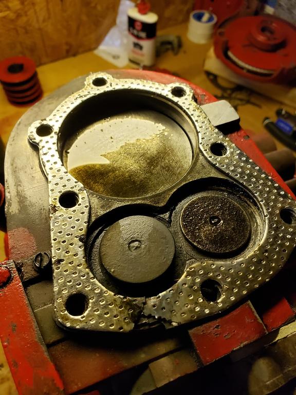

Found the culprit. Pretty bummed that a brand new gasket blew. Any clue why there is oil on top of the piston?
  • Sad 1
Oil control ring backwards?
Ring gaps lined up?

I didn't take out the cylinder to inspect it or the rings since the compression wasn't really an issue before I took it apart. I also did not mess with the oil control ring since that didnt seem to have anything wrong with it.

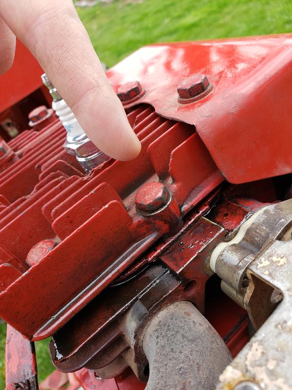

Used the old gasket since the new one blew on me. runs like a champ. Now another issue that has come up is that the one bolt that secures the head is stripped and not even able to be torqued. Some oil had been leaking from the head in this spot. I'm thinking about tapping out new threads and sizing up the bolt. Is that the right idea or should I go another avenue?
lynnmor
Usually the best repair is with a Heli-Coil.  If you have intersecting holes, there may be a problem with either a larger bolt or the Heli-Coil.
Volleballogist
I went out and bought a heli-coul to try. after getting about a centimeter down it looked like it was doing more damage than good. So I ended up just running a the bolt through and having a nut and washer on the other side for now until I get a tapping set.
oliver2-44
If /when you pull the head again it would be a good idea to sand the head flat using a piece of glass and wet/dry sand paper.   Also I like the head gaskets that have a solid (hollow)  "crush" ring on their inner diameter.

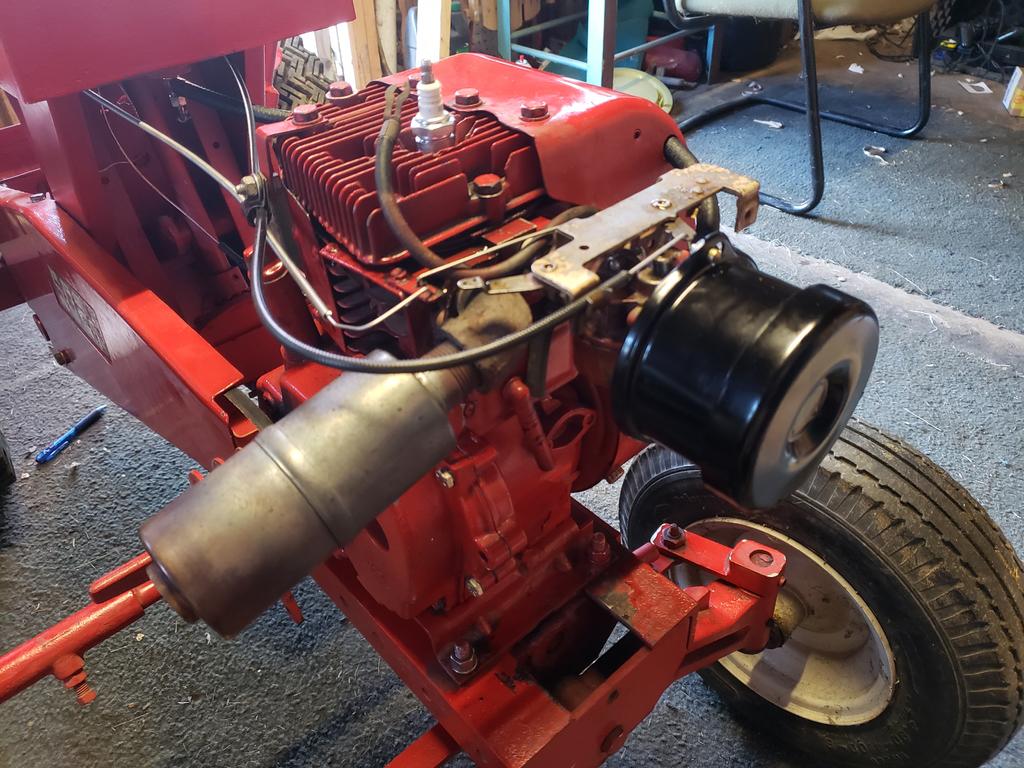

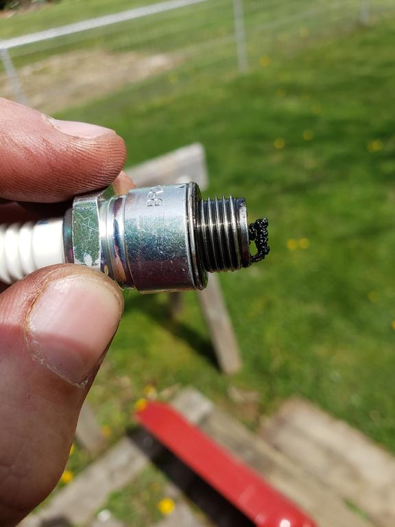

I installed a new air filter assembly and the throttle/choke cables. Cleaned out the gas tank and hooked up the fuel line. The engine runs great. I drove it around my yard and the transmission seems to be in good shape too. The only issues that I seem to have is the engine does have light white smoke that comes out of the muffler and when I shut the engine off the smoke comes out of the carb and carb tube. When I took the spark plug out it looked really dirty. The other issue is that my hood doesnt fit anymore with the air filter assembly although I think I could bend the frame a little.
