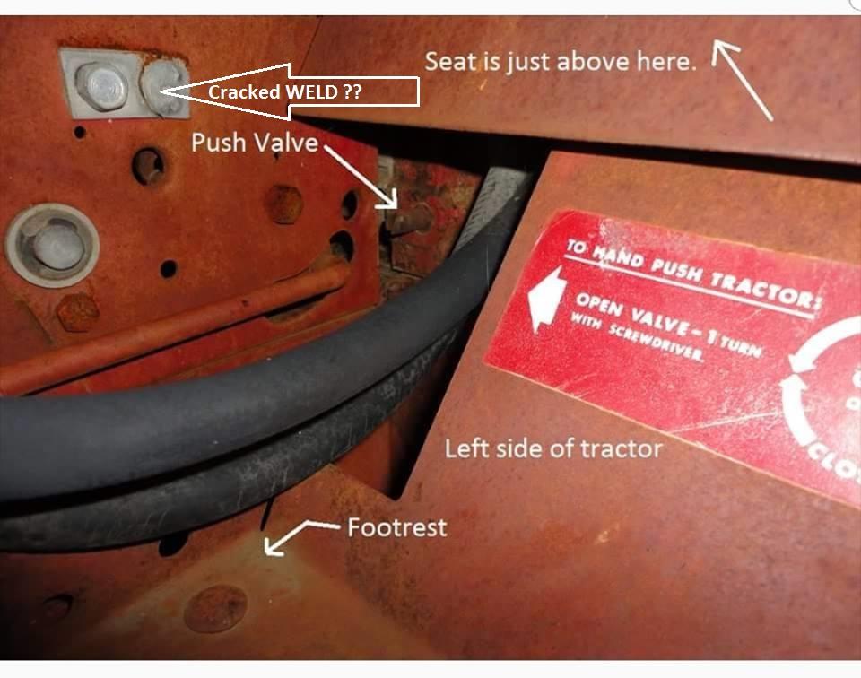

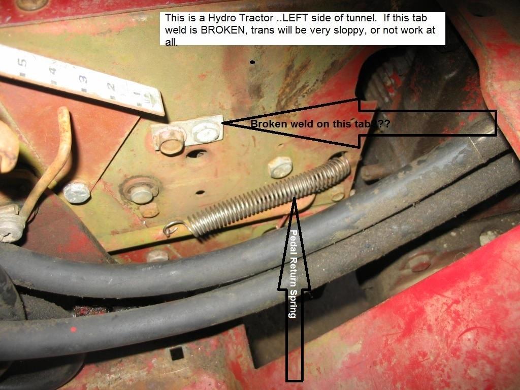

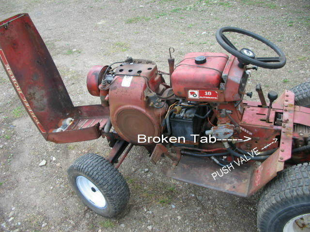

daveoman1966 3,839 #4 Posted March 25, 2020 I've used a tiller on my C-160 auto, but the C-160 with an 8-speed trans is better suited to maintain a constant slow speed. With the c-160 AUTO, there is often a speed control issue involving the BROKEN TAB on FRICTION SHAFT on the outside of the hoodstand. This shaft MUST be lockled down by this bolt, otherwise, the control mechanism will be free to FLOAT back and forth. So, check this out. If the weld is broken, it can be weld-repaired in place, without removing it from the hoodstand. 2 3 Share this post Link to post Share on other sites

ZXT 2,401 #8 Posted March 25, 2020 9 hours ago, daveoman1966 said: I've used a tiller on my C-160 auto, but the C-160 with an 8-speed trans is better suited to maintain a constant slow speed. With the c-160 AUTO, there is often a speed control issue involving the BROKEN TAB on FRICTION SHAFT on the outside of the hoodstand. This shaft MUST be lockled down by this bolt, otherwise, the control mechanism will be free to FLOAT back and forth. So, check this out. If the weld is broken, it can be weld-repaired in place, without removing it from the hoodstand. I actually came across one of your posts containing those pictures when researching. The tab is in tact and the bolt is tight. 9 hours ago, Cvans said: If it's any consolation I've tried different brands of hydro tractors with tillers and all were hard to control in firm soil. In broken soil they seem to work OK. Now that my tilling machines are standard transmissions it's just drop the tiller and forget about them until I turn around. No more tiller pushing the tractor around. This is pretty firm soil and having bamboo roots running across doesn’t help either. I might have to put together my one geared WH and use it for this.. 7 hours ago, TractorJunkie said: I figure your hydro runs okay when not tilling? I have used both manual and hydro to till and one thing that helps control the machine is weight. I use 100 lbs of wheel weight and put 50 lbs on the front. Makes a big difference. On the hydro you need to keep the RPM up so it works correctly. I prefer the hydro with a hand control. There are times I am even using reverse to go super slow. It can be tricky, mostly the tiller will push the machine. It is less noticeable when doing other work but only because I’m not having to move at snail speed. I might need weights. I’ve been keeping my eye out for a set. I’ve not thought of going in reverse.. I would think that the tractor would compact the dirt that you just tilled. 3 hours ago, WVHillbilly520H said: I have used my exclusively with my 520H and yes basically what @TractorJunkie posted above so this will be the first year with a manual (315-8) as far as the belt popping off my did to quite a bit till I procured a new one seems the original that came with it was to stiff (JMO) and would jump off in worked up soil. Also I had 120 lbs up front plus 150 in wheel weights. The belt I have is probably older than I am so I will get one ordered. Thanks guys! 2 Share this post Link to post Share on other sites
WVHillbilly520H 10,376 #9 Posted March 25, 2020 52 minutes ago, ZXT said: I actually came across one of your posts containing those pictures when researching. The tab is in tact and the bolt is tight. This is pretty firm soil and having bamboo roots running across doesn’t help either. I might have to put together my one geared WH and use it for this.. It is less noticeable when doing other work but only because I’m not having to move at snail speed. I might need weights. I’ve been keeping my eye out for a set. I’ve not thought of going in reverse.. I would think that the tractor would compact the dirt that you just tilled. The belt I have is probably older than I am so I will get one ordered. Thanks guys! Belt size is 1/2" x 141" or TORO 110265 2 1 Share this post Link to post Share on other sites

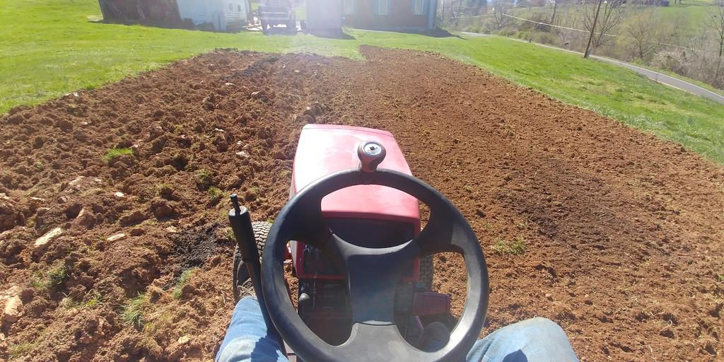

WVHillbilly520H 10,376 #12 Posted March 29, 2020 (edited) I tried out my tiller on the 315-8 for the first time today 1st gear low range it actually worked rather well in freshly turned sod vs the hydro a few years back I'm actually going to replow and till this plot again because of the grass but other than that I was rather impressed with the gear jammer. Edited March 29, 2020 by WVHillbilly520H 3 Share this post Link to post Share on other sites

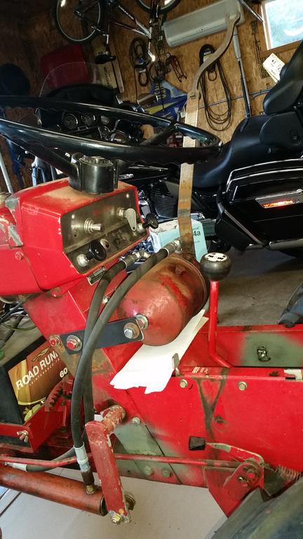

WHX?? 51,649 #16 Posted March 29, 2020 (edited) Oh yeah Billy.. thats huge..... go old skool and rig a HY on the plow tractor!... someday when we get you hooked on these '60s machines..... Need I show you pics o f Dan's set up.on his '68?!?! Edited March 29, 2020 by WHX24 1 1 Share this post Link to post Share on other sites

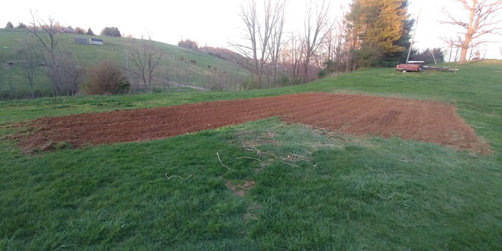

WVHillbilly520H 10,376 #18 Posted April 4, 2020 Replow and till... 2 1 Share this post Link to post Share on other sites

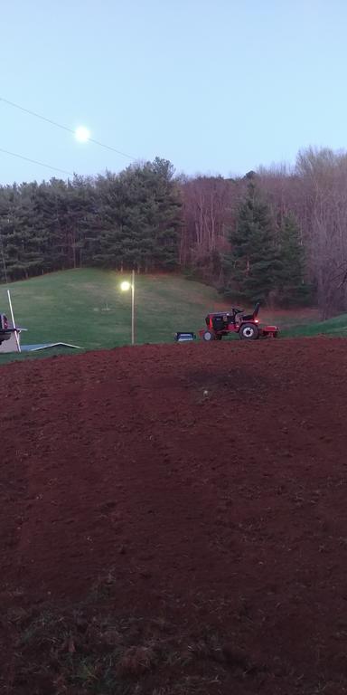

WVHillbilly520H 10,376 #20 Posted April 7, 2020 (edited) On 4/3/2020 at 10:55 PM, Razorback said: That is a beautiful sight to me! How about this 1? Edited April 7, 2020 by WVHillbilly520H 1 1 Share this post Link to post Share on other sites
tom2p 2,394 #21 Posted April 7, 2020 1 hour ago, WVHillbilly520H said: How about this 1? incredible 1 1 1 Share this post Link to post Share on other sites
Herder 2,355 #22 Posted April 7, 2020 Wow, nice work. And great soil too. Can't wait to see updates on the garden!! 1 1 Share this post Link to post Share on other sites
Herder 2,355 #23 Posted April 7, 2020 On 3/28/2020 at 9:58 PM, WHX24 said: Oh yeah Billy.. thats huge..... go old skool and rig a HY on the plow tractor!... someday when we get you hooked on these '60s machines..... Need I show you pics o f Dan's set up.on his '68?!?! Yes, please do. 1 Share this post Link to post Share on other sites
Razorback 1,112 #24 Posted April 8, 2020 10 hours ago, WVHillbilly520H said: How about this 1? Beautiful! Don't you just LOVE the smell of tilled dirt??? 1 Share this post Link to post Share on other sites
