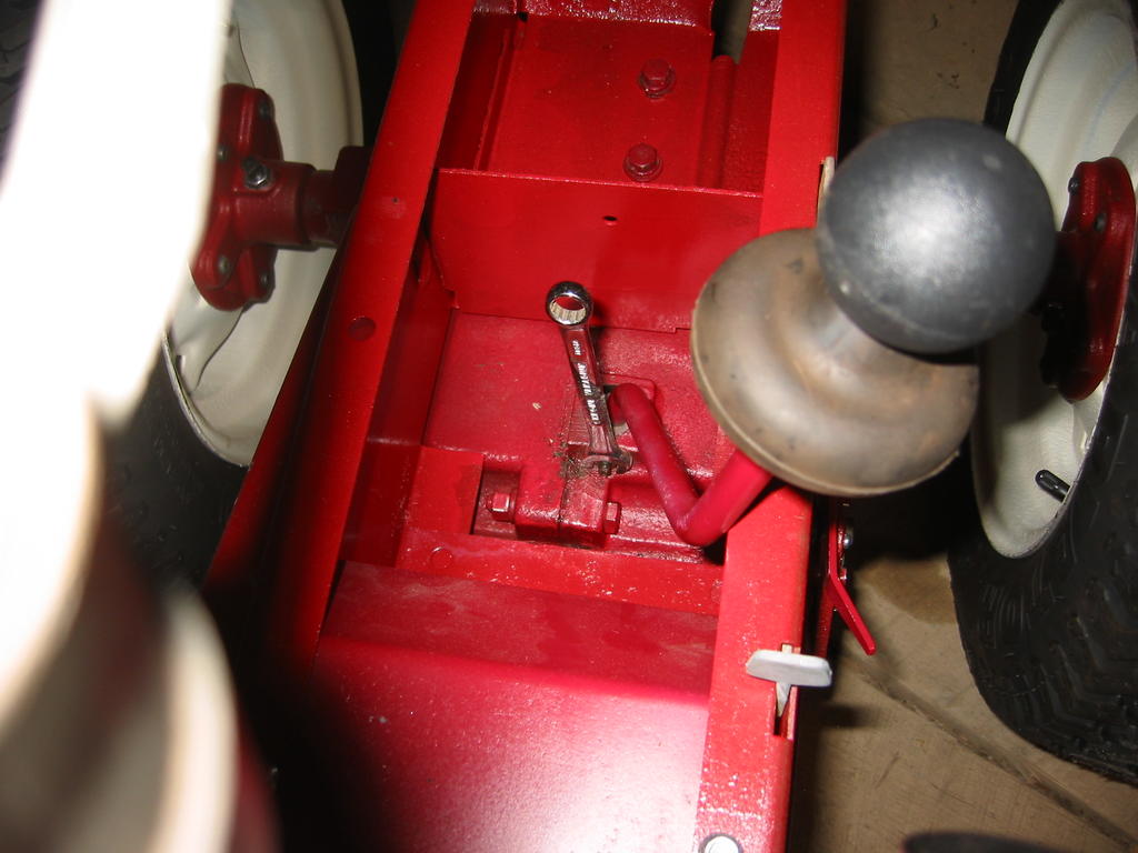

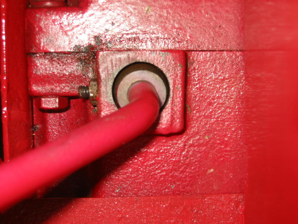

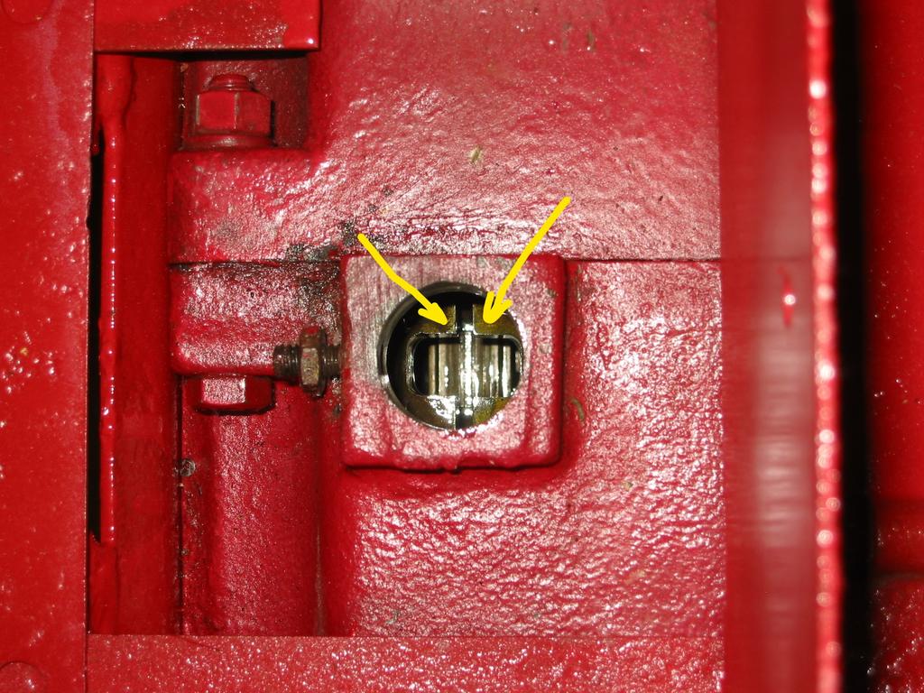

pfrederi 19,943 #4 Posted March 24, 2020 You could pull the gear shift lever and make sure the shift forks are aligned as in the last picture if not use a big screw driver to align them. also try turning the input pulley with tanny in neutral 5 Share this post Link to post Share on other sites
