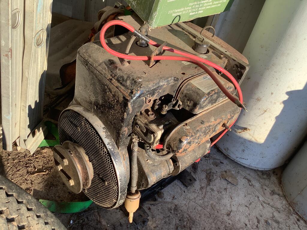

Pullstart 71,098 #109 Posted January 21, 2022 So, the FEL is long gone off too Scoop, I’ve not figured out the culprit of all the oil, but I did just see in a corner an old Briggs model 253417 11 hp engine. This came from 2019 Portage, WI auction. It was in a Craftsman(?) mower and ran off a hand crafted (easy term for cobbled) ammonia or spirits can with a copper line brazed into it turned gas can. If @WHX?? and @Achto recall, it was a $25 or so purchase (maybe only a couple bucks!) and with a battery it fired right off running in the fuel that was in it and I drove it around the campsite and it didn’t even smoke enough to fog for skeeter eagles. It even has a flywheel side pulley on it. This’s gots’s me thinking we have a culprit for a C-111Special hydraulic pump machine… 1 Share this post Link to post Share on other sites
Pullstart 71,098 #110 Posted January 21, 2022 On 3/25/2020 at 9:30 PM, Pullstart said: I’m not giving up so easy! March of ‘20. Maybe I did give up… 2 Share this post Link to post Share on other sites
Achto 32,347 #111 Posted January 21, 2022 If I recall correctly that engine ran fairly decent. 1 1 Share this post Link to post Share on other sites

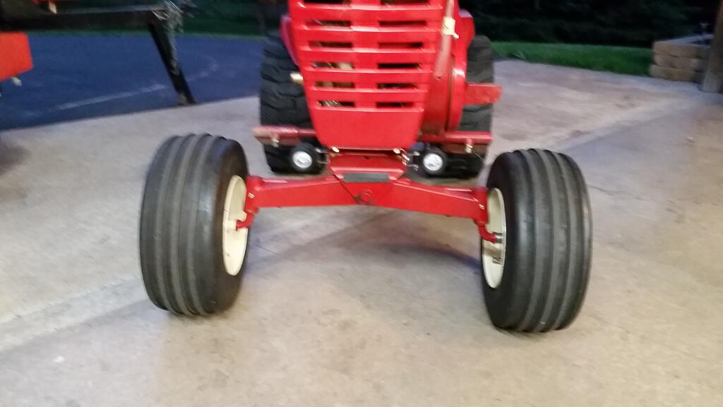

WHX?? 57,799 #112 Posted January 21, 2022 (edited) Was that this tractor Kev? 2019 show if so she died for a good cause... the front rims are on this tractor now! Edited January 21, 2022 by WHX?? 1 1 1 Share this post Link to post Share on other sites
Pullstart 71,098 #113 Posted January 21, 2022 Yeah buddy! That’s the one! I recall I left the majority of the carcass next to the dumpster I actually maxed out Norman’s deck over capacity that trip! 1 Share this post Link to post Share on other sites
