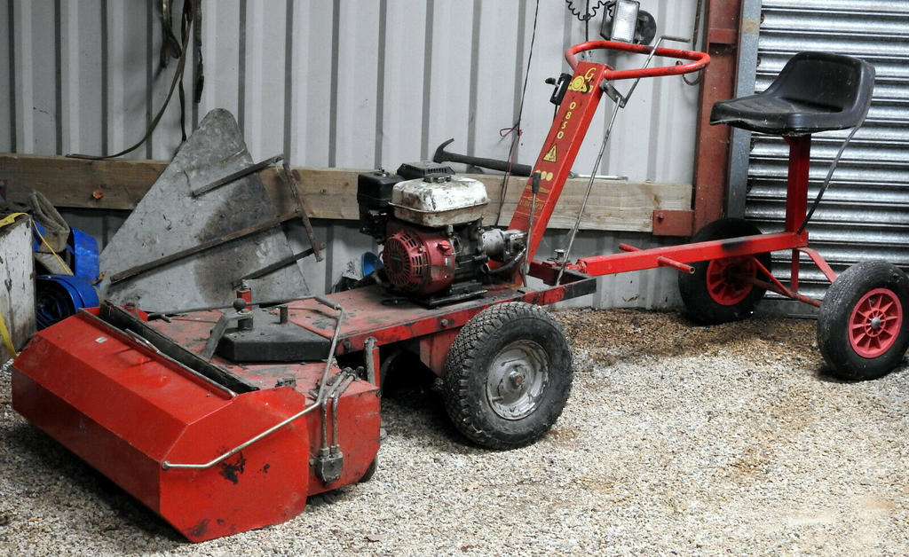

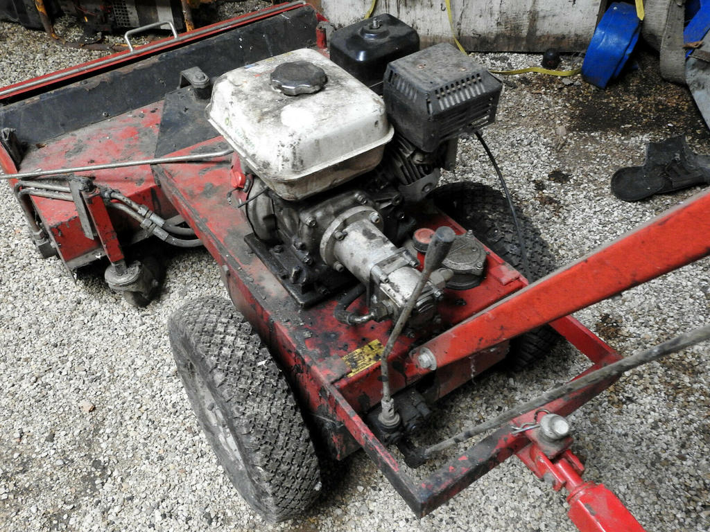

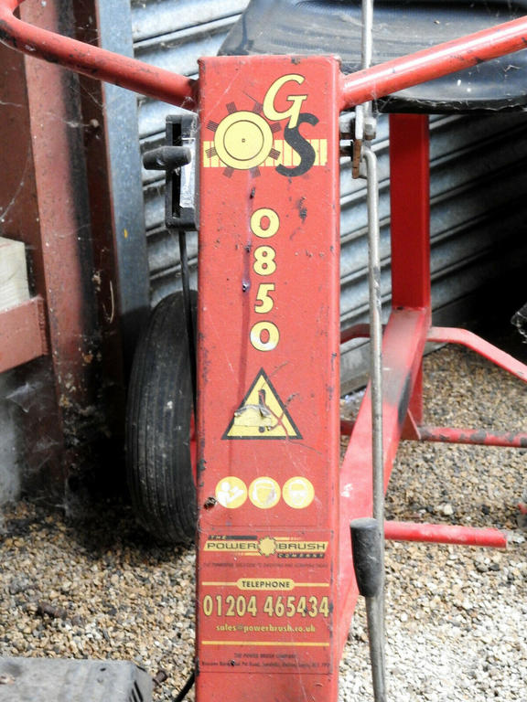

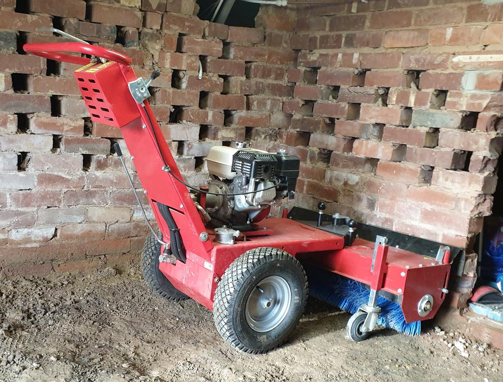

Dan.gerous 2,696 #17 Posted April 13, 2020 Found this odd looking sweeper online, they want too much money for it to be a viable donor but the idea is good and I wouldnt mind getting that hydraulic pump. 2 Share this post Link to post Share on other sites
wallfish 20,679 #18 Posted April 13, 2020 It's the hydraulics which make it expensive. That is an interesting machine, a high end walk behind with a sulkie to ride on. Though it seems they went cheap on the sulkie wheels. How about something like this to convert a snow blower? The rotation direction in the blower can be changed by rerouting the drive chain. It will need to be geared down through some sprockets and or pulleys to slow the rotation speed. https://www.zoro.com/nobles-cylindrical-brush-32-in-machine-374042/i/G1921796/?recommended=true Or, back to your original idea of converting a tiller and using these to replace the tines then some fab work to move the tiller to the front of the tractor https://www.zoro.com/sweepex-rotary-broom-replacement-brush-set-32-smp-320/i/G3489643/?recommended=true 2 Share this post Link to post Share on other sites
Mickwhitt 5,259 #19 Posted April 13, 2020 I have the same sweeper at here in Yorkshire. It's a beast and does a great job. Also takes a plow blade in place of the sweeper head. I was thinking of mounting it on the WH but I dont really need it as the walk behind is no problem. It is dusty when sweeping dry and no collector box on, but otherwise its amazing. One went through our local auction for 350 but I didnt bid on it, wish I had now. Mick 1 Share this post Link to post Share on other sites
Dan.gerous 2,696 #20 Posted April 13, 2020 2 hours ago, Mickwhitt said: I have the same sweeper at here in Yorkshire. It's a beast and does a great job. Also takes a plow blade in place of the sweeper head. I was thinking of mounting it on the WH but I dont really need it as the walk behind is no problem. It is dusty when sweeping dry and no collector box on, but otherwise its amazing. One went through our local auction for 350 but I didnt bid on it, wish I had now. Mick I hadnt noticed that it was actually a walk behind - but its obvious now. Its on Ebay for £800, I can get a bigger on with a three point linkage for the tractor at that price but really want to use the wheelhorse Share this post Link to post Share on other sites

Mickwhitt 5,259 #23 Posted April 13, 2020 The GS one you saw is very powerful, the brushes are available in different filament thicknesses for different cleaning. If you Google the firm contact them as the owner is a nice guy who may be able to help you out. Mick Share this post Link to post Share on other sites
