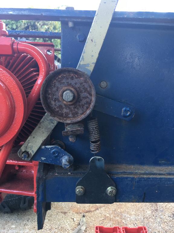

19richie66 17,937 #26 Posted April 3, 2020 I can’t get you a width but I do believe it is 1” wide. Share this post Link to post Share on other sites
953 nut 69,675 #27 Posted April 3, 2020 Measured mine and it is 5/8" + about a 1/64th" or less. The idler on the mule drive is an inch wide, bet someone swapped it out. 1 Share this post Link to post Share on other sites
Sailman 1,307 #28 Posted April 4, 2020 Yep. My guess too. There is just not enough room for a 1 inch pulley between tractor frame/ mounting hardware and fender. Will take it off and get measurements and see what can find online for replacement. Thanks! Share this post Link to post Share on other sites
