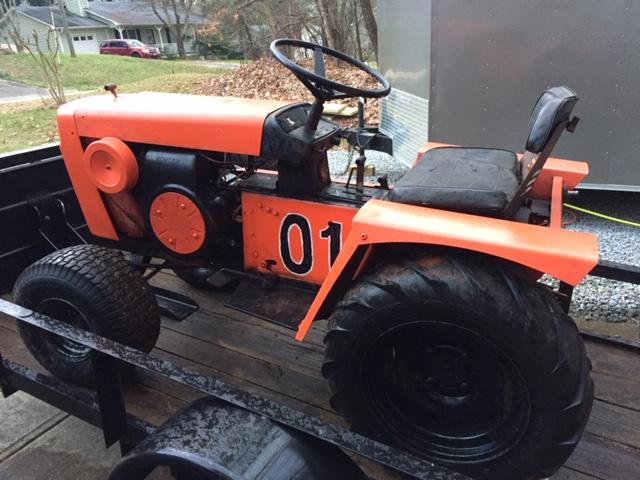

Sailman 1,307 #1 Posted March 22, 2020 Just became owner of a 1971 GT 14. I grew up on a farm in Iowa with lots of tractor experience. Now a sailing captain with some experience on diesel engines. Love the old wheel horses and ran across this GT 14. Tractor appears to be original but has some issue. Posting the picture....sure it will get some chuckles...or groans....previous OP must have been a Dukes of Hazzard fan! Would appreciate a shout out from GT 14 experts as I have some issues to deal with. Looking for more of a work tractor at this point.... Thanks! 8 3 Share this post Link to post Share on other sites

Ed Kennell 46,996 #6 Posted March 22, 2020 I don't have any GT's, but ignoring the General Lee paint, she looks in great shape. What problems are you looking to address? Oh, to the Captain. 1 Share this post Link to post Share on other sites
953 nut 68,522 #7 Posted March 22, 2020 I don't think the GT-14 is suitable for jumping over a police car like the General Lee. 1 1 5 Share this post Link to post Share on other sites
Sailman 1,307 #8 Posted March 22, 2020 Dont think I will be jumping over anything for a while...:( Having an issue with the Transmission Ed. asking for advice over on the transmissions forum and the prognosis is not good. Think the rebuild option is outside my wheel house.... Share this post Link to post Share on other sites

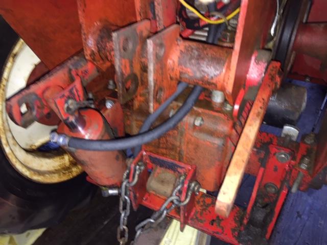

Sailman 1,307 #21 Posted April 3, 2020 Whoo Hoo the GT 14 runs great! Plenty of pull and smooth operating transmission. Brings back old memories.... Only issue is idler pulley on main belt seems to be hitting on the rear fender. Makes a racket with belt guard on. I measured the spool and it is 1 inch from rim to rim. Seems too big. Belt is 5/8 and does not look like pulley can be moved any closer. Is this the wrong size pulley? Any ideas? Thanks! (posted over in transmission issue forum but wanted to share with all...) 20200402_164732.mp4 3 Share this post Link to post Share on other sites
Cvans 1,009 #22 Posted April 3, 2020 Congratulations on a successful repair. Share this post Link to post Share on other sites
19richie66 17,932 #24 Posted April 3, 2020 Idler pulley may be hitting on the inner belt guard because the pivot is worn out or the spring is not putting enough tension on the rod to hold it into the belt Share this post Link to post Share on other sites
Sailman 1,307 #25 Posted April 3, 2020 Is the 1 inch idler pulley correct? Its actually hitting on the fender. Have pulled fender out as far as possible and the idler pulley arm is in as tight to the tractor as it can be. Looks like the pulley is too wide. What is the width on other GT 14 idler pully? GT 14 owners? I do want to replace the spring to put better tension on the pulley. Any suggestion where to purchase the spring? Share this post Link to post Share on other sites
