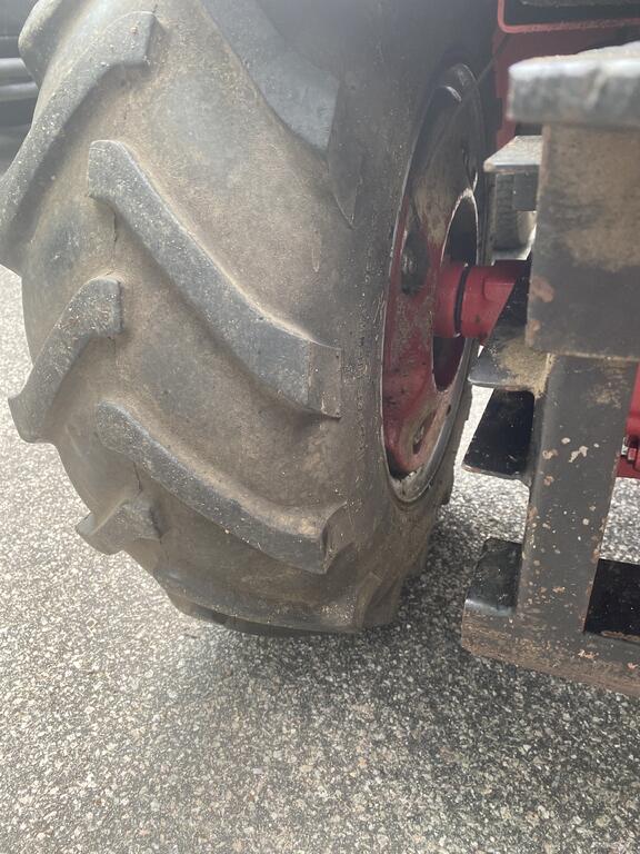

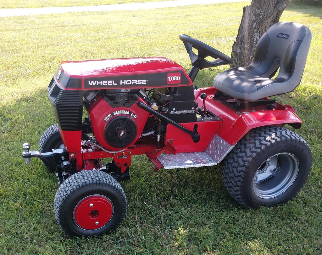

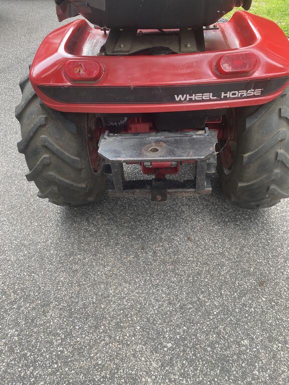

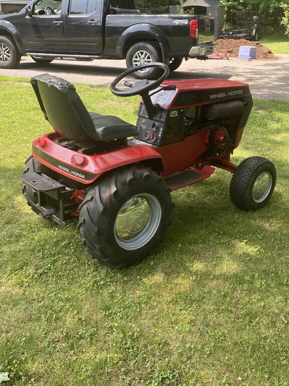

PWL216 1,310 #2251 Posted July 1, 2023 I spent a few hours working on and cleaning my 1994, 264hr 314-H that I bought a month ago for $100. The seller said the transmission was squealing. It wouldn’t start when I picked it up, but $100 is low risk, so I took it. Searching here about what the cause could be, I came across a post by Ed Kennel, saying it’s often the tensioner pulley. Turns out, that was the problem. Replaced it with OEM Toro pulley for $25. I also changed the oil, transmission filter and oil as well as the gas line, gas filter and installed a primer bulb. I discovered while cleaning it that it has what I think are wheel weights. Only thing left is to fix the lights. 2 11 1 Share this post Link to post Share on other sites
ebinmaine 81,293 #2252 Posted July 1, 2023 5 minutes ago, PWL216 said: 1994, 264hr 314-H I'm no financial genius but I'd say your investment is doing ok. 6 3 Share this post Link to post Share on other sites
SylvanLakeWH 32,934 #2253 Posted July 1, 2023 In other words, you got wheel weights for $100 and the attached tractor for free... 5 3 Share this post Link to post Share on other sites
D_Mac 9,339 #2254 Posted July 2, 2023 6 hours ago, SylvanLakeWH said: In other words, you got wheel weights for $100 and the attached tractor for free... or. you paid for a pair of hubcaps and got everything else free. 4 3 Share this post Link to post Share on other sites
Wheel-N-It 2,978 #2255 Posted July 2, 2023 7 hours ago, ebinmaine said: I'm no financial genius but I'd say your investment is doing ok. And doing better than my 401K ................. But that's a soapbox I won't get on tonight 3 4 Share this post Link to post Share on other sites
Jrblanke 976 #2256 Posted July 2, 2023 Awesome 314! That is my favorite model! 3 Share this post Link to post Share on other sites
kpinnc 19,110 #2258 Posted July 2, 2023 (edited) @PWL216 Very nice machine! Magnum engine coupled to an Eaton 1100- gotta love it! Edited July 2, 2023 by kpinnc 4 Share this post Link to post Share on other sites

Lee1977 7,813 #2260 Posted July 3, 2023 Been bringing the 312 back with a 16 Vanguard and help from @kpinnc. It's the 312 I bought from Wheel-N-it back in 2014. 2 3 1 Share this post Link to post Share on other sites
Sparky-(Admin) 26,899 #2261 Posted July 3, 2023 1 hour ago, Lee1977 said: Been bringing the 312 back with a 16 Vanguard and help from @kpinnc. It's the 312 I bought from Wheel-N-it back in 2014. Those red Briggs Vanguards just look right at home in a WH….like the factory built em that way. Too bad they (factory) didn’t, hear a lot of positives about the Vanguards. 2 Share this post Link to post Share on other sites
kpinnc 19,110 #2262 Posted July 3, 2023 1 hour ago, Lee1977 said: Been bringing the 312 back with a 16 Vanguard WooHooo! Been wondering how the repower is going. That 16 looks like it belongs there! 2 Share this post Link to post Share on other sites
Lee1977 7,813 #2263 Posted July 3, 2023 2 minutes ago, kpinnc said: WooHooo! Been wondering how the repower is going. That 16 looks like it belongs there! It was on the C-120 until I broke it. That 3 ft. fall snapped the corner right off the block. That's why I put the 3/8" plate under it. 1 Share this post Link to post Share on other sites

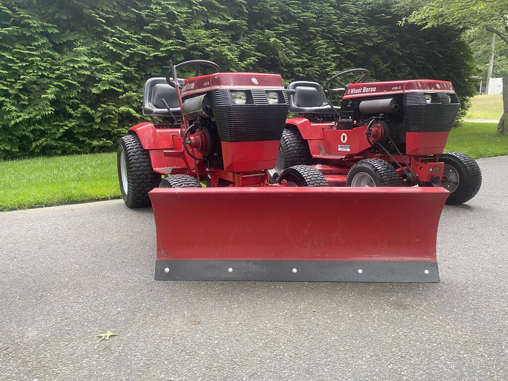

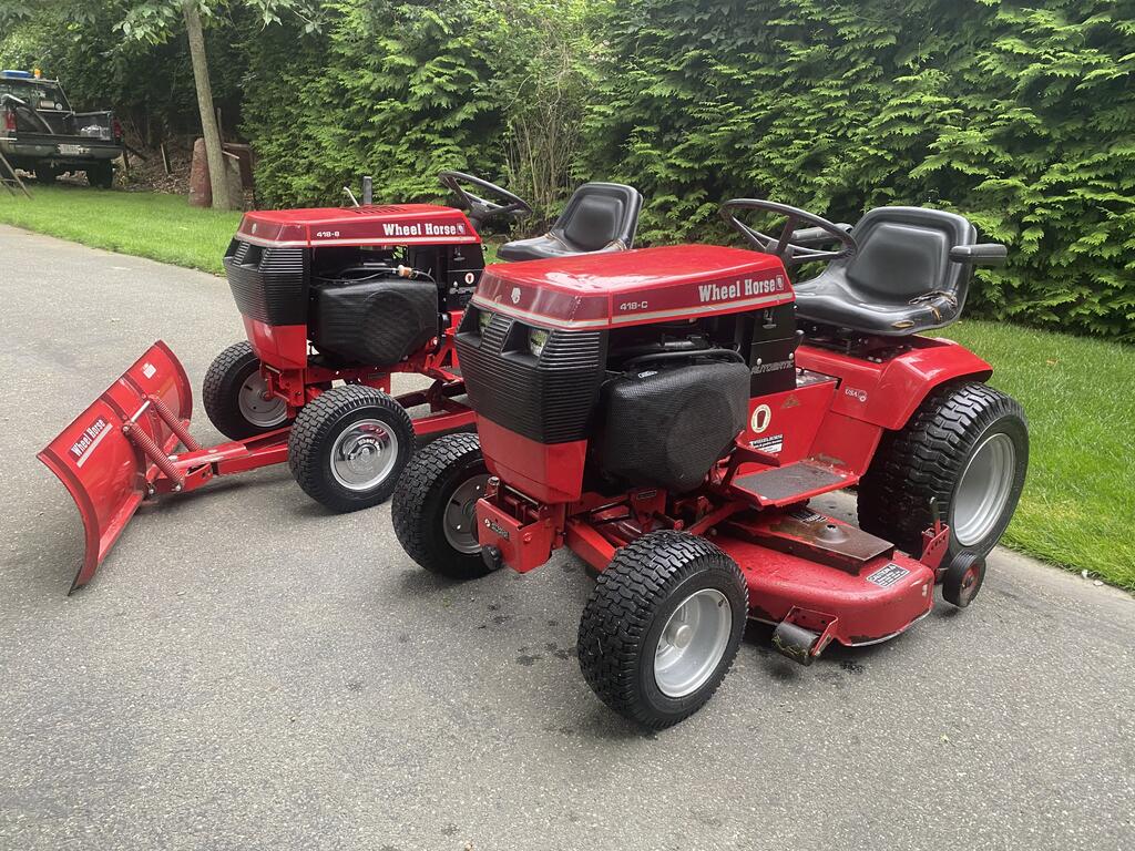

c-series don 12,758 #2265 Posted July 9, 2023 Some 418’s for your viewing pleasure 🤣🤣 for Side Shot Sunday! 3 12 Share this post Link to post Share on other sites

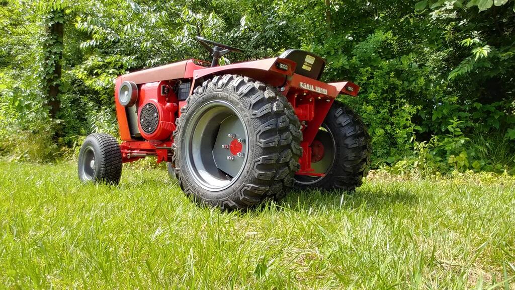

TonyToro Jr. 2,560 #2267 Posted July 10, 2023 My B-80 pulling tractor with a Kohler CH20 v-twin 6 7 2 Share this post Link to post Share on other sites

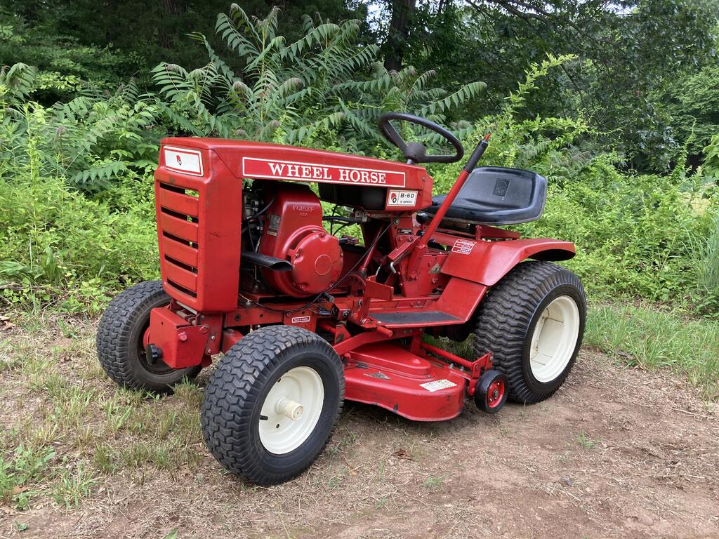

D_Mac 9,339 #2269 Posted July 16, 2023 310-8 out for a Sunday drive. 6 Share this post Link to post Share on other sites
Wheel-N-It 2,978 #2270 Posted July 17, 2023 2 hours ago, D_Mac said: 310-8 out for a Sunday drive. That's what I like about Sundays 2 4 Share this post Link to post Share on other sites
