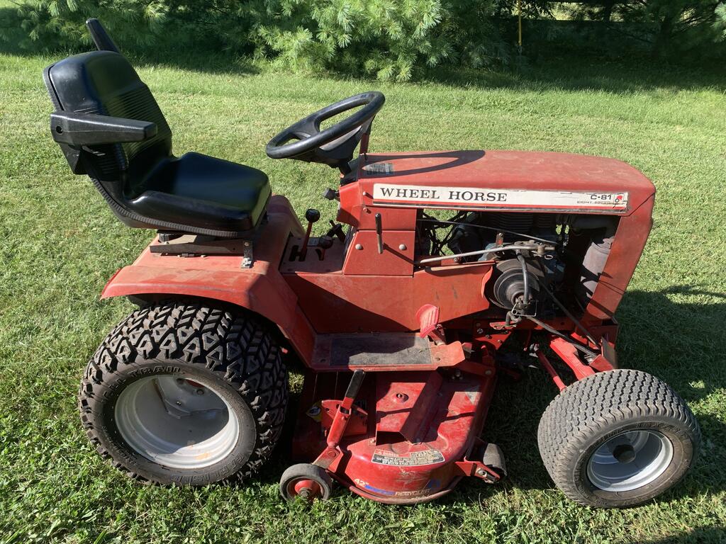

wh5208speed 677 #1801 Posted August 20, 2022 Just installed the newly rebuilt 16hp K-341 from richmondred. 2 hours of mowing followed by an oil change. I’ve owned a lot of nice Wheel Horses over the years….but this is my favorite. I keep wrestling on restoring or keeping it the way it is. 4 6 Share this post Link to post Share on other sites
rjg854 13,282 #1802 Posted August 20, 2022 Looks good the way it is, a nice oil rub down or buff it out and it will sparkle Share this post Link to post Share on other sites
ebinmaine 80,163 #1803 Posted August 20, 2022 4 hours ago, wh5208speed said: restoring or keeping it the way it is. 3 hours ago, rjg854 said: Looks good the way it is, ***** buff it out and it will sparkle I'll second that. ... And that means a fair amount considering I'm not a "patina guy". Your tractor still has PLENTY of great original paint. Get after it with some good ole fashioned elbow power, wet sand with various grits, and the right polish. You'll be in for a huge surprise how much that'll shine up. Share this post Link to post Share on other sites
wallfish 20,451 #1804 Posted August 20, 2022 7 minutes ago, ebinmaine said: considering I'm not a "patina guy" Uh Oh. You like'm ruined with new paint too? 1 Share this post Link to post Share on other sites
ebinmaine 80,163 #1805 Posted August 20, 2022 1 minute ago, wallfish said: Uh Oh. You like'm ruined with new paint too? Yessir. Some. The Paint Department and I have been begrudgingly growing an appreciation for... Old paint. Case in point ... Her own 867 hasn't been restored..... Yet..... 1 Share this post Link to post Share on other sites
Handy Don 17,230 #1806 Posted August 21, 2022 6 hours ago, wh5208speed said: I keep wrestling on restoring or keeping it the way it is. This one has paint that will come back with less effort than a full paint job--save the paint for one that really needs it! And this from someone who hates rust and isn't into showroom, trailer queen finishes. 1 Share this post Link to post Share on other sites

EB-80/8inPA 2,112 #1810 Posted August 21, 2022 (edited) 6 hours ago, wh5208speed said: I keep wrestling on restoring or keeping it the way it is. If it helps, and as an old wiseheimer from Mississippi once told me many years ago, “the lazy man’s way is always the best way.” Now, I never did believe that to be axiomatic (if for no other reason than the source happened to be pretty much a lazy layabout), but it did, on some level, seem to make some sound economic sense in terms of efficiency. Originality not only has its own intrinsic value, but its retention is certainly less costly than the alternative. Edited August 21, 2022 by EB-80/8inPA 1 1 Share this post Link to post Share on other sites

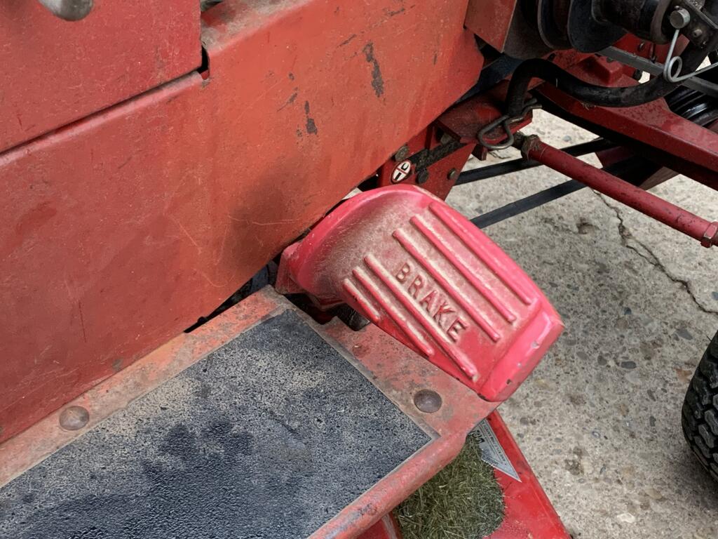

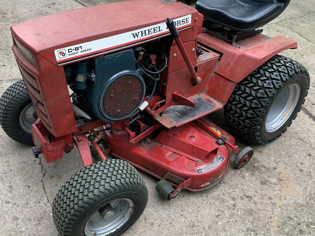

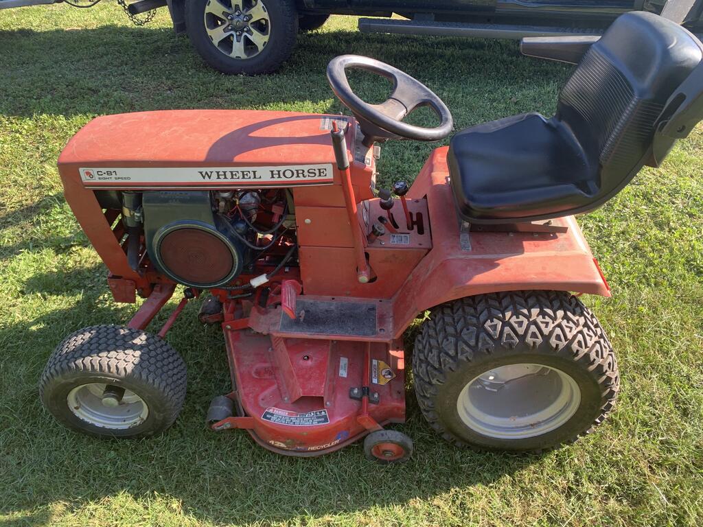

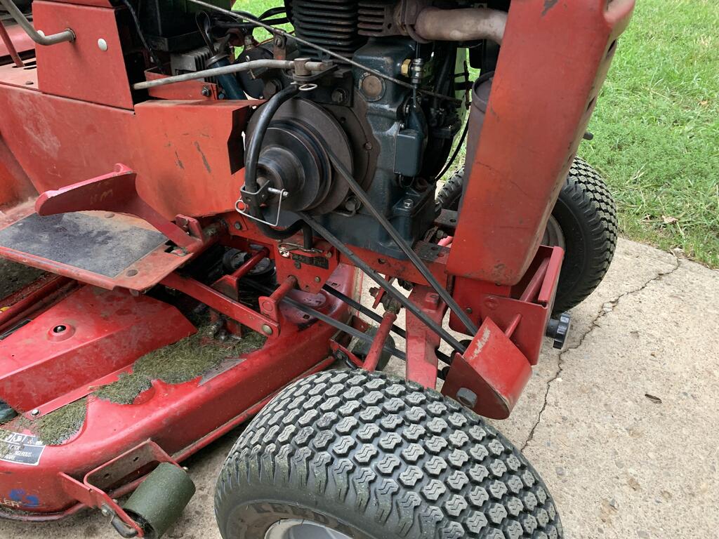

Blasterdad 3,167 #1811 Posted August 21, 2022 16 hours ago, wh5208speed said: Just installed the newly rebuilt 16hp K-341 from richmondred. 2 hours of mowing followed by an oil change. I’ve owned a lot of nice Wheel Horses over the years….but this is my favorite. I keep wrestling on restoring or keeping it the way it is. I see you've turned her into a "Super C81". Is that a whole 520 frame or just the front axle & pedals? More pics & details PLEASE!!! 1 Share this post Link to post Share on other sites
wh5208speed 677 #1812 Posted August 21, 2022 (edited) 9 hours ago, Blasterdad said: I see you've turned her into a "Super C81". Is that a whole 520 frame or just the front axle & pedals? More pics & details PLEASE!!! My goal was to make a Super C-161-8. I've always loved the look and simplicity of the 78-79 C-Series, but liked some of the features on the newer models. My intent was to make it look like factory. Except from adding two additional holes in the frame for the gear reduction housing (normally has 2), everything was just a bolt on. I intended to do a full-scale restoration on it once I broke the engine in, but I kind of like it the way it is. I have 2 other Super C-161-8 Speeds that I have plans to restore.....so I may just keep this one the way it is. I also have a factory electric lift, but I just don't think I want to put it on this tractor. I've owned some really nice Wheel Horses over the years, but this is easily my favorite. Not sure what other photos you would like, but here is a few I took before it started raining. Here is where the parts are from: 78-79 C-81 (Perfectly straight Sheet Metal) 16hp Kohler with solid oil pan (like better than the shaker plate) that I had richmondred01 rebuild this spring. 416-8 Frame & 8 Speed 96-97 314 (Brake & Clutch pedals, steering wheel 520-H (gear reduction steering, front axle, tires/rims/, bell crank, which avoids hitting the gear reduction steering, gas tank w/ gauge) Edited August 21, 2022 by wh5208speed 5 4 Share this post Link to post Share on other sites
Blasterdad 3,167 #1813 Posted August 22, 2022 5 hours ago, wh5208speed said: My goal was to make a Super C-161-8. I've always loved the look and simplicity of the 78-79 C-Series, but liked some of the features on the newer models. My intent was to make it look like factory. Except from adding two additional holes in the frame for the gear reduction housing (normally has 2), everything was just a bolt on. Thank you! Exactly what I wanted to know. I recently picked up a 520 H with a torched motor, with the intention of doing the same thing. I wasn't 100% sure how much would be just bolt on but now I know! Thank you! Awesome Job! Looking forward to adding a Super C to my stables too. 2 Share this post Link to post Share on other sites
kpinnc 18,863 #1814 Posted August 22, 2022 10 hours ago, wh5208speed said: My goal was to make a Super C-161-8 That's a fantastic machine! The looks of a "C" with the guts and modern touch of a 500 series! Very nice! 2 Share this post Link to post Share on other sites
Maxwell-8 4,371 #1815 Posted August 22, 2022 On 8/21/2022 at 1:12 AM, ebinmaine said: Get after it with some good ole fashioned elbow power, wet sand with various grits, and the right polish. You'll be in for a huge surprise how much that'll shine up. I noticed using some compound on a buffing machine makes that paint pop in no time, then finish of with some fine polish. Personally sanded trough the paint once, so I try to avoid wet sanding Like this paint, that will come right back. 11 hours ago, wh5208speed said: makes that paint pop in no time 2 1 Share this post Link to post Share on other sites

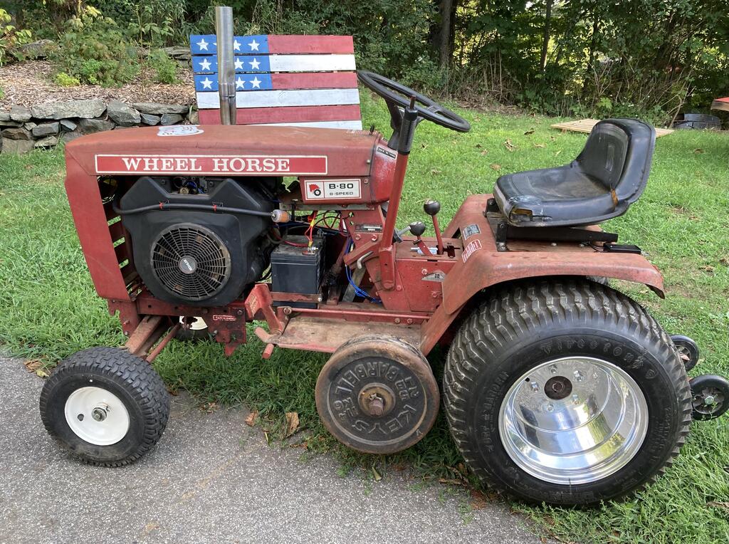

TonyToro Jr. 2,523 #1819 Posted August 27, 2022 Here is my B-80 that me and @TonyToro mostly finished building today for the pull tomorrow it’s a kohler CH20 that’s got some work done. We’re guessing it has about 60hp?? (And if you hear a weird noise like something rubbing or something it is a head gasket leak.) IMG_0606.MOV 8 1 Share this post Link to post Share on other sites

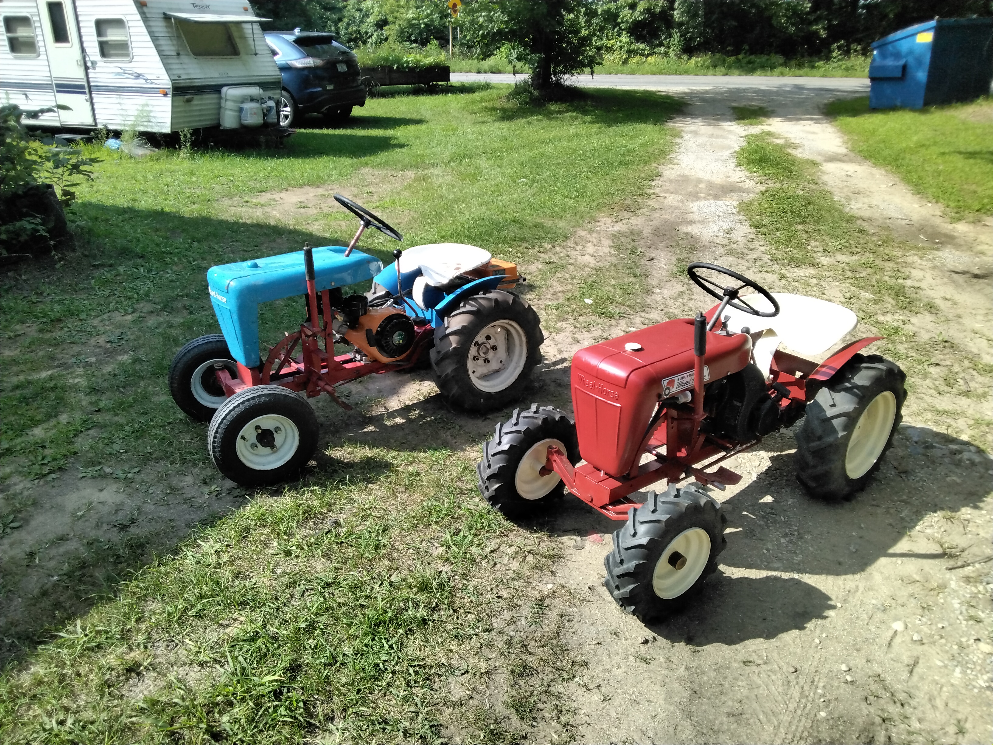

mhlmeader 689 #1821 Posted August 28, 2022 Currently working on blue dragon trying to get it rolling again, also painting it red, so it will be red dragon 2: return of red dragon!! 4 2 Share this post Link to post Share on other sites

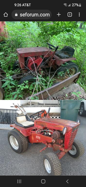

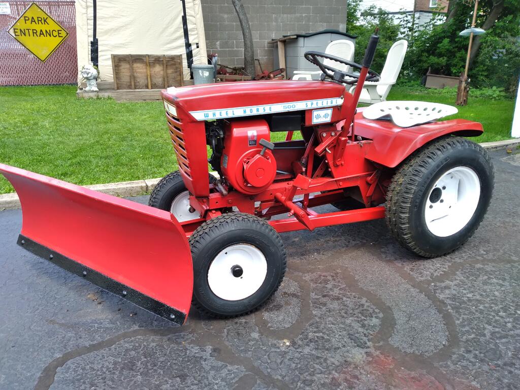

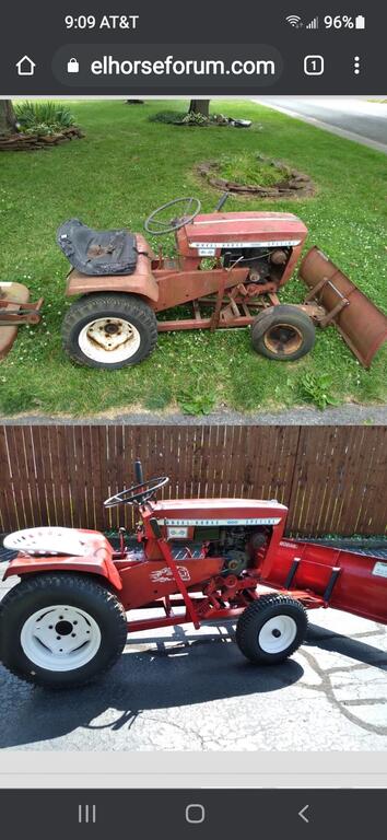

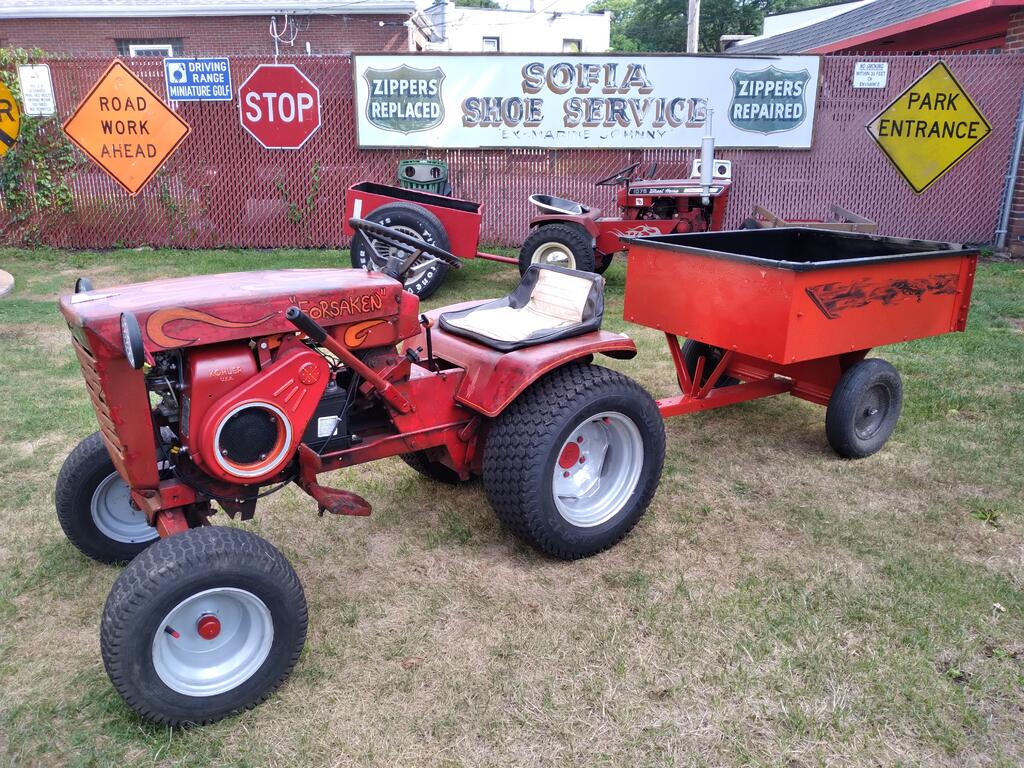

D_Mac 9,339 #1823 Posted August 28, 2022 (edited) Before and afters of the 500 Special and the 856. Bought them from a gentleman who left them in the woods for decades. After I completed the 500 Special I texted him to show him how I kept my word that I would get them running and looking good again. He then asked if he could borrow it because he had some dirt he needed pushing......ummmm no. Was maybe a year later I texted the photo of the 856 / Forsaken finished. He was pleased that they were given a second chance in life. I have since sold the 500 Special and the 856 proudly sits in my garage. I remember when he walked me out to see them. Weeds / trees growing through them. Even growing out of the seats. My first thoughts were what have I got myself into. We had to drag them out of the weeds with his truck. The 856's rims fell apart from being buried in the dirt. Ughhh. What have I done. Well onto the trailer they went and I brought them home. The 856 sat in my yard for a year as yard art. The 500 I got to work on pretty quick. Came out nice. A guy came around to buy a Lawn Ranger I had for sale and made me an offer I couldn't refuse for the Ranger and the 500. Off they went. Since I now had room in the gargage.... in from being outside for the last 20 plus years came the 856. Few months later it was running and driving again. Rolled in as a crusty, rusted, needing a lot of love 856. Rolled out as "Forsaken". As long as I own it it will get all the love it deserves. Runs perfect. Shifts and steers perfect. It's looks arnt for everyone but it's story you have to admire. Edited August 28, 2022 by D_Mac 4 2 2 Share this post Link to post Share on other sites
