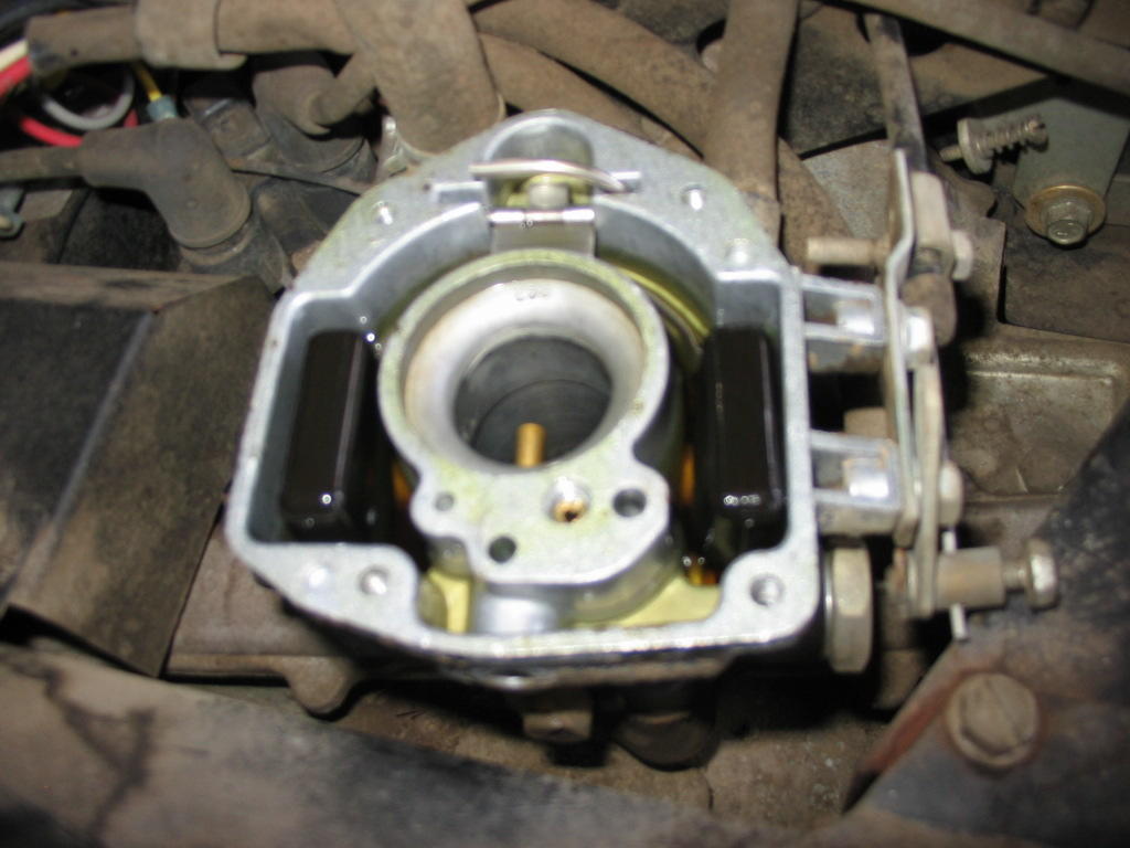

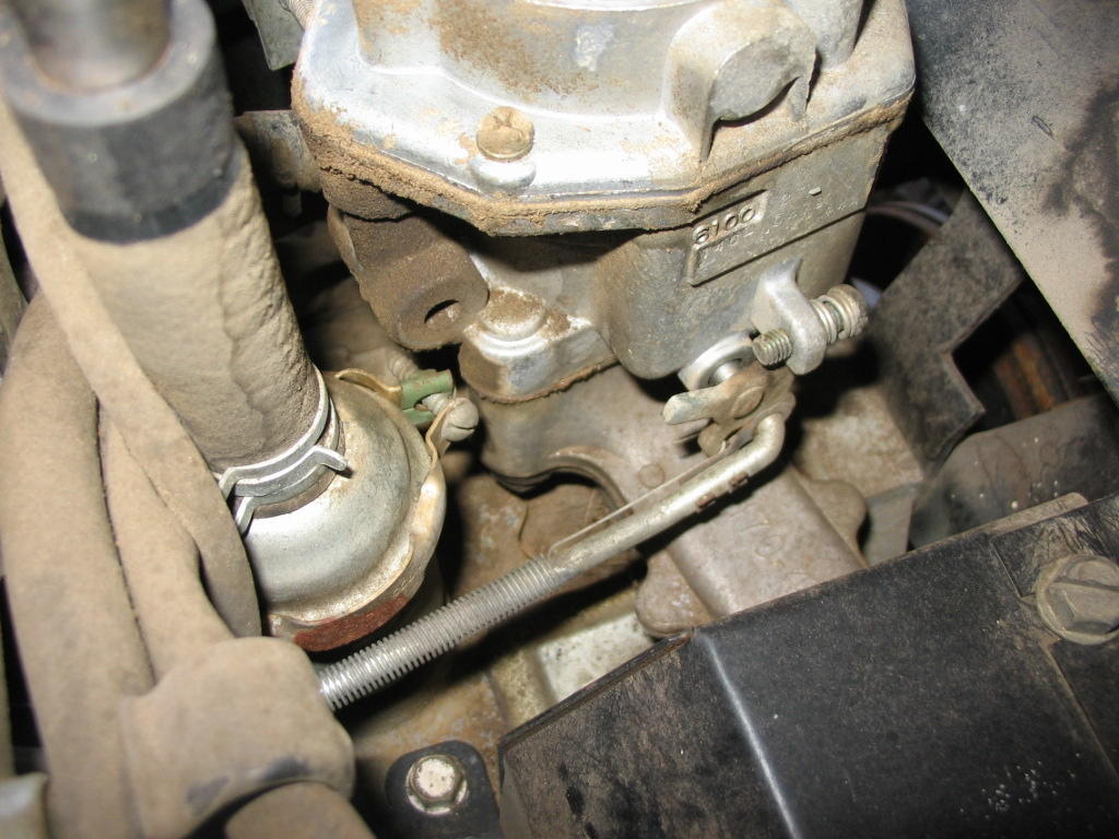

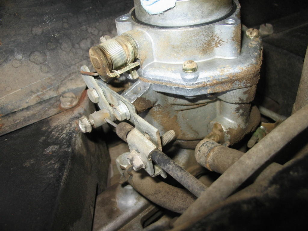

daveoman1966 3,883 #4 Posted March 21, 2020 These help... from a 520-H. Share this post Link to post Share on other sites
