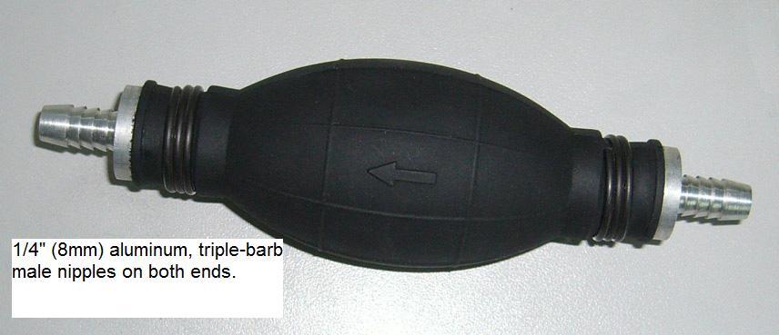

clueless 3,403 #5 Posted March 21, 2020 SOP for the rear tank with the mechanical fuel pump. I put a marine squeeze bulb on mine under the seat, just lift the seat a couple of good squeezes and she fires right up. About an $8.00 fix. 3 Share this post Link to post Share on other sites
handyrandy 7 #6 Posted March 21, 2020 1 hour ago, clueless said: SOP for the rear tank with the mechanical fuel pump. I put a marine squeeze bulb on mine under the seat, just lift the seat a couple of good squeezes and she fires right up. About an $8.00 fix. This bulb looks like what I need? So just run the fuel line up to the top of the tank were it is easy to get to the bulb, install the bulb and run the fuel line on to the fuel bump? Share this post Link to post Share on other sites
JoeM 10,031 #7 Posted March 21, 2020 something that worked on a machine that gave me the same trouble was routing the fuel line up high on the battery side of the engine then dipping back under the motor to the carb. Made like a hump or trap in the fuel line to limit back drain. I put the fuel filter there easy to change also. 4 Share this post Link to post Share on other sites
clueless 3,403 #8 Posted March 21, 2020 14 minutes ago, handyrandy said: This bulb looks like what I need? So just run the fuel line up to the top of the tank were it is easy to get to the bulb, install the bulb and run the fuel line on to the fuel bump? That's it lift the seat up, the big hole in the seat pan reach in and cut about 7 or 8 inches off the fuel line, make sure you turn off the gas first. Couple of clamps, make sure the arrow is pointing toward the engine, zip tie the line in a couple of places for stability, done, cheap and easy. The bulb has check valves so it take awhile before it losses its prime. 1 Share this post Link to post Share on other sites

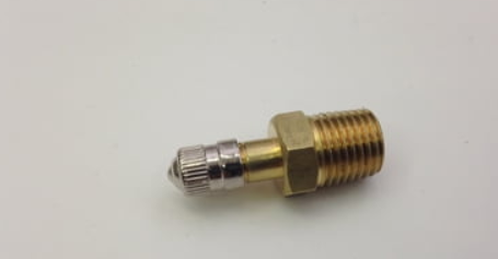

bds1984 1,509 #17 Posted December 12, 2020 I recently acquired a C175 that the previous owner said would start hard from the fuel draining back. Instead of a primer bulb he installed a schrader valve in the gas cap to allow a bike pump to pressurize the fuel tank enough to push fuel up to the engine. Anyways, don't forget to check the fuel lines for dry rot and cracks. I've acquired a few machines over the years from previous owners who claimed hard starting when the problem was traced to old/cracked fuel lines. Share this post Link to post Share on other sites
