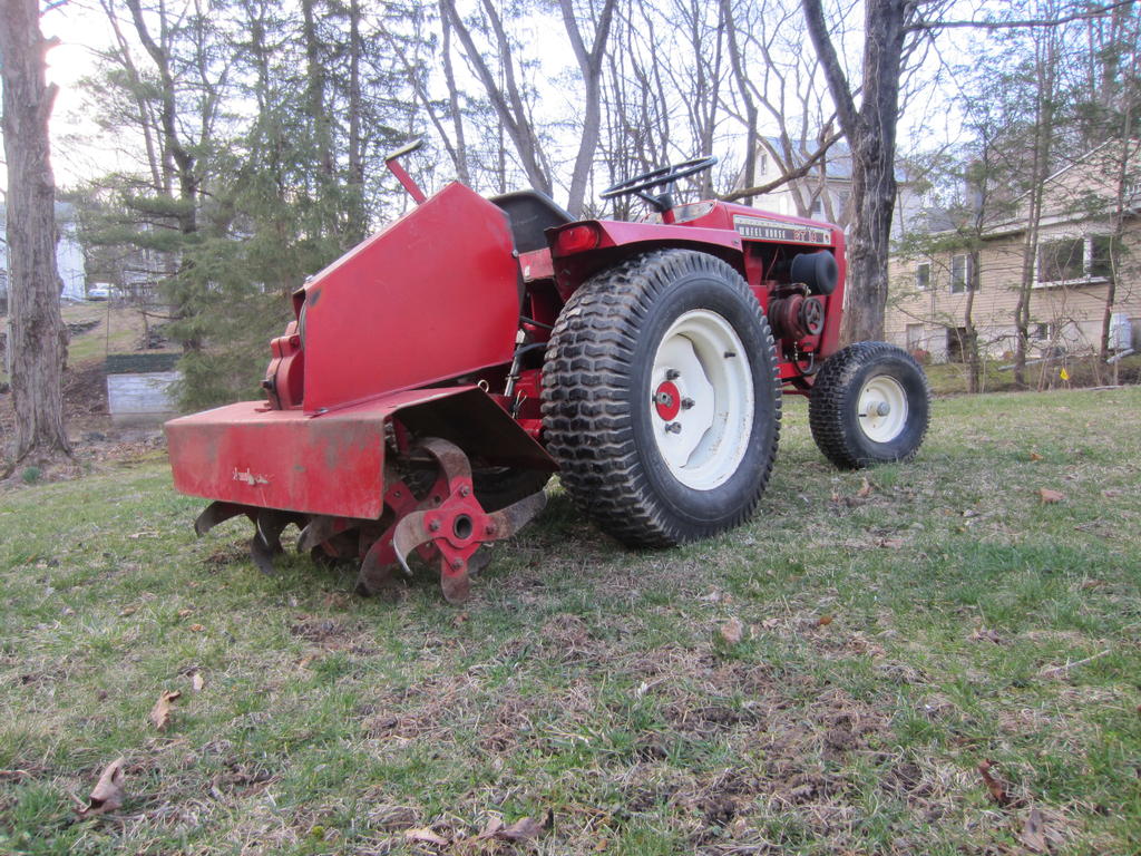

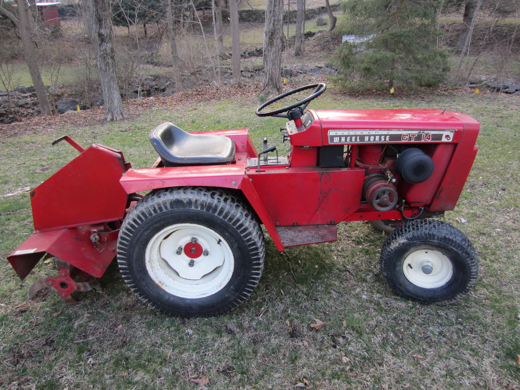

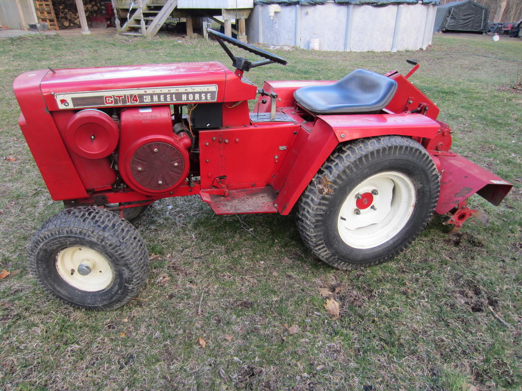

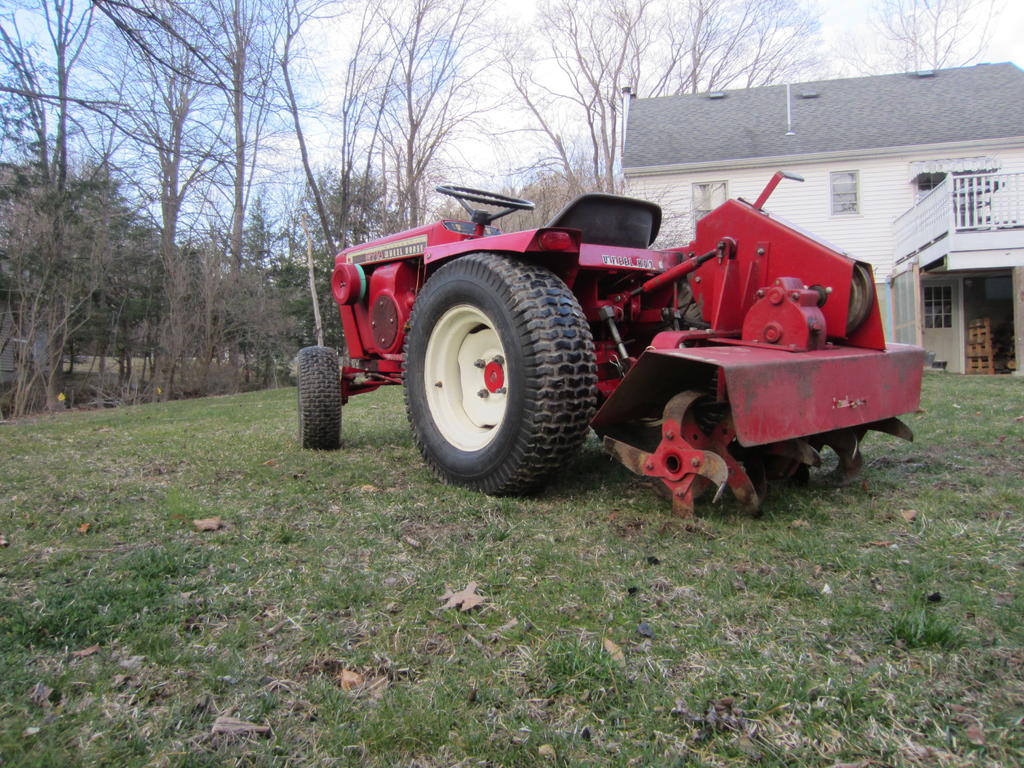

Herder 2,356 #1 Posted March 17, 2020 I purchased this GT-14 last year and it came with a few attachments, including this 36" Tiller. So I figured why not lets see if it works. It's awesome and has inspired me. I am going to put in a garden plot. The unit itself is a bit overkill for the job but what the heck. I like overkill. 5 Share this post Link to post Share on other sites
gwest_ca-(File Mod) 12,511 #2 Posted March 17, 2020 Good pictures. Some of your rear wheel nuts are loose and one missing. Garry 3 1 Share this post Link to post Share on other sites

Herder 2,356 #5 Posted March 18, 2020 10 hours ago, gwest_ca said: Good pictures. Some of your rear wheel nuts are loose and one missing. Garry Yes, I was at Napa yesterday and forgot to get some studs and lug nuts, I am going to replace them all. A weekend project. Share this post Link to post Share on other sites
gwest_ca-(File Mod) 12,511 #6 Posted March 18, 2020 Notice you have an extra drive pulley outside the pto clutch. How is it driven and what is it used for? Garry Share this post Link to post Share on other sites
Herder 2,356 #7 Posted March 18, 2020 2 minutes ago, gwest_ca said: Notice you have an extra drive pulley outside the pto clutch. How is it driven and what is it used for? Garry The pulley was on it when I bought it and I am not sure what it was used for. It's on there pretty good and I haven't had any luck removing it. Share this post Link to post Share on other sites

peter lena 10,091 #9 Posted March 18, 2020 herder, that's an awesome looking set up that you have ! talk about old school iron ! are you planning to do a lubrication change/ flush? chances are that any oil in it has been ther a long time , probably moisture/ milky debris . i have found that long neglected units take multiple flushes / drainings to make it right. if possible, run it to possibly heat up oils , then run and flush with a lighter oil to help cleaning. just my own experience , do what ever you think is right, pete Share this post Link to post Share on other sites
Herder 2,356 #10 Posted March 18, 2020 1 hour ago, peter lena said: herder, that's an awesome looking set up that you have ! talk about old school iron ! are you planning to do a lubrication change/ flush? chances are that any oil in it has been ther a long time , probably moisture/ milky debris . i have found that long neglected units take multiple flushes / drainings to make it right. if possible, run it to possibly heat up oils , then run and flush with a lighter oil to help cleaning. just my own experience , do what ever you think is right, pete Thanks Pete, yes it's going to require some attention. The first round of fresh fluids leaked out on to the shop floor. It needs seals. Share this post Link to post Share on other sites
