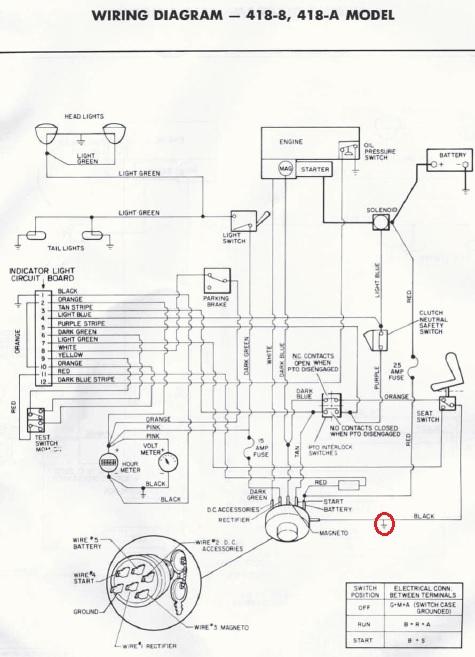

gwest_ca-(File Mod) 12,489 #10 Posted March 17, 2020 There is nothing wrong with the switch. The problem is the original wire on the switch ground terminal is not grounded for some reason. Could be the wire to terminal connection at the switch is corroded or it could be at the other end of the wire. The diagram shows a ground to the chassis between the ignition switch and the seat switch which is circled. Could have failed there or fallen off. Garry Share this post Link to post Share on other sites
biged77 113 #11 Posted March 17, 2020 On my 418-8 there was no wire to ground. I believe the ground symbol indicates that the switch is grounded at the panel and through sheet metal to battery ground. But I've been wrong before, maybe the ground wire was just missing on my 418-8. Ed Share this post Link to post Share on other sites
