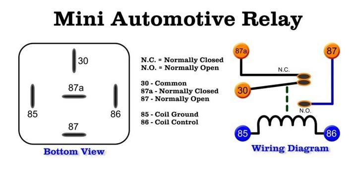

gwest_ca-(File Mod) 12,489 #2 Posted March 14, 2020 I do not know what all is in the the 99-5365 kit but it included a 48-4700 relay which has been replaced by 116397 relay. A very common one used today in autos and available everywhere. Will save you some serious $'s if you can make it work. Click on the picture for more info 953 nut posted this for a different application. We can help with the wiring if you need it. Garry 4 1 Share this post Link to post Share on other sites
