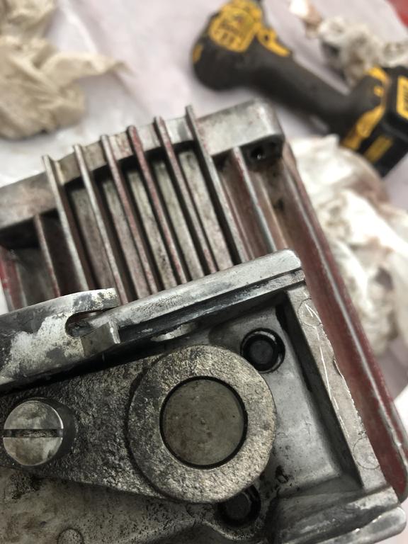

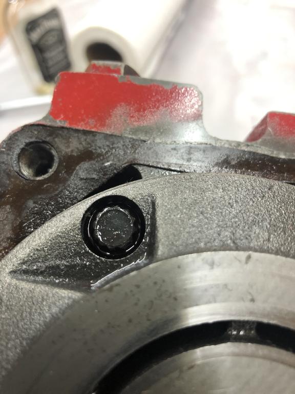

The Tuul Crib 7,354 #1 Posted March 13, 2020 I just started to take the sun strand apart and I got to a point where I'm scratching my head. I cannot find a socket to fit these bolts. Any ideas what size they are ? they look to be possibly a 12 point that I don't have. 1 Share this post Link to post Share on other sites

pfrederi 21,274 #4 Posted March 13, 2020 (edited) To work a sunstrand hydro you eventually need 3/8" and 5/16" 12 point sockets. You are going to have to remove the motion control arm first to get to the 3 12pt head bolts. Edited March 13, 2020 by pfrederi 1 Share this post Link to post Share on other sites
The Tuul Crib 7,354 #5 Posted March 13, 2020 11 minutes ago, pfrederi said: To work a sunstrand hydro you eventually need 3/8" and 5/16" 12 point sockets. You are going to have to remove the motion control arm first to get to the 3 12pt head bolts. That's what it did look like to me as being a 12 point. I don't have any 12 points so I will have to go shopping this weekend Share this post Link to post Share on other sites
pfrederi 21,274 #6 Posted March 13, 2020 Just now, The Tool Crib said: That's what it did look like to me as being a 12 point. I don't have any 12 points so I will have to go shopping this weekend I would suggest getting 1/4" drive for the 5/16. Some 3/8" drive sockets can be kind of fat and may not clear. this is a case where more expensive sockets are usually made of better steel and can be thinner/smaller 1 1 Share this post Link to post Share on other sites

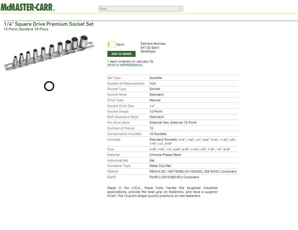

pfrederi 21,274 #7 Posted March 13, 2020 I bought this set pricey but extremely good quality. Like the 9/16 which is not usually in 1/4" drive sets but fits in tight spaces!!! 1 Share this post Link to post Share on other sites
ZXT 2,402 #8 Posted March 14, 2020 Looks like someone hasn't ever had to replace the steering rag joint on an old GM vehicle! They're 12pt and the main reason I have a few 12pt sockets. I'll second getting 1/4" drive sockets. The bore of that hole is pretty small. Seems that most of the cheaper 12pt sockets I've seen are unnecessarily thick. 2 Share this post Link to post Share on other sites
