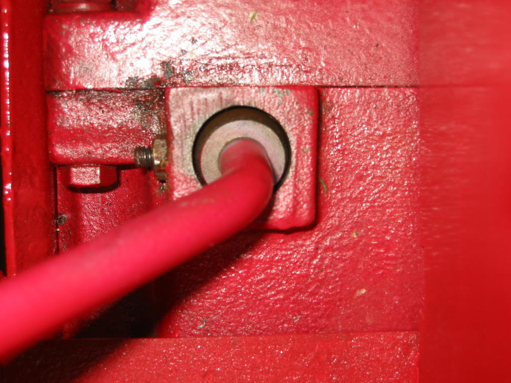

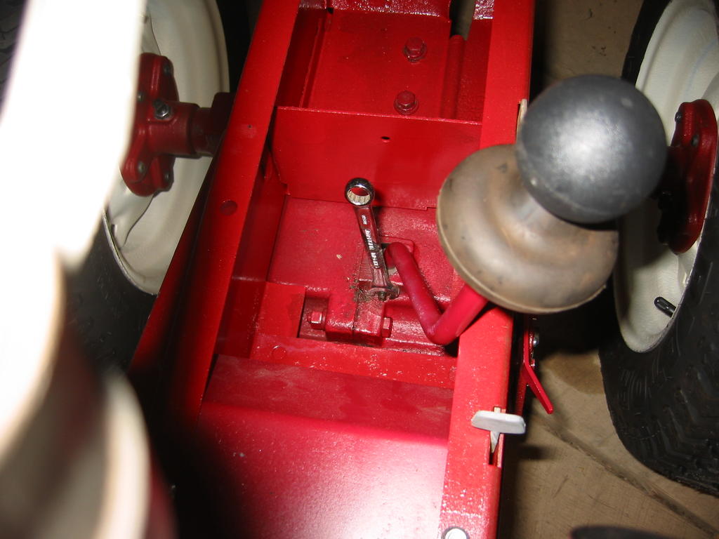

Pullstart 71,482 #2 Posted March 10, 2020 2 minutes ago, driver903 said: I moved my 854 recently moved fine went to return to shed it will not go into reverse in fact the gearbox will not go into any gear in the original position but there is still one forward gear where neutral should be am I looking a linkage issue or major gearbox damage Often times if you shift gears quickly the shift forks get stuck in two gears. If you loosen the jam nut on the front of the shifter under the shift boot, you should be able to back out the set screw and check that the forks are located correctly. It should make a square with the two forks centered in the shifter hole. If the square is offset, use a big screwdriver to pry them back to center one by one. Re-install the shifter and try your luck again... this time giving neutral a second before shifting to another gear. 3 Share this post Link to post Share on other sites

Achto 32,889 #4 Posted March 10, 2020 Looks like pullstart has you pointed in the right direction. The jamb nut & set screw can be a little pit of a bear to get to on an 854, they didn't leave you much room to get at it through the hole in the sheet metal for the shifter. It can be done with out tearing the tractor apart though. 2 Share this post Link to post Share on other sites

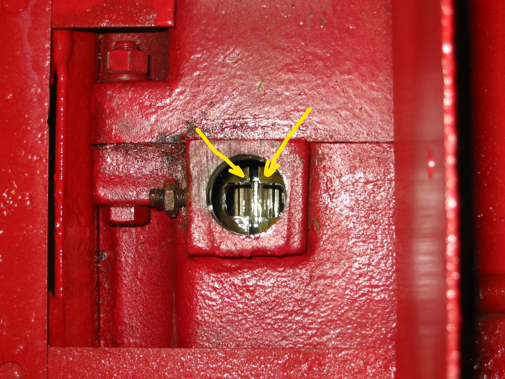

pfrederi 21,274 #6 Posted March 10, 2020 Use a big screw driver to pry the forks into position (yellow arrows) 5 2 Share this post Link to post Share on other sites
