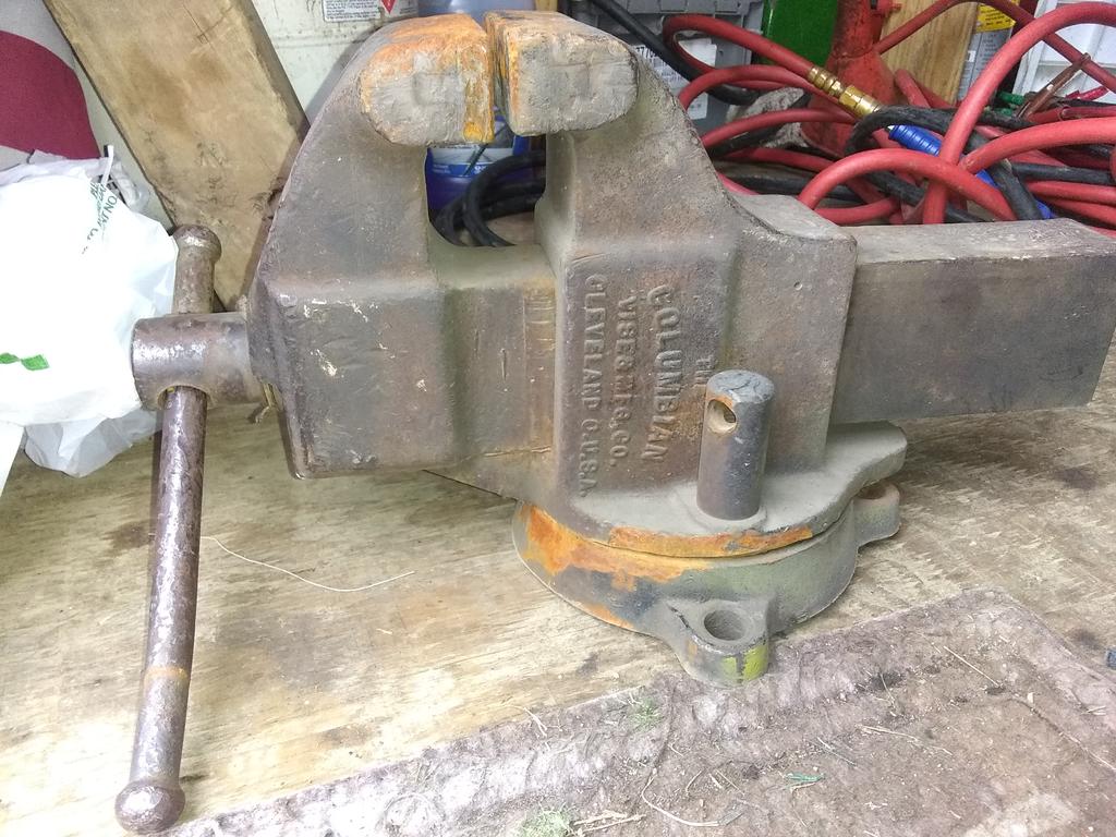

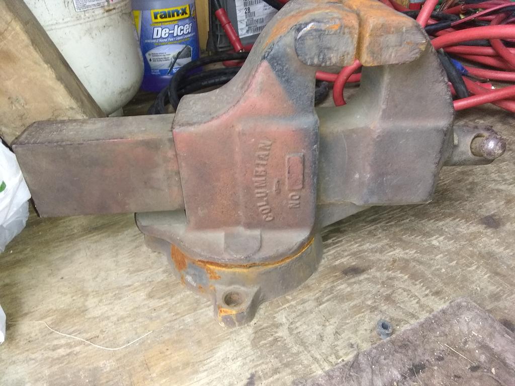

bottjernat1 2,196 #1 Posted March 10, 2020 Well a good friend of mine who works at the same scrap yard that my late dad did. Brought me over a bigger vise! My friend ryan is a great guy him and his brother helped me clean off my dads property of equipment after dad died. Anyways I have been asking on my facebook to trade someone and money for a bigger vise. i am using an antique old little one but for what i do all the time i needed a bigger one. So Ryan dropped off this old gal to my house in the roll off truck while i was at work. I am super thankful. My question is can anyone date this thing? It is super cool i almost dont want to use it. LOL Also any ideas on what to use to make the other handle it needs? 5 2 1 Share this post Link to post Share on other sites
rjg854 12,888 #2 Posted March 10, 2020 A drift pin should do the job, or maybe a appropriate size Philips screw driver. 1 Share this post Link to post Share on other sites
gwest_ca-(File Mod) 12,061 #3 Posted March 10, 2020 https://video.search.yahoo.com/search/video;_ylt=A2KLfSOKdmdekf8Axy5XNyoA;_ylu=X3oDMTByMjB0aG5zBGNvbG8DYmYxBHBvcwMxBHZ0aWQDBHNlYwNzYw--?p=columbian+vise&fr=mcafee Garry 1 Share this post Link to post Share on other sites
Achto 31,275 #4 Posted March 10, 2020 Nice vise !! Appropriate size round stock with an acorn nut threaded on each end would make a good handle. 4 Share this post Link to post Share on other sites
ebinmaine 77,764 #5 Posted March 10, 2020 Niiiice 1 Share this post Link to post Share on other sites
JoeM 9,672 #6 Posted March 10, 2020 Colombian......those are sweet! Good old american made steel! 2 Share this post Link to post Share on other sites
CCW 1,491 #7 Posted March 10, 2020 Clean it. Use it. Too good to be an anchor. 1 Share this post Link to post Share on other sites
bottjernat1 2,196 #8 Posted March 10, 2020 I am going to actually be careful and wire brush it. and paint it. I have heard alot of them are red. I think i will go with international red (how fitting LOL) and have the wife paint the letters black. I will take a photo when i get it done. 3 Share this post Link to post Share on other sites

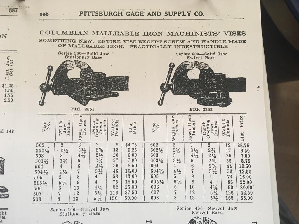

formariz 12,358 #9 Posted March 10, 2020 (edited) @bottjernat1 Your vise is a 600 Series Malleable Iron Machinists Vise. It is from around 1940. There should be an actual model # in the raised Rectangular section after No. If not from the size of jaws (width) you can tell you what the model No. is. The entire vise with the exception of the handle and screw is entirely made out of malleable iron and it was considered to be "practically Indestructible". The missing handle was similar to the main handle but much smaller of course. You can just make one out of a steel rod and if you want to be accurate you can weld a proper size ball bearing on each end. As for color although many of the Colombian Vises were a Burgundy color, most machinists vises were a dark Gray. Edited March 10, 2020 by formariz 4 2 Share this post Link to post Share on other sites

bottjernat1 2,196 #15 Posted March 11, 2020 18 hours ago, formariz said: @bottjernat1 Your vise is a 600 Series Malleable Iron Machinists Vise. It is from around 1940. There should be an actual model # in the raised Rectangular section after No. If not from the size of jaws (width) you can tell you what the model No. is. The entire vise with the exception of the handle and screw is entirely made out of malleable iron and it was considered to be "practically Indestructible". The missing handle was similar to the main handle but much smaller of course. You can just make one out of a steel rod and if you want to be accurate you can weld a proper size ball bearing on each end. As for color although many of the Colombian Vises were a Burgundy color, most machinists vises were a dark Gray. Well i like to stay original so i may do the burgundy or grey! but i may still paint the letters black. i like the handle idea my welding skills are still a working progress so i may take it to my trusted local shop they do a great job and there cheap. Id like to fix it up but i will be using it that is for sure. Thanks for all the history i love it!! Share this post Link to post Share on other sites

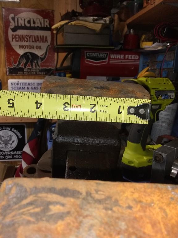

formariz 12,358 #17 Posted March 11, 2020 (edited) Are the jaws on your vise replaceable? What width are they? If you can make out the model # is there a letter before the number? Edited March 11, 2020 by formariz 1 Share this post Link to post Share on other sites

bottjernat1 2,196 #19 Posted March 11, 2020 2 hours ago, formariz said: Are the jaws on your vise replaceable? What width are they? If you can make out the model # is there a letter before the number? i will take a closer look when i get home today Share this post Link to post Share on other sites

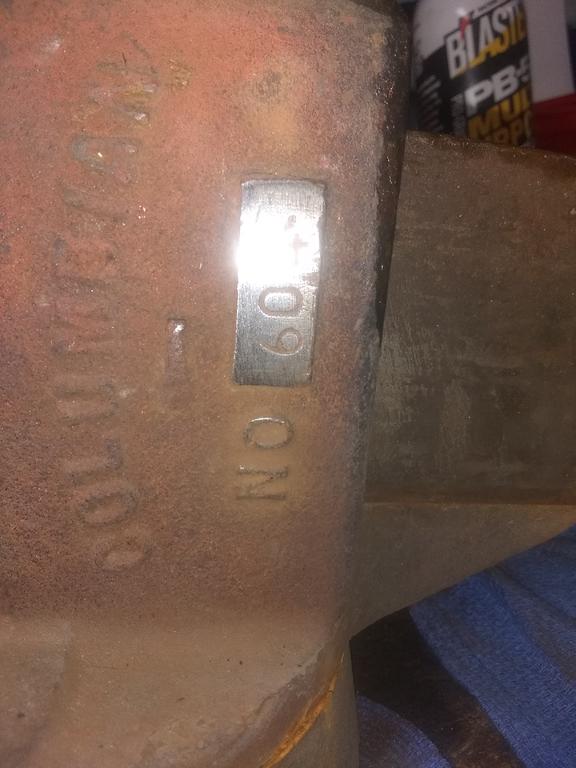

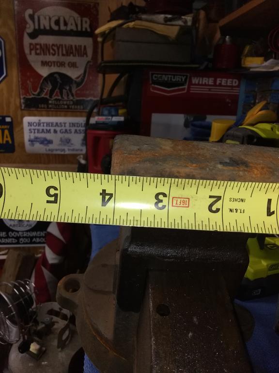

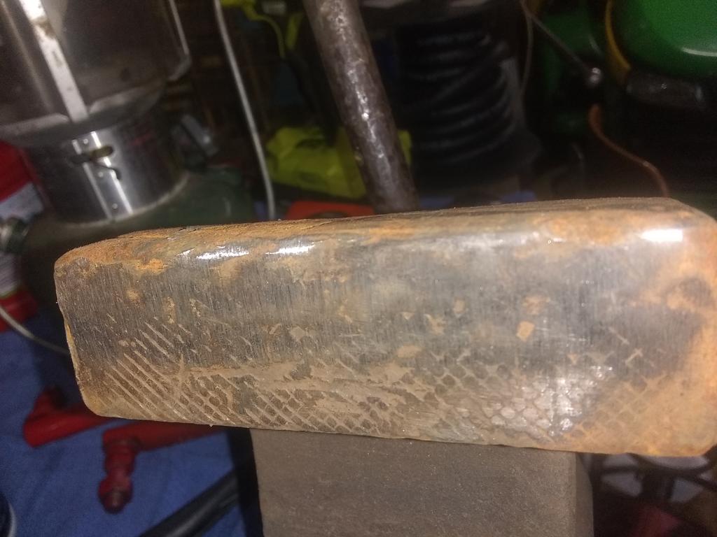

bottjernat1 2,196 #20 Posted March 12, 2020 Ok so here is a few more photos of the vise I took last night! She is a 604 model. The jaws dont look like they have any screws or whatnot holding the clamping surfaces on each side? are these just a pound into place pieces? like a factory 10/22 ruger site? 1 Share this post Link to post Share on other sites
cleat 8,810 #21 Posted March 12, 2020 Clean up the top of the vise and you might find the attaching hardware there. I believe the jaws are T shaped and fit into slots in the vise body then are pinned into place It was a few years ago when I rebuilt one so my memory is a little hazy at this point. 1 Share this post Link to post Share on other sites
bottjernat1 2,196 #22 Posted March 12, 2020 43 minutes ago, cleat said: Clean up the top of the vise and you might find the attaching hardware there. I believe the jaws are T shaped and fit into slots in the vise body then are pinned into place It was a few years ago when I rebuilt one so my memory is a little hazy at this point. If i cant find any pins i may just break out my demel tool and cut slots rom what is still on it. LOL it will take forever but oh well. LOL Share this post Link to post Share on other sites
formariz 12,358 #23 Posted March 12, 2020 1 hour ago, bottjernat1 said: If i cant find any pins i may just break out my demel tool and cut slots rom what is still on it. LOL it will take forever but oh well. LOL Although removable I don't believe the 604 had " replaceable" jaws For that it would have been model C604. Those had two crews on the jaw's face. 1 Share this post Link to post Share on other sites

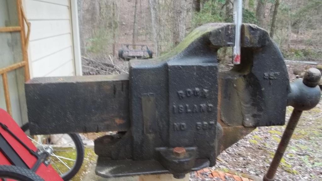

953 nut 64,610 #24 Posted March 13, 2020 I've been using this one for years. A neighbor bought it at a yard sale for $ 5.00 at a yard sale and gave it to me as a thank you for favors I had done for him, probably 1980 or so. Jaws are six inches wide and will open to about tan inches. 3 1 Share this post Link to post Share on other sites
formariz 12,358 #25 Posted March 13, 2020 (edited) 4 hours ago, 953 nut said: I've been using this one for years. A neighbor bought it at a yard sale for $ 5.00 at a yard sale and gave it to me as a thank you for favors I had done for him, probably 1980 or so. Jaws are six inches wide and will open to about tan inches. WOW. There is one not seen everyday. That thing weighs about 130Lbs. Those were made from about 1930 to 1957. I have seen some go for a substantial amount, much more than $5.00. Is there anything engraved in the brass plate on the side? Edited March 13, 2020 by formariz 1 Share this post Link to post Share on other sites
