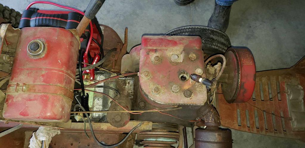

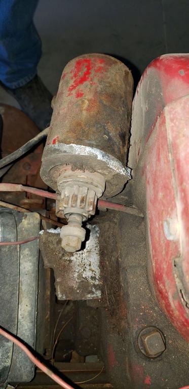

BPEisenhower 557 #1 Posted March 9, 2020 I figured it would be a good day to see what exactly I got myself into. Evidently a wonderful mess! Hooked up battery pack... turned key..starter engaged, hit hard once and broke off. Since I was in a good mood and have a booster on battery, I can still check for spark anyways..Right? Cleaned, gapped and no luck. After getting blisters on thumb and index finger from spinning engine by hand using a engine screen screw 😡 I wasn't thrilled and took a screwdriver to the backside of ignition switch and shorted out 2 terminals and have spark and plug. After speaking with Achto, he says that I have the magneto and points style ignition that is costly when no good. He mentioned that I can convert it to the traditional style points and 12v coil and different ignition switch. Any idea what coil, condenser and switch is needed? 1 Share this post Link to post Share on other sites

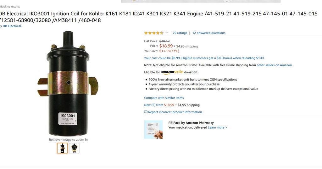

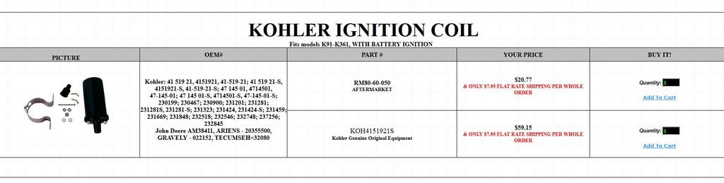

pfrederi 20,828 #2 Posted March 9, 2020 (edited) Any internally resisted 12v coil will work. Amazon Evil bay etc... Pick up a generic 5 pin switch at a big box store. just make sure it has an 'I" terminal not an "M" Edited March 9, 2020 by pfrederi 2 Share this post Link to post Share on other sites

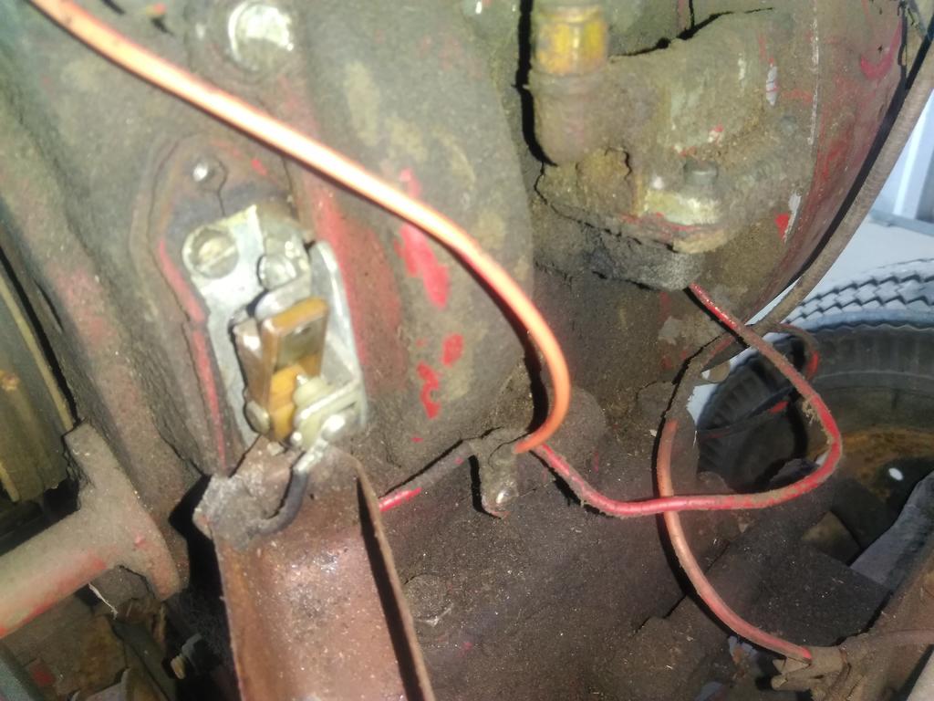

BPEisenhower 557 #9 Posted March 9, 2020 My fault! I failed to mention that it has points and magnetron type ignition. There is a wire running from back of key switch to the points that if I arc across with a screwdriver it does spark at the plug. But since starter broke 😭, I have to turn motor by hand to see if it would spark on its own and doesn't. Either way, I'm going to make it run. Previous owner said it was useless and too old to be practical..... If that's the situation, why is it 10 years older than me and in better shape?! I will get better pictures soon. 2 1 Share this post Link to post Share on other sites

Achto 32,035 #11 Posted March 9, 2020 1 hour ago, BPEisenhower said: . There is a wire running from back of key switch to the points that if I arc across with a screwdriver it does spark at the plug. This the wire from the switch to the points should be to ground out the points in order to shut the engine off. Just a guess here, but I bet when you throw positive voltage to the points it is creating the spark that you are seeing. On another note it is usually not a good thing to send positive voltage to a mag coil, often times this will kill a mag. 1 Share this post Link to post Share on other sites

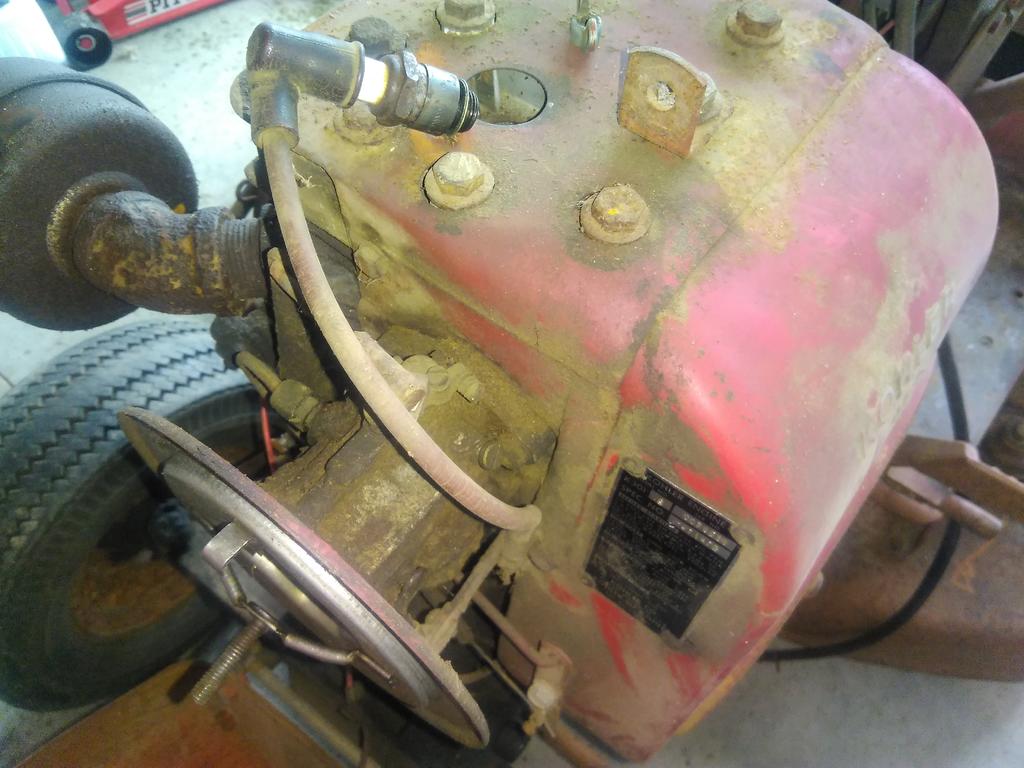

BPEisenhower 557 #12 Posted March 9, 2020 Grabbed a few more pictures... I thought the points were clean but, I could be wrong. Don't have a points file and a folded piece of 400 grit Emory cloth and electrical contact cleaner might not be enough. Still no spark at points. Even used my fingers to feel a jingle and nothing Share this post Link to post Share on other sites
pfrederi 20,828 #13 Posted March 9, 2020 In the future do not use Emory cloth.. it leaves grit. Use a points file or borrow your wife's steel nail file.... Share this post Link to post Share on other sites
gwest_ca-(File Mod) 12,323 #14 Posted March 10, 2020 Don't apply battery voltage to the ignition wire. That will smoke the coil. Your points may be not closing or they won't make electrical contact when they are closed. By grounding the wire at the ignition switch you may be doing the same thing the points are supposed to do. One ground of the points = one spark at the plug. Garry 1 Share this post Link to post Share on other sites
