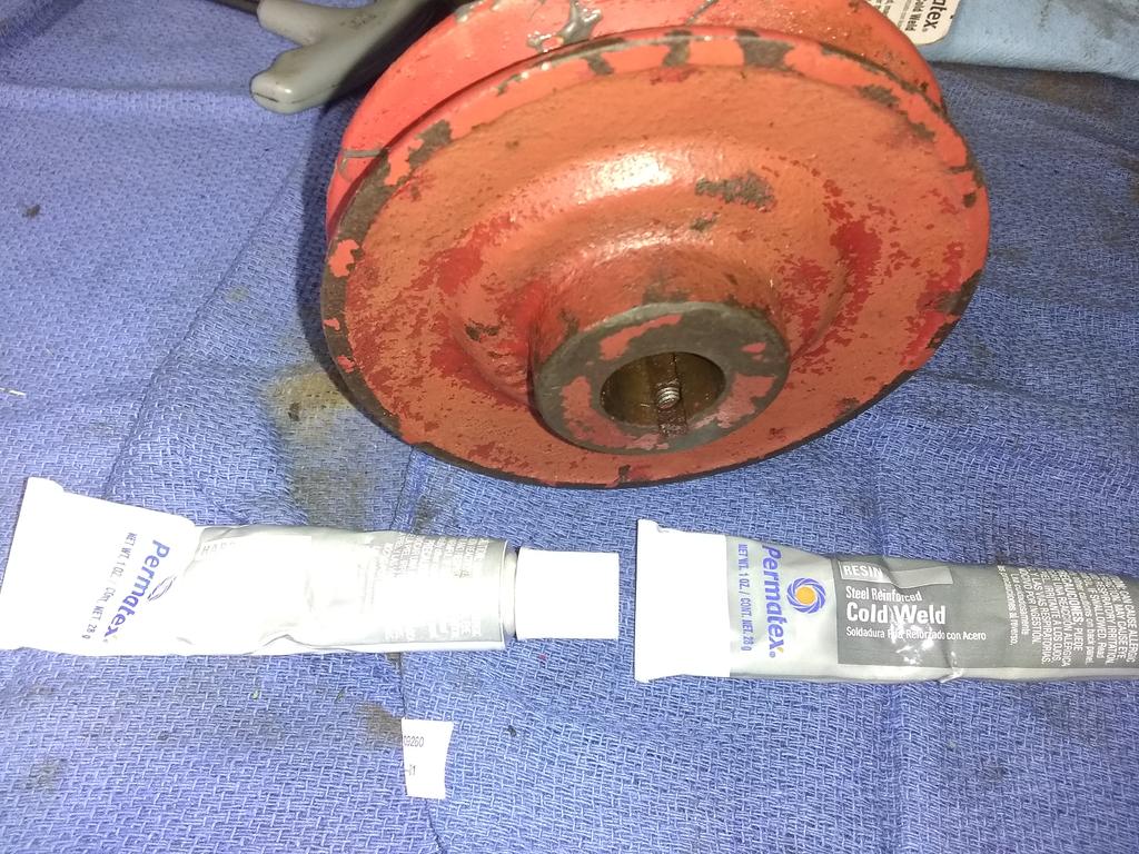

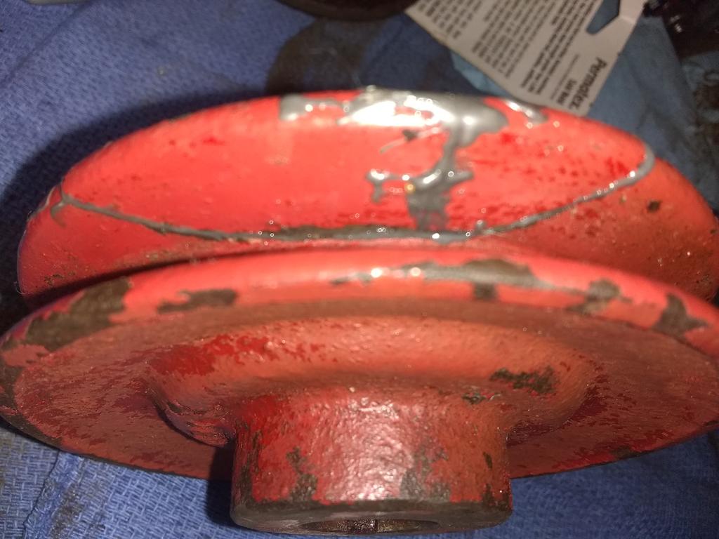

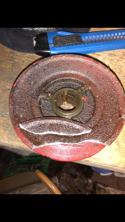

bottjernat1 2,196 #26 Posted March 16, 2020 So yah this happened. I have never broke a pulley ever. I didn't follow my own rules for removing a pulley. I'm fixing it. I could by new but I don't want to. So mad!! This is the correct pulley for the transmission on my 856. 2 Share this post Link to post Share on other sites
Pullstart 70,724 #27 Posted March 16, 2020 Well what’dya do that for? what are are your plans to fix it up? 1 Share this post Link to post Share on other sites
The Tuul Crib 7,354 #28 Posted March 16, 2020 I might have a spare one if ya need it. What is the diameter? 1 Share this post Link to post Share on other sites
bottjernat1 2,196 #29 Posted March 16, 2020 3 hours ago, pullstart said: Well what’dya do that for? what are are your plans to fix it up? I planned on having a friend who needs john deere parts to weld it for me he can do cast iron. But i broke the broken piece on saturday caring it around with me. So now i am using a cold weld goop. It will be hidden and out of site so it will be ok for now. biggest thing i have learned to be more patient. I will post it when its all cured up. I will go ahead and sand it and paint it to. Hopefully it will look as good as new LOL. Share this post Link to post Share on other sites

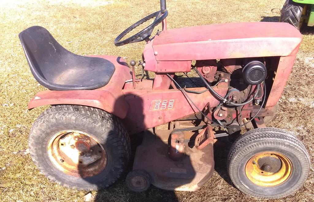

bottjernat1 2,196 #31 Posted March 16, 2020 (edited) So I also wanted to add I noticed something else on this horse. the rear wheels are not right at all. The rims have 6 holes? It is hard to tell in this photo but i promise you there is 6 holes one of course doesn't have a bolt in it. These rims definitely came off something else! Edited March 16, 2020 by bottjernat1 Share this post Link to post Share on other sites
WildmanC120 613 #32 Posted March 16, 2020 1 hour ago, bottjernat1 said: I planned on having a friend who needs john deere parts to weld it for me he can do cast iron. But i broke the broken piece on saturday caring it around with me. So now i am using a cold weld goop. It will be hidden and out of site so it will be ok for now. biggest thing i have learned to be more patient. I will post it when its all cured up. I will go ahead and sand it and paint it to. Hopefully it will look as good as new LOL. I'm not sure that is the best idea. If the goop let's go then you have pieces of metal flying around. Plus you may be adding to the vibration of the engine/drive line as now you are adding weight to one side of that pulley and spinning it around at 3600 rpm. I would just get a new one for $20. 4 Share this post Link to post Share on other sites

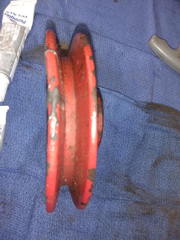

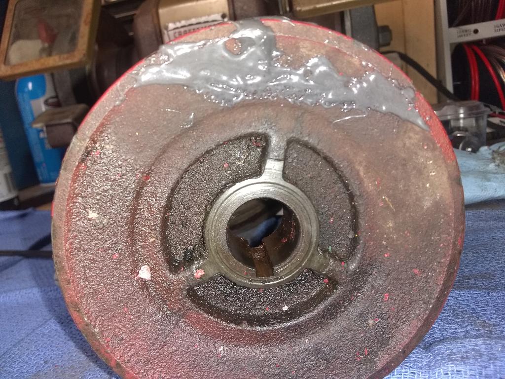

bottjernat1 2,196 #33 Posted March 18, 2020 (edited) Well i cold welded it! the broke off piece broke and so i thought wth i will give this a shot. It may not work but im going to try! I will update on weather my fix worked! I didnt think the set screw would be a different size so now i have to get me a set screw. Worse case i will have to break down and get a new one. I wanted to weld it but the broke piece broke in to smaller pieces and i figured it would be harder to weld. I know its a hot mess but maybe it will work. LOL Edited March 18, 2020 by bottjernat1 Share this post Link to post Share on other sites

pfrederi 20,870 #35 Posted March 18, 2020 (edited) I wouldn't try that at all. if you try it stay way out of the way. Edited March 18, 2020 by pfrederi 3 Share this post Link to post Share on other sites
bottjernat1 2,196 #36 Posted March 18, 2020 Just now, pfrederi said: I wouldn't try that at all. if you try it stay way out of the way. i will! Im curious to on what will happen. LOL I will make sure the camera is going when i start her up. LOL might put my welding helmet on to. LOL Share this post Link to post Share on other sites
WildmanC120 613 #37 Posted March 18, 2020 Do you really feel comfortable driving that thing around like that? It may not come apart now. It may not come apart tomorrow. But it may come apart some day and throw that metal at your face spinning at 3600rpm. I wish you luck 3 Share this post Link to post Share on other sites
gt14rider 1,242 #38 Posted March 18, 2020 I would've used Gorilla duct tape. Use a high speed camera, we want good pics. 4 Share this post Link to post Share on other sites
