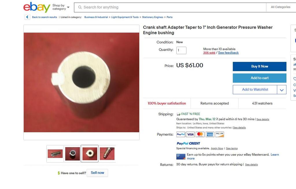

Achto 30,183 #6 Posted March 6, 2020 Looks like the two biggest hurdles have been covered. Tapper crank shaft & 1800 RPMs. Most Onan RV gen sets will be 1800 RPM, this was done to keep the noise level down. The RPMs can be changed though. @pfrederi showed the tapper to 1" adaptor, the same supplier also offers a tapper to 1 1/8" adaptor. I used the 1 1/8" adaptor when I install a Hatz engine in one of my tractors. Share this post Link to post Share on other sites
