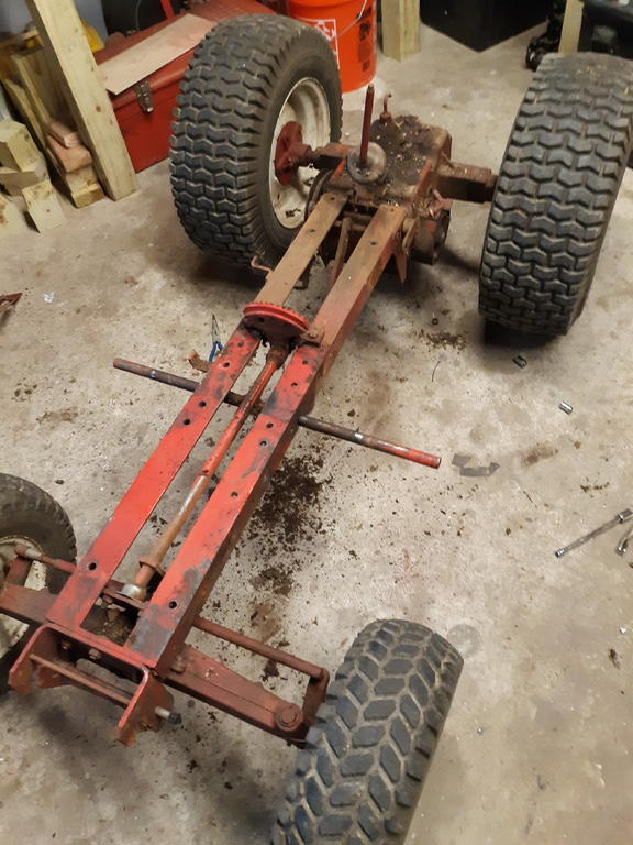

RetroMower 350 #1 Posted March 6, 2020 Finally getting around to making my C100 look as good as it runs. I used it all last year for mowing but it needed cosmetic assistance. I like the used patina and my B100 was in that perfect state where a little wet sanding was all it needed to spruce it up but my C100 must have set outside for a long time. All the sheetmetal was fairly rusty and rough. The large sheetmetal parts are at a sandblast shop right now as they wouldn't fit in my cabinet. My question right now is I want to clean and degrease the tranny for paint so should I go that extra mile and split the case? It works perfectly fine with no noise or leaks currently. I have questions about the shifter boot replacement and insight regarding the steering wheel being removed but this is already long winded. 1 Share this post Link to post Share on other sites
ebinmaine 81,048 #2 Posted March 6, 2020 If the transmission works okay there is no need to split the case. If you don't know the history of it and you want to check it out inside then now is obviously the best time to do it. The shifter boot can be had from Wheel Horse Parts And More. Definitely want to replace the seals right now as well. Also, check your wheel bearings. You don't want much up and down play. 2 Share this post Link to post Share on other sites
bottjernat1 2,197 #3 Posted March 6, 2020 I fully agree with ebinmaine. if its not broke dont mess with it! You can also get the boot from ebay or direct from toro. If you know someone who is a stens dealer they also carry the boot. The steering wheel just take it easy is the best advise i got. I have a special tool to pull steering wheels my late dad bought it from someone. It makes the job easy. It isnt like anything on the market. I will see if i can get u some photos. wished I knew where my dad had gotten it. Share this post Link to post Share on other sites
stevasaurus 23,861 #4 Posted March 6, 2020 I think I would drain the oil and see what it looks like, change the seals and if all the shafts are tight...go with it. 2 Share this post Link to post Share on other sites
WHX?? 58,325 #5 Posted March 6, 2020 On the steering wheel the worse part might be getting the roll pin out. Shop press will take care of the rest. 1 Share this post Link to post Share on other sites
RetroMower 350 #6 Posted March 6, 2020 The tranny fluid will definitely be changed. As far as splitting the case my concern was after nearly 50 years of even the gentlest of use the bearings may be functional but possibly very near the end of their lives. After seeing the carnage in my b100 hydro gearbox I feel compelled to inspect this one before a few rogue needle bearings wreak havoc. I'm just wondering how this 8 speed manual compares in difficulty to the automatic. The steering wheel looks equally challenging. I can see someone already tried to remove the roll pin as the one end is mushroomed pretty good. Somehow I'm more intimidated by it than taking the gearbox apart. I don't think I would have to try very hard to damage it during removal Share this post Link to post Share on other sites
ebinmaine 81,048 #7 Posted March 6, 2020 47 minutes ago, RetroMower said: Somehow I'm more intimidated by it than taking the gearbox apart Trina and I have not tackled a steering wheel yet. We have however taken apart several transmissions. All gear drives. They are not particularly complicated. Go to the head of the transmission section and watch Steve's videos for the appropriate one you have and you will be in great shape. 2 Share this post Link to post Share on other sites

953 nut 70,065 #11 Posted March 6, 2020 4 hours ago, RetroMower said: someone already tried to remove the roll pin as the one end is mushroomed pretty good. Somehow I'm more intimidated by it than taking the gearbox apart. I don't think I would have to try very hard to damage it during removal If you remove the hood stand with the steering shaft and heat the shaft red hot below the steering wheel then clamp it in a vise the pin can be driven out a lot easier. Share this post Link to post Share on other sites
WHX?? 58,325 #12 Posted March 7, 2020 Yah the last one I tackled was 'roomed out on one side but the right punch and a BFH I got lucky on the good side. 3 hours ago, ebinmaine said: have not tackled a steering wheel yet. So yer sayin EB you have not yet fulfilled the rites of passage to real () manhood?!?! If it makes you sleep better at nite Mower split the cases for inspection. It's not like you can't get parts should you need and we know guys who can help with problems. The the only issue might be the difficulty getting the hubs off. 1 1 Share this post Link to post Share on other sites
oliver2-44 11,791 #13 Posted March 7, 2020 Drain the transmission and let the oil be your gage. If it is dark black or brown, and the axles don't have much movement, don't split it. If it is milky gray or significant water or clumps come out, or the axles move more than a 32nd, split it. Wheelhorse Rites of Passage: Remove steering wheel roll pin and wheel Removing Transmission axle hubs Removing rust frozen rear hitch pin. 2 Share this post Link to post Share on other sites
RetroMower 350 #14 Posted March 7, 2020 (edited) 2 hours ago, oliver2-44 said: Drain the transmission and let the oil be your gage. If it is dark black or brown, and the axles don't have much movement, don't split it. If it is milky gray or significant water or clumps come out, or the axles move more than a 32nd, split it. Wheelhorse Rites of Passage: Remove steering wheel roll pin and wheel Removing Transmission axle hubs Removing rust frozen rear hitch pin. I like your reasoning and its probably my best bet getting the tinkerer in me to shut up and stop taking things unnecessarily too far. And your rites of passage checklist, I have two of the three completed. Hitch pin and hubs I've tackled already. If I complete the steering wheel trifecta do I have to perform some ritual to truly be one with my ? Edited March 7, 2020 by RetroMower 1 2 Share this post Link to post Share on other sites

peter lena 10,103 #20 Posted March 7, 2020 retromower , that steering wheel spiral pin , is best and easiest way is to use a size to size hole to drift pin , eliminate any " impact bounce " concentrating that force to pin impact , thoroughly soaked in penetrating oil, i have found the spiral pin to move on first impact with a 3 lb hammer. i lightly sand the hole bore and use never seize to re install. also use the opportunity of a free steering shaft , to mock up an added mounting point for a 2 or 4 bolt flange bearing . that will instantly stop your shaft play. done this a few times ,and it works , pete 1 Share this post Link to post Share on other sites
clueless 3,440 #21 Posted March 7, 2020 If you use the right size roll pin punch, it works better than the drift pin, the drift pin tends to flatten and widen the outer diameter of the roll pin making it harder to slide out. The last one I did was the easiest one I've done, soaked it with penetrating oil, In-Force by BG is what I use, every few days for about a week.Then chuck up the right size roll pin punch in my neighbor's hammer drill, (not an impact drill) hit it a few time wait awhile do it again. After a couple of hour of doing this every thirty minutes or so the pin slid right out. The hammer drill eliminates the the "impact bounce" that you get with a BFH . Share this post Link to post Share on other sites
peter lena 10,103 #22 Posted March 7, 2020 retro mower, while building up your dash/steering column tower its a good opportunity to tighten up your pto lever , the angular fit rod next to the bottom of your battery is especially sloppy , why i do not know, but if you go to your local h/w store and go to the small box slide out section , nylon washers fill in the gap ,i use silicone grease . the lever difference is very smooth and not sloppy . its a easy improvement while you are rebuilding this area anyway. i also added a heim joint to the same rod , removing the clevis point at the end, easy to die nut threads and screw on female / male joint . works so easy , its stupid . jmoo , pete Share this post Link to post Share on other sites
RetroMower 350 #23 Posted March 9, 2020 I defeated the roll pin in the steering wheel but lacking a press I'm going to have to machine a plate for my puller for the actual removal of bvb the wheel. I'll post pics if it works Share this post Link to post Share on other sites
WHX?? 58,325 #24 Posted March 9, 2020 You can probably use a regular bearing separator and puller you have such Retro. Other wise if you don't and don't have the need for the tools in the future a 12 pak might get it done for someone who has a press. Your talkin machine so sounds like you got a handle on things. Good to hear on just getting the pin out... half the battle won right ther! Share this post Link to post Share on other sites
