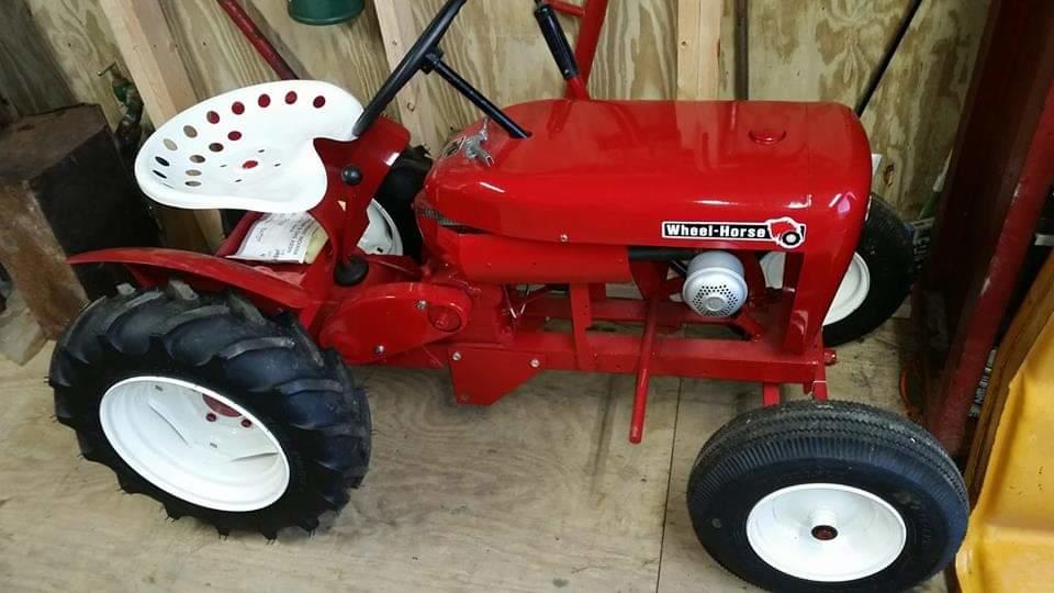

Bigtrx34 321 #5 Posted March 4, 2020 2 minutes ago, ebinmaine said: Note the words I highlighted above. Now note the fact that Trina is known as my paint department. She has a level of patience and talent that I admittedly do not possess. She has practiced and learned to come up with a nice even surface and color. She has a FAR preferred paint brand in Rust-Oleum 2X. I point that out because it's important to remember that everybody has a different style and you may want to try two or three brands to see if one works better for your style of spraying. Definitely agree that a hardener in the paint would be ideal. We don't worry about that because we only spray working equipment. @Mudrig150 the hardener thing reminds me. Make sure you give that paint plenty of time to cure. Like weeks.... I agree with you for sure. I use a combo of spray cans and self mixed and gun applied. Magic is my brand of choice but I am by no means a body tech! The point about dry times can not be understated even at very low humidity with about 80 deg Fahrenheit in my shop I tend to leve parts hanging for 5 days or more. I do not have the ability to make a spray can work well on a large hood or fender, 80% looks great 20% looks like the cat vomited on it.......just me I suppose. 1 Share this post Link to post Share on other sites

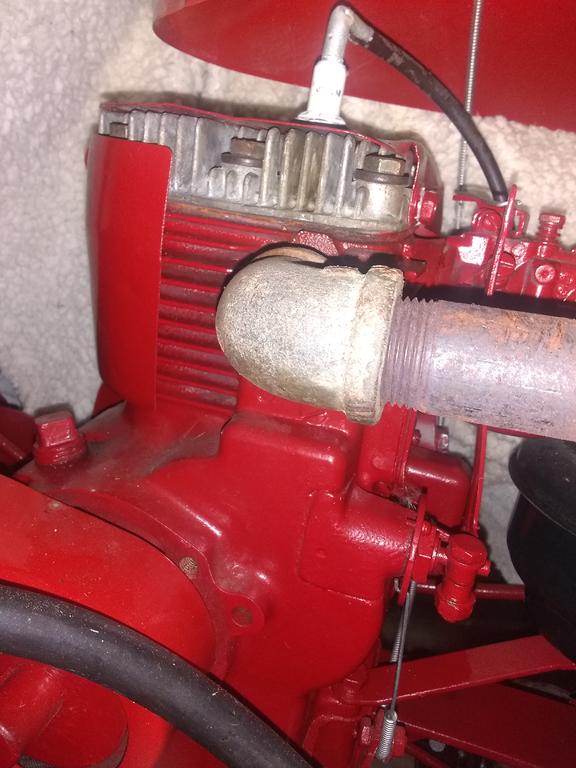

bottjernat1 2,197 #16 Posted March 5, 2020 On my wheelhorse i redid I had a local body shop do most of the tractor but i did the rear end and the motor. I used oven cleaner on the flywheel covers and other tins. Used a wire brush then took the parts and washed them. I put if i remember right 2 coats of primer 3 coats of paint and 2 or 3 coats of clear coat. I used rattle cans. I think i did a fantastic job. at least everyone tells me that. LOL I finished it in 2015. 1 1 Share this post Link to post Share on other sites

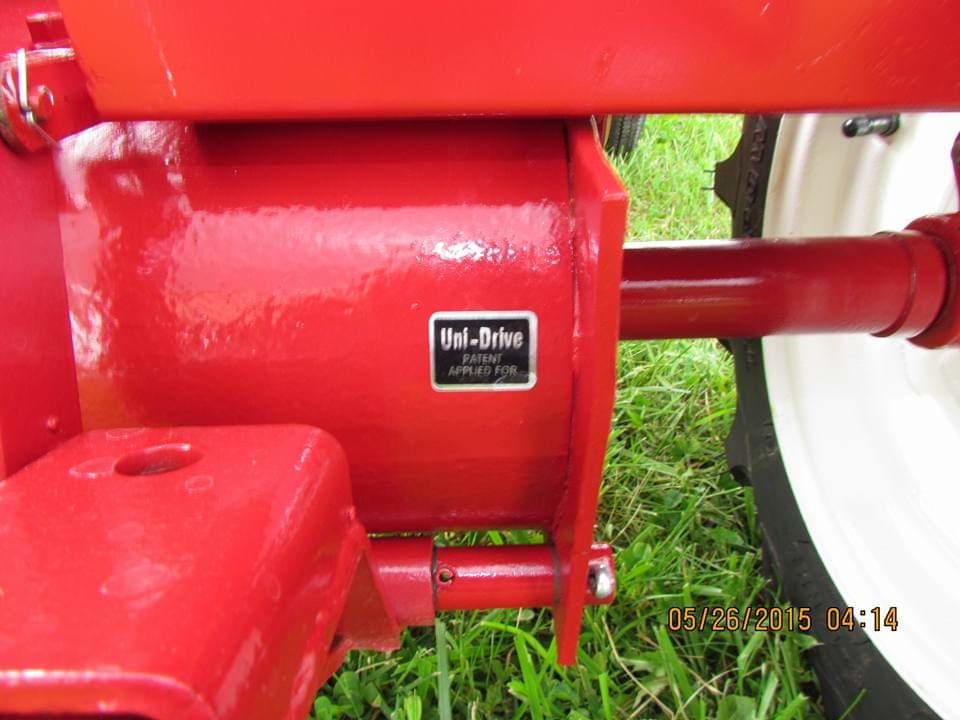

oilwell1415 563 #17 Posted March 5, 2020 Quality rattle can paint today is leaps and bounds ahead of what it was not all that long ago. It will never be as good as professional quality automotive paint, but you can do a really good job with it if you take your time. Just make sure you use a quality product and not the cheapest thing on the shelf at the dollar store. I'll give a second vote to the Rustoleum 2X mentioned above. 2 Share this post Link to post Share on other sites

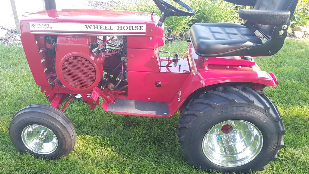

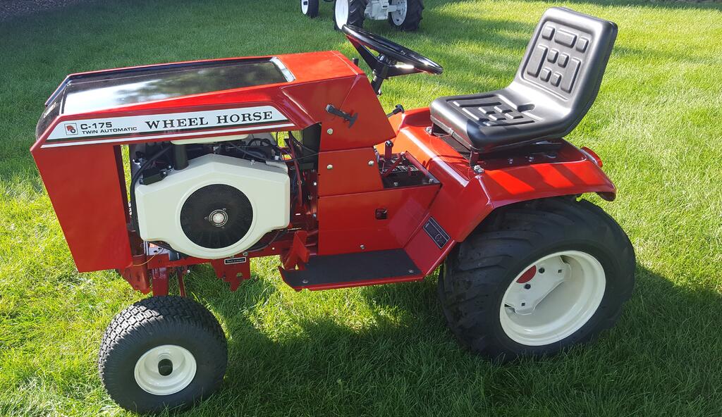

Gregor 4,848 #24 Posted August 18, 2021 On 3/4/2020 at 2:25 PM, Mudrig150 said: Clean up the metal Wipe it down good with a paper towel Prime Fill in rust pitting with body filler Sand Paint, let dry Clear coat You seem to have a way of simplifying a very involved task. All my tractors are painted with rattle cans, with the exception of one. There is no denying it is a better looking paint job, but for what it cost, it should be. 1. For me, media blasting the tin work, is a must. You can't beat it 2. Paper towels will leave microscopic bits, you may not see them on the metal, but they will show up in the paint. A tack rag is hard to beat. 3. A good quality primer, ON EVERYTHING is a must, if you want the color to be uniform. 4. See #1. Get rid of ALL rust first. 5. Some rattle cans, and clear coats, don't always want the paint to be HARD dry, before applying additional coats. Read instructions on your can. I would add; Weather conditions. Temperature is important, but so is humidity. Humidity above 60% can ruin an otherwise great paint job. Lighting. To get a good finish, not striped looking, you have to maintain a "wet" look, throughout the entire piece. Sometimes its hard to see. Proper lighting is important. If you can't see it, you can't paint it. Lots of paint Don't try to spray too much at once, but use plenty of primer, color, and clear coat. I will typically use 10 - 15 cans of paint on a tractor. Drying After the last coat, I give everything 2 - 3 days of dry time. Don't rush it. 1 Share this post Link to post Share on other sites
