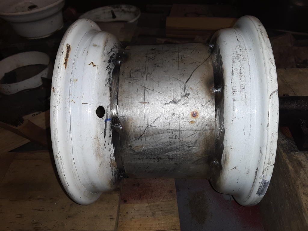

Oldskool 6,678 #108 Posted March 14, 2020 Well slow going. Apparently the wife had other plans. Who knew we had to go to the in-laws today. Not me hahaha. So anyhow this is the progress 4 Share this post Link to post Share on other sites
Pullstart 70,712 #109 Posted March 14, 2020 Did you roll that center section, or do you have some big tubing laying around? 1 Share this post Link to post Share on other sites
Oldskool 6,678 #110 Posted March 14, 2020 3 minutes ago, pullstart said: Did you roll that center section, or do you have some big tubing laying around? Its 6-1/2"dia. 3/16 wall pipe 2 Share this post Link to post Share on other sites

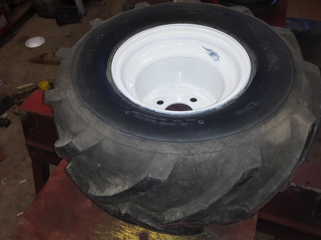

Oldskool 6,678 #115 Posted March 15, 2020 One done. The other tomorrow after work. Then to scrounge up some rear tires. 3 1 Share this post Link to post Share on other sites

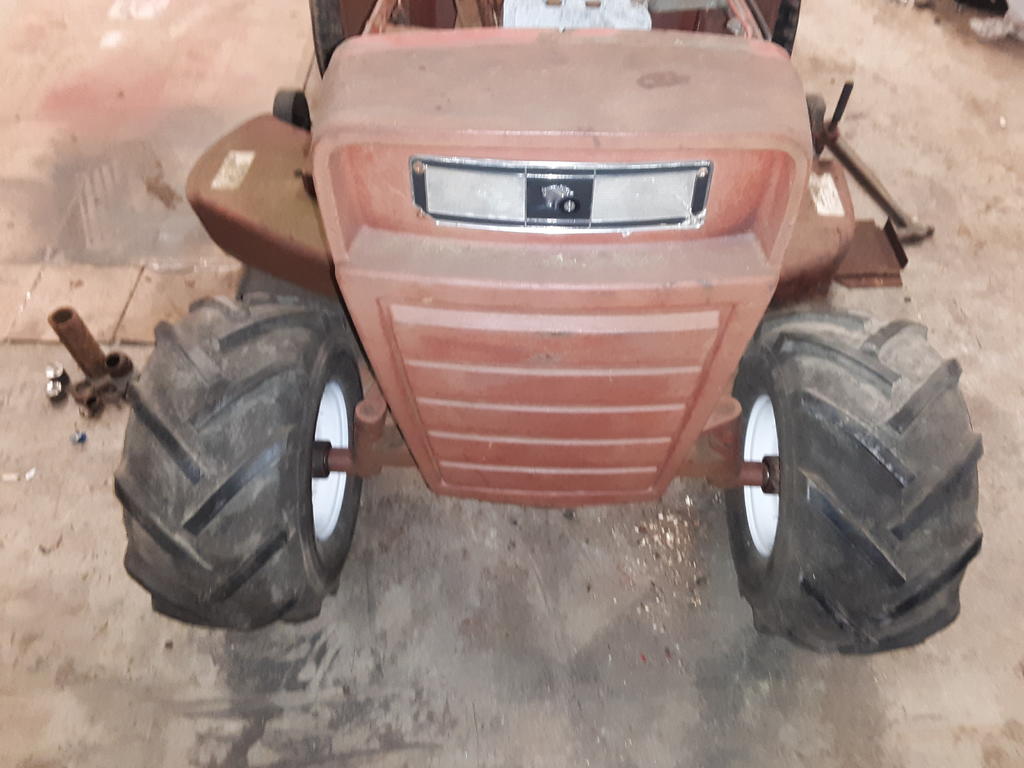

Oldskool 6,678 #124 Posted March 17, 2020 The front end is looking better. Still scrounging for rear tires 2 Share this post Link to post Share on other sites
