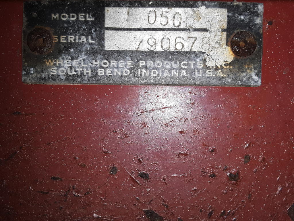

Oldskool 6,678 #52 Posted March 7, 2020 Here is the GT tag. How old is the old boy. Share this post Link to post Share on other sites
Sparky-(Admin) 25,463 #54 Posted March 7, 2020 1-0500 1971 Lawn & Garden Tractor GT-14 Automatic Kohler K321S-60125B 14 Sundstrand 90-2062 1 Share this post Link to post Share on other sites

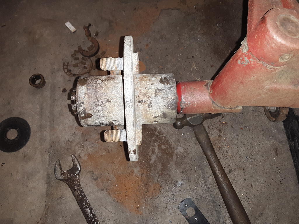

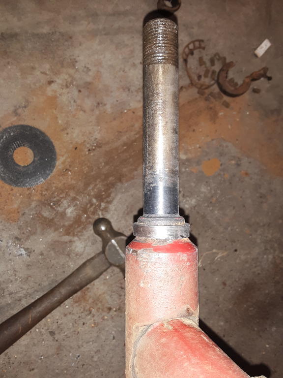

Oldskool 6,678 #58 Posted March 7, 2020 So one side is almost done. Fist pic is a spacer for the seal to ride on. 1/4 x 1"ID x 1-1/8"OD. Second pic axle bushing 3-3/8"L x 3/4"ID x 1"OD. I am still going to make the rims I want to get optimum offset. 4 Share this post Link to post Share on other sites
19richie66 17,889 #59 Posted March 7, 2020 (edited) Nice! A lot easier to get the wheels on/off this way. Edited March 7, 2020 by 19richie66 1 Share this post Link to post Share on other sites
Oldskool 6,678 #60 Posted March 7, 2020 1 hour ago, 19richie66 said: Nice! A lot easier to get the wheels on/off this way. You you aren't justa kidding. I'm still trying to get the other front wheel off. Rusted in place pretty well. 1 Share this post Link to post Share on other sites

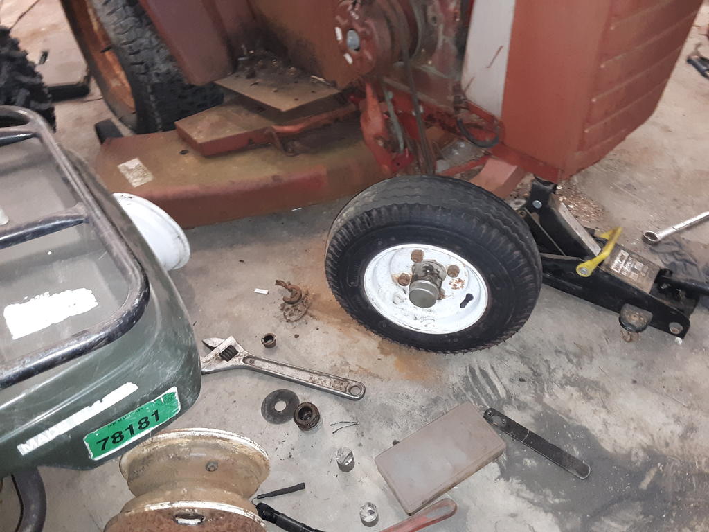

Oldskool 6,678 #61 Posted March 8, 2020 Finally got the other wheel off. So this morning the old boy has new temporary shoes. Getting closer to being a roller 5 1 Share this post Link to post Share on other sites

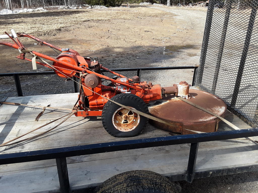

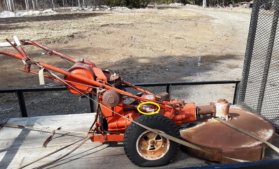

Oldskool 6,678 #64 Posted March 8, 2020 On 3/7/2020 at 2:31 PM, pullstart said: That guy roll over? So I wraped a cord around the gravely today. Seems as thou it has compression but no spark 1 Share this post Link to post Share on other sites
Pullstart 70,041 #65 Posted March 8, 2020 42 minutes ago, Oldskool said: So I wraped a cord around the gravely today. Seems as thou it has compression but no spark Is that a points ignition, or magneto/something behind the flywheel? Share this post Link to post Share on other sites
Oldskool 6,678 #66 Posted March 8, 2020 4 minutes ago, pullstart said: Is that a points ignition, or magneto/something behind the flywheel? Not really sure other than it is shaft drive in front of the engine Share this post Link to post Share on other sites
gwest_ca-(File Mod) 12,263 #67 Posted March 8, 2020 Shaft driven magneto. Most common a Wico. Remove the cover and clean the point contacts with a file. Looks like an insulated screw coming out the right side of the housing for grounding the ignition to shut the ignition off. If there is a wire going to the screw remove the wire from the screw. That wire is often shorted inside the handle bar or the switch has failed in the end of the handle bar. Garry 3 Share this post Link to post Share on other sites
Oldskool 6,678 #68 Posted March 8, 2020 21 minutes ago, gwest_ca said: Shaft driven magneto. Most common a Wico. Remove the cover and clean the point contacts with a file. Looks like an insulated screw coming out the right side of the housing for grounding the ignition to shut the ignition off. If there is a wire going to the screw remove the wire from the screw. That wire is often shorted inside the handle bar or the switch has failed in the end of the handle bar. Garry It is a Wico. The wire coming from the screw is disconnected from the handle bar already. I was wondering what it was connected to origanally. I will file the points and see what happens. Thanks for the info Share this post Link to post Share on other sites
Oldskool 6,678 #69 Posted March 8, 2020 @gwest_ca filed the points, double checked the spark plug. Still no fire. I guess I will have to mess with it another day. Unless somebody else wants to own it Share this post Link to post Share on other sites
