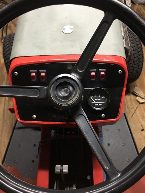

953 nut 66,412 #328 Posted July 19, 2020 On 7/15/2020 at 9:21 PM, Oldskool said: Tell me the steering wheel comes off easy Not as bad as most models. You need to remove a bolt and washer that retain the steering wheel and then use a bearing splitter and puller to remove the wheel without damaging the plastic. Share this post Link to post Share on other sites
Oldskool 6,678 #329 Posted July 19, 2020 3 hours ago, 953 nut said: Not as bad as most models. You need to remove a bolt and washer that retain the steering wheel and then use a bearing splitter and puller to remove the wheel without damaging the plastic. Dang the one thing I dont have yet is a bearing splitter. I've wanted one. I guess it's a good excuse to get one lol 1 Share this post Link to post Share on other sites

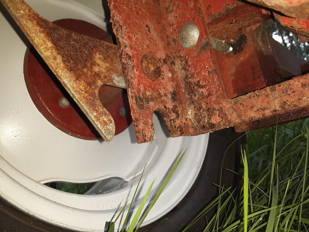

Oldskool 6,678 #332 Posted July 19, 2020 I assume this is where the dozer blade would mount? 3 Share this post Link to post Share on other sites
ebinmaine 79,069 #333 Posted July 19, 2020 4 minutes ago, Oldskool said: I assume this is where the dozer blade would mount? Yessir 1 Share this post Link to post Share on other sites
Oldskool 6,678 #334 Posted July 19, 2020 Just now, ebinmaine said: Yessir Thank ya much. Next project lol Share this post Link to post Share on other sites
ebinmaine 79,069 #335 Posted July 19, 2020 If you need measurements lemme know. We have 2 plow set ups here. 1 Share this post Link to post Share on other sites
Oldskool 6,678 #336 Posted July 19, 2020 50 minutes ago, ebinmaine said: If you need measurements lemme know. We have 2 plow set ups here. Would they be the same for the GT? Share this post Link to post Share on other sites
ebinmaine 79,069 #337 Posted July 20, 2020 8 minutes ago, Oldskool said: Would they be the same for the GT? That I don't know.... One of the others could help there.. 1 Share this post Link to post Share on other sites
