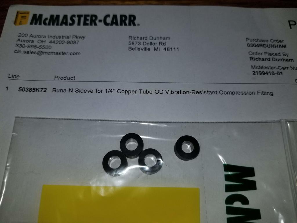

bellevillerod 836 #29 Posted March 6, 2020 Well this is nice, I had the fuel line from the pump to carb leaking bad when I first put gas in it. So I went to the auto parts stores around me looking for the seals. Nobody had them and didn't even know what I was looking for...lol. These new kid's have no clue if the computer doesn't tell them. So yesterday before going to work I placed an order. Today they are here, I like McMaster-Carr. 2 Share this post Link to post Share on other sites
WHX?? 56,794 #30 Posted March 7, 2020 Just ordered a butt load of those off fleabay Rod. You need a postage stamp will get you a dozen. They are dirt cheap for a quantity so made some other friends too... they are the same seals as used on Harley shovel head oil lines. Another redneck alternative is to use some close to same size windshield wiper wash tubing and use a razor knife to cut to length 1 1 Share this post Link to post Share on other sites
bellevillerod 836 #31 Posted March 7, 2020 Well I guess I have the most expensive seals of any knucklehead around...lol. I have 20.00 tied up in those 4....... 1 Share this post Link to post Share on other sites

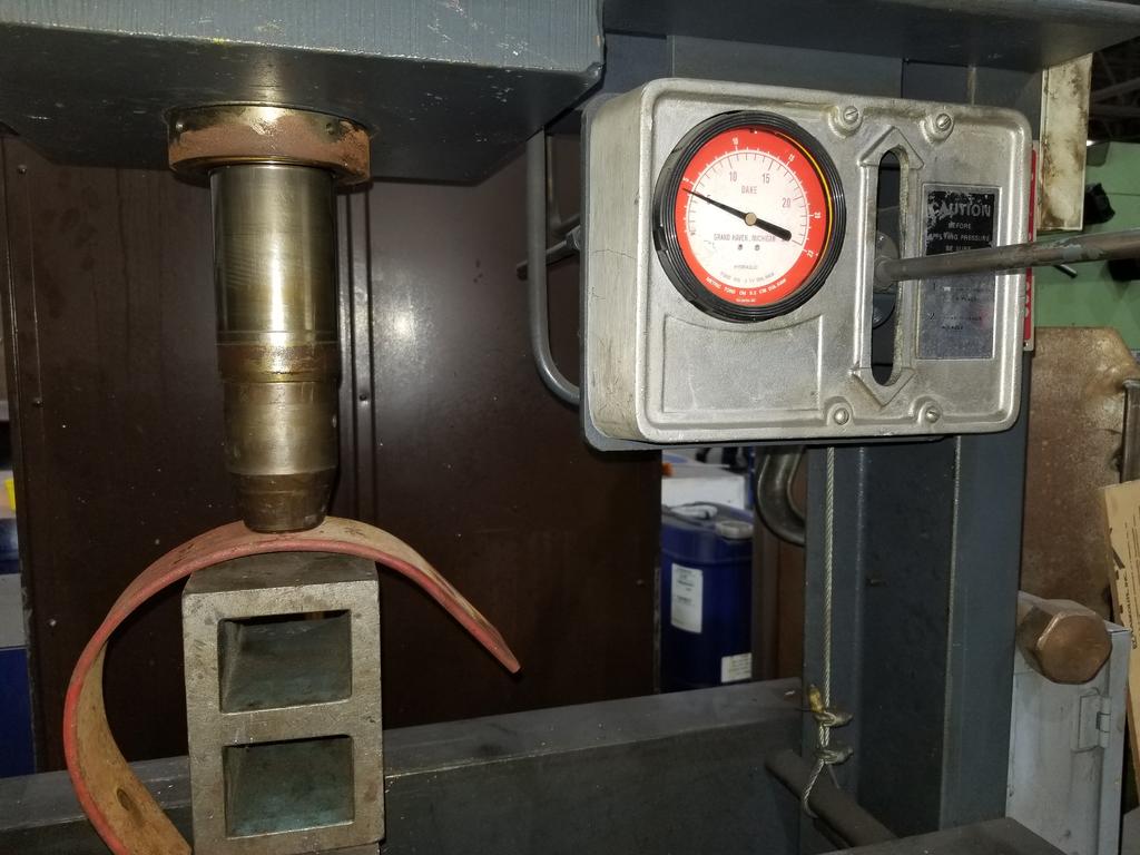

bellevillerod 836 #32 Posted March 8, 2020 Went to try an open up the seat support because it was looking tired and beat down. Plus I'm fabricating up a seat back. That seat spring is tough stuff. I've got 5 ton of force on it and it's holding shape. I had to hit it with almost 6 to get it to move. 2 1 Share this post Link to post Share on other sites

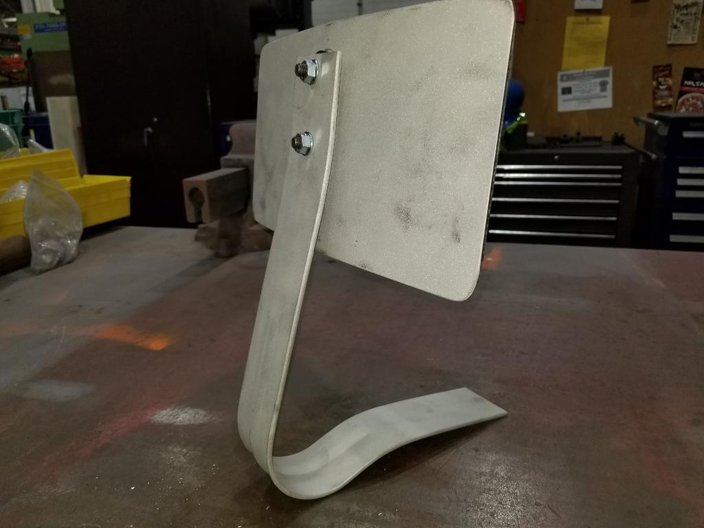

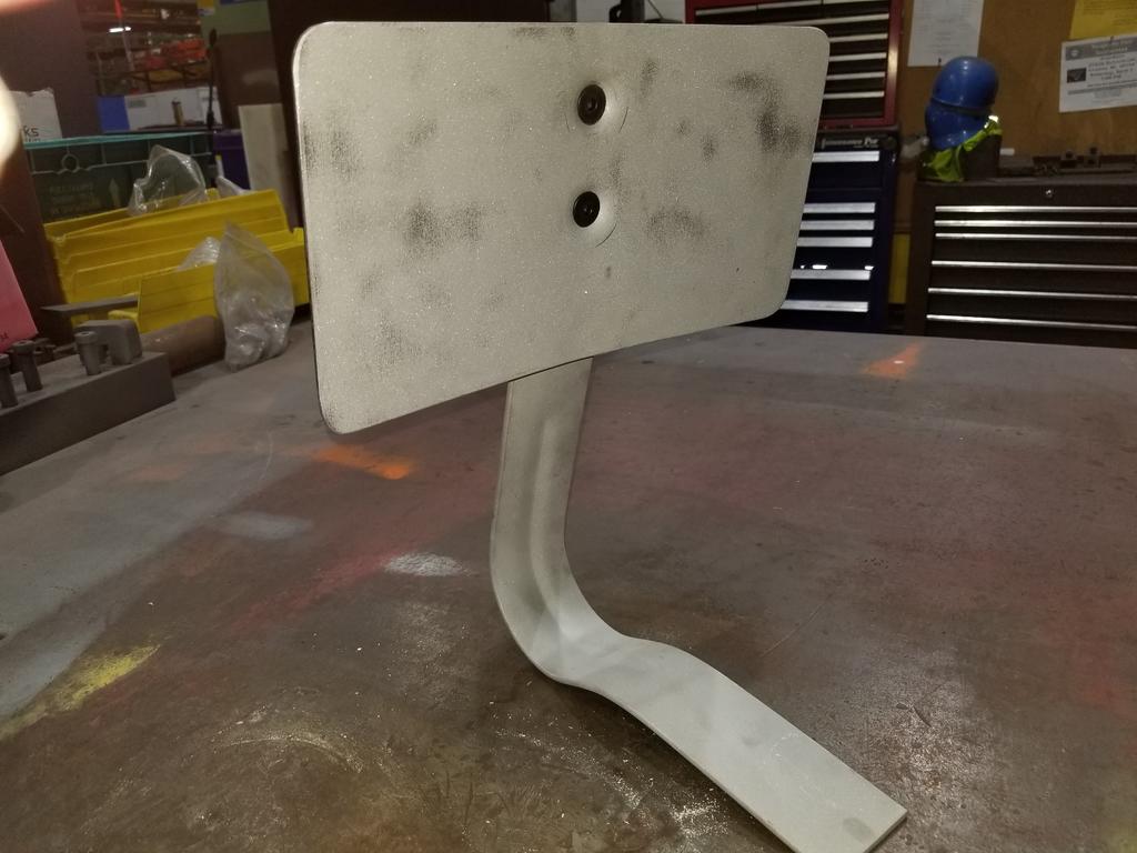

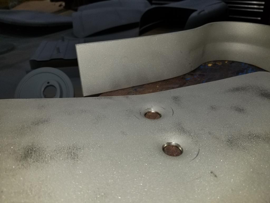

bellevillerod 836 #33 Posted March 11, 2020 Tractor did not have a seat back on it. I like the look of it on those older tractors. I found a piece of spring steel an decided to try and make one up. I put a fuller in the middle to help it flex without taking a bend. I cut a back out of 14 gauge .125 thick steel. Drilled an dimpled the bolt holes. Any suggestions from those that have been there done that? Here are a couple of pic of the progress so far. 1 2 Share this post Link to post Share on other sites
dells68 7,499 #34 Posted March 11, 2020 That looks really nice!!! Might be a market for them if you get really into making them. 2 Share this post Link to post Share on other sites
ebinmaine 79,077 #35 Posted March 12, 2020 1 hour ago, dells68 said: That looks really nice!!! Might be a market for them if you get really into making them. I'd second that. I could use an extra wide upper piece.... 1 1 Share this post Link to post Share on other sites

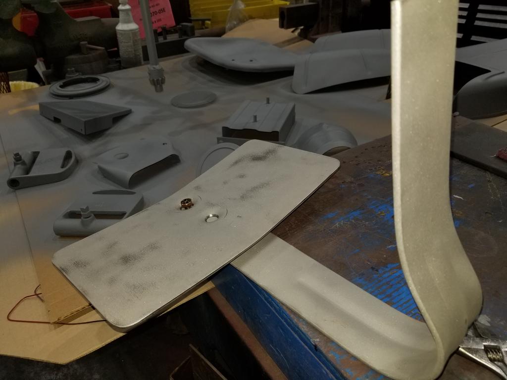

bellevillerod 836 #36 Posted March 12, 2020 The seat back is 13 x 7 I didn't know what size they were originally. I wanted something that would be easier on the old back. Still have more work to do on it but coming along nice. I dimpled it deep enough for carriage bolts. Think they look better on the tractor. A couple more pics for you. 3 Share this post Link to post Share on other sites

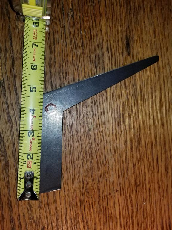

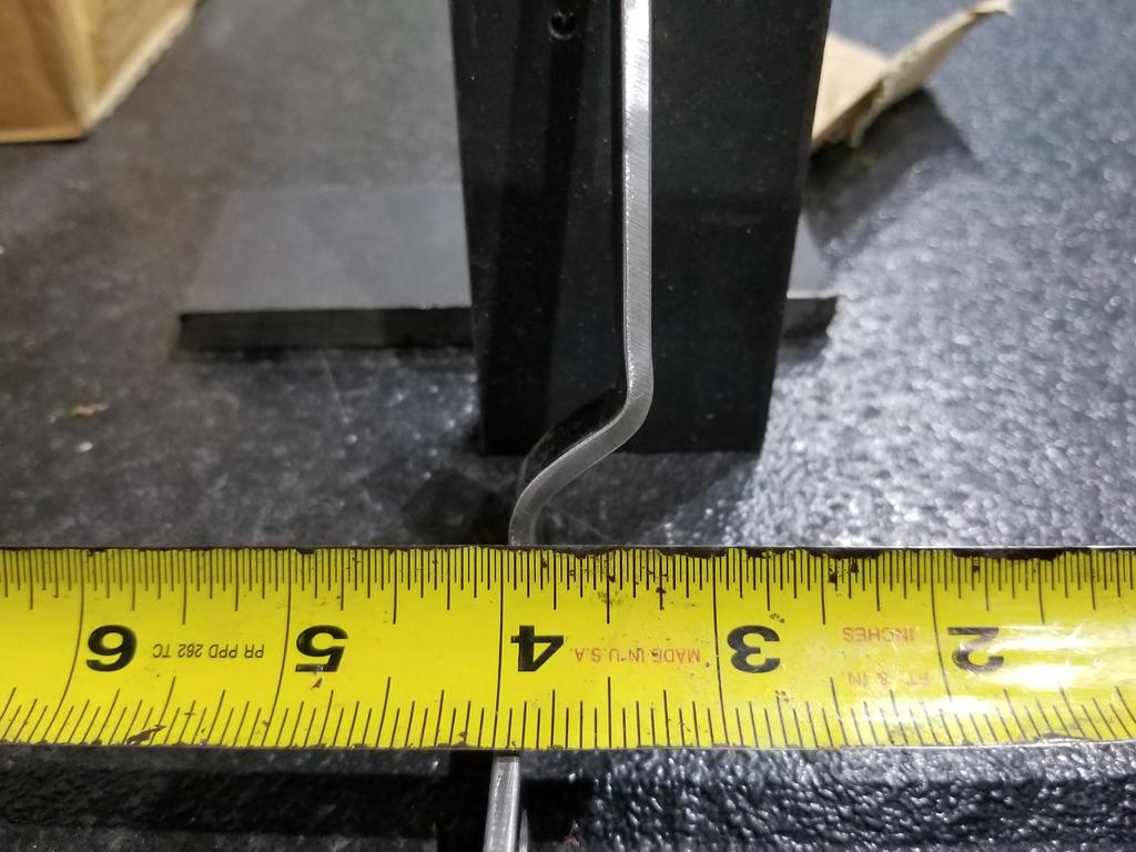

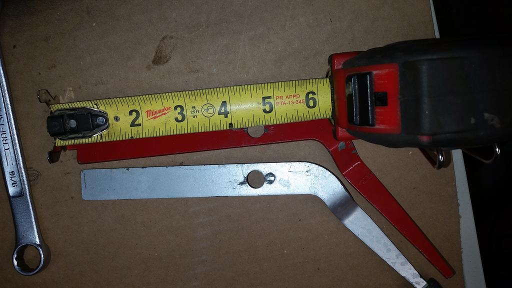

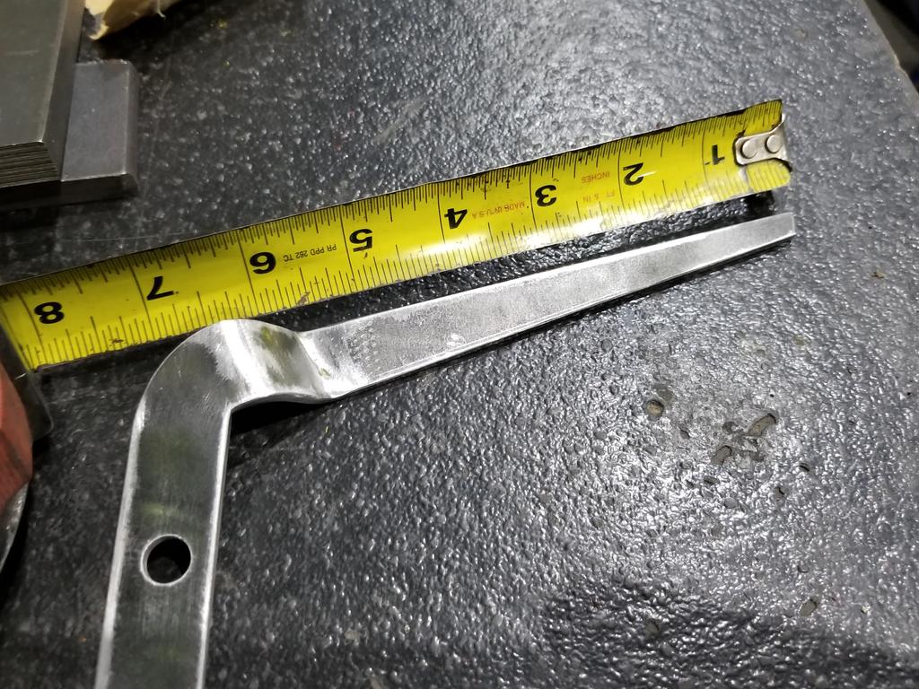

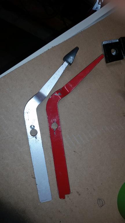

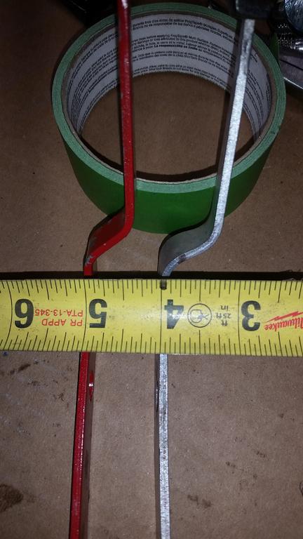

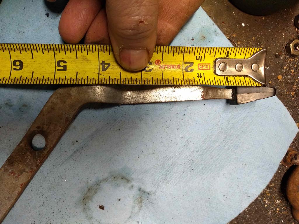

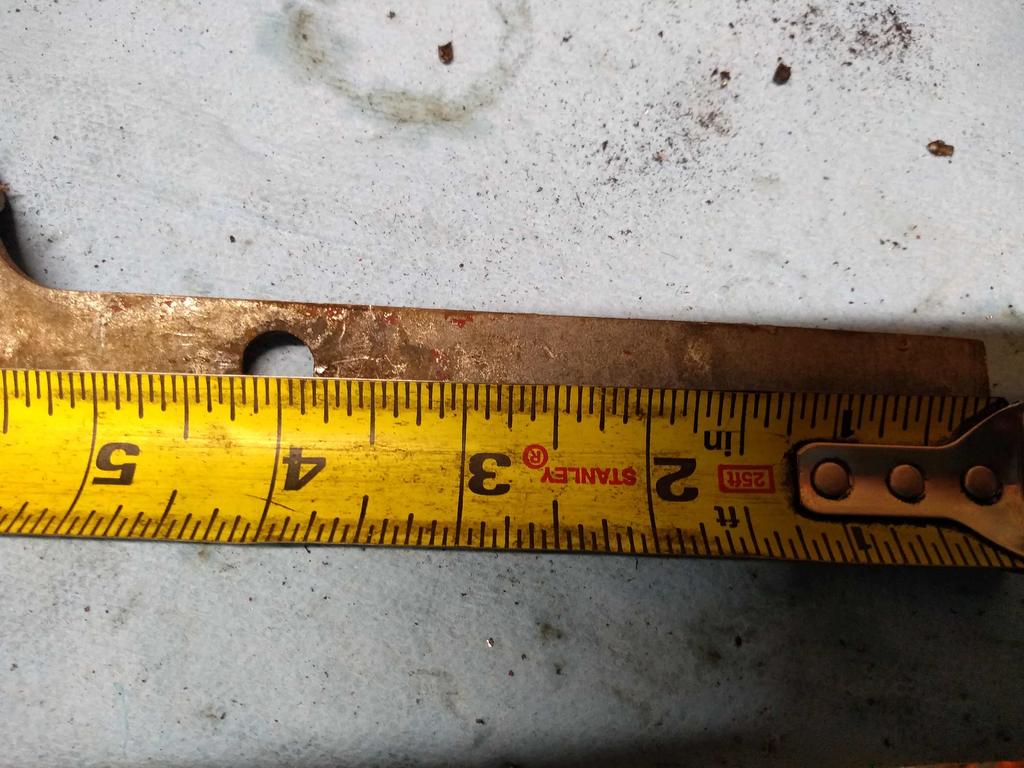

Achto 31,886 #46 Posted March 13, 2020 @bellevillerod Hopefully these pics will help you out with the parking brake. This is from my 753, for some reason the tang/step on the bottom is either missing or the 753 didn't have one I made one out of card board first to make sure that I had the right shape when I made the one that I needed. 2 Share this post Link to post Share on other sites
bellevillerod 836 #47 Posted March 13, 2020 Thank you for that, it's real close to the steel I cut to try and figure out the shape. So with what you posted for me I just might get there. 1 2 Share this post Link to post Share on other sites

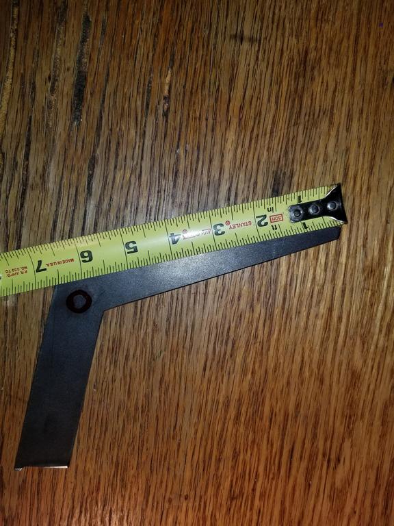

WHX?? 56,794 #48 Posted March 13, 2020 Some other ones here Rod. Some had a notch where it engages the brake band some did not. Later sixties ones were step notched for different levels of pedal push and adjustment. I do have a 854 buried in the parts shed if you want to see what an orginal looks like. 2 1 Share this post Link to post Share on other sites
bellevillerod 836 #49 Posted March 13, 2020 Thank you @WHX24 with the great pic's, I see that a new piece of steel will need to be cut. This tractor is starting to be a real fun project. I think that it was rolled off a truck at some point. The steering wheel had a good bend in it and the gas tank looked crooked from the front. What I first thought was just a dented front hood seems to be more. The center gas tank support looks like something real heavy dropped on it. Most metal work I have ever had to do to one of these. Call me crazy but I really enjoy the journey. I've cut, straightened an re welded quite a bit so far. 1 2 Share this post Link to post Share on other sites

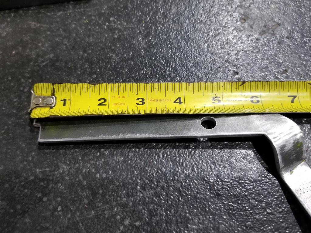

bellevillerod 836 #50 Posted March 15, 2020 Thx guys think I got one made up that will work may need to tweak it a little.... 2 Share this post Link to post Share on other sites
