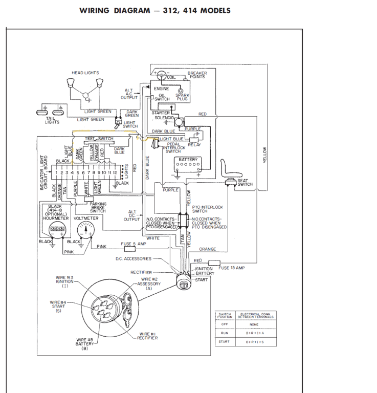

Tgalo 128 #1 Posted March 3, 2020 Hi again folks, this wire marked light blue in the diagram, #4 over from the left of the circuit board, is white on my tractor. Im assuming its faded and is the last wire I need to route. Looks like it goes to the interlock switch? Share this post Link to post Share on other sites
gwest_ca-(File Mod) 12,489 #2 Posted March 3, 2020 It may be easier to connect it at or near the relay. The switch is not easy to get to. Garry Share this post Link to post Share on other sites
