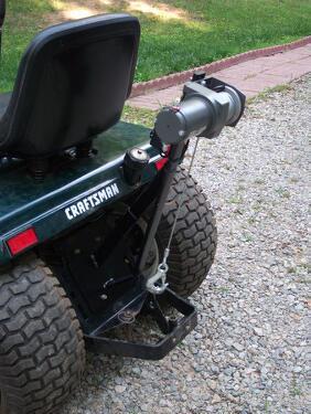

Daron1965 644 #6 Posted March 2, 2020 (edited) Ingore the tractor. Found a quick pic. Edited March 2, 2020 by Daron1965 2 Share this post Link to post Share on other sites
Stormin 9,987 #7 Posted March 2, 2020 That's a neat little winch. Smaller than what I had in mind. I'll have to see if I can get something similar over here. Share this post Link to post Share on other sites
