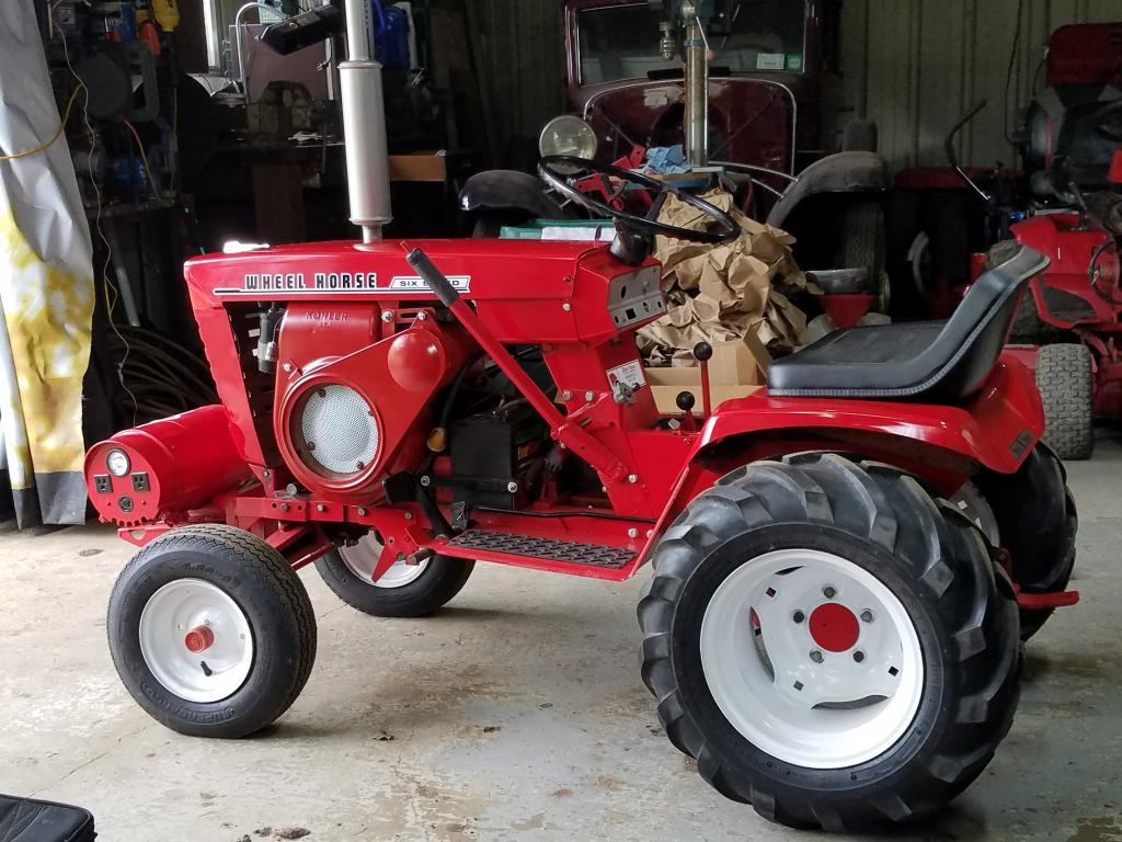

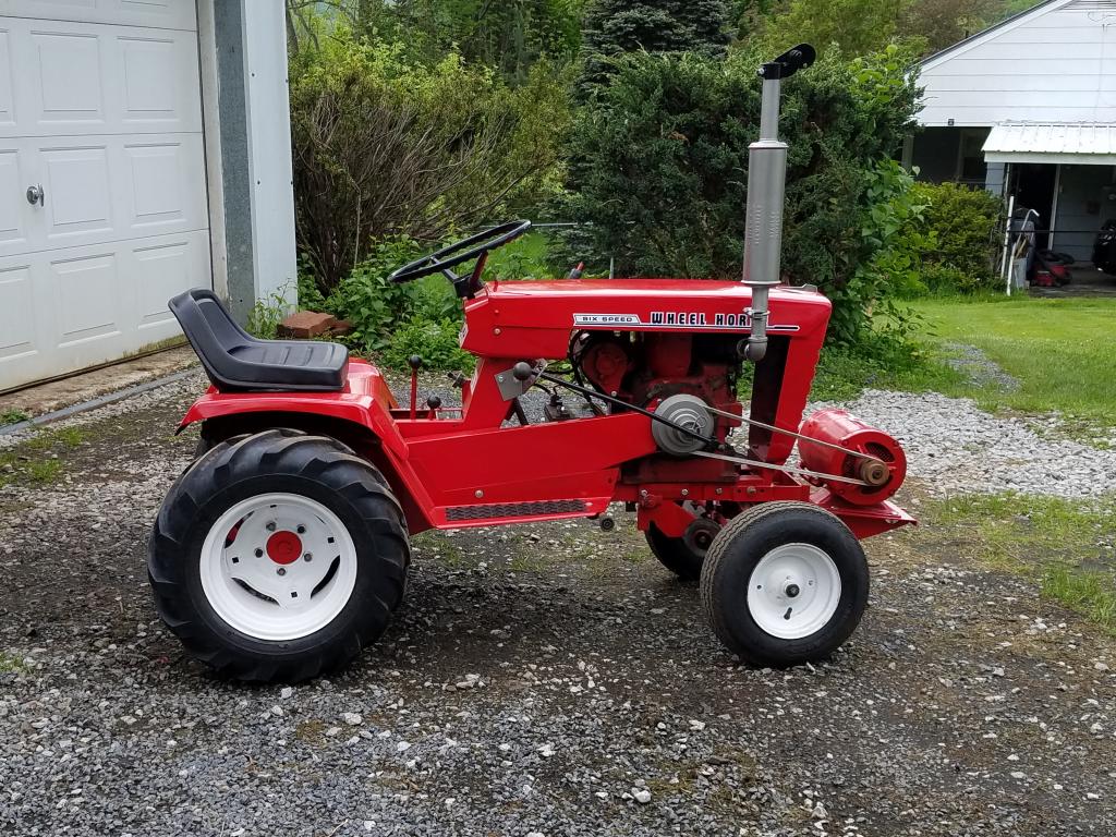

David Ullman 142 #1 Posted February 28, 2020 This is my first Rustoleum paint job, I was using auto paint but its gotten why to pricey. I read where you can use rustoleum thinned out, seems to work but takes longer to dry but the results aren't bad. 5 8 1 3 Share this post Link to post Share on other sites
ebinmaine 80,302 #2 Posted February 28, 2020 Looks fantastic! My "paint department" ... (Trina) MUCH prefers to use Rust-Oleum 2x Brand. Lays out nice... 1 1 Share this post Link to post Share on other sites
SPINJIM 1,997 #3 Posted February 28, 2020 Rustoleum definitely drys slowly, and take even longer to cure. Treat it gently for about 6 months to let it harden. Nice job on your tractor. Jim Share this post Link to post Share on other sites
WHX?? 57,808 #4 Posted February 28, 2020 Holy crap Dave that is one fine lookin tractor! Where you been all our life!?!? You are correct on the Rustoleum products and sadly way too correct on the $$ of auto grade finishes. I have done a couple of restos with Regal red out of a rattle can with good results... not trailer queens but dang good workers.. Is that by chance a 12 or 1067 with floor boards?? Raider??? Sure is a beaut! Where are your manners EB?? 1 1 Share this post Link to post Share on other sites

Ed Kennell 46,992 #12 Posted February 28, 2020 to the David. Very nice work on the tractor....any before pics. I don't often paint, but when I do, it's always Regal Red. What is that gem behind the WH ? '30 Dodge? 2 1 Share this post Link to post Share on other sites
ZXT 2,402 #13 Posted February 28, 2020 (edited) 21 minutes ago, Ed Kennell said: What is that gem behind the WH ? '30 Dodge? How did I miss that in the background? I never do that! My guess is Oldsmobile, but I'm probably wrong. That was the only thing I could think of off the top of my head with twin headlight cross bars.. Edited February 28, 2020 by ZXT 1 Share this post Link to post Share on other sites
oliver2-44 11,694 #14 Posted February 28, 2020 if your using a spray gun, you can use Valspar enamel hardener with Rustoleum Regal Red. It will dry faster, harder and I think with a little more gloss. Just be sure to use a quality respirator when you use the hardener 2 Share this post Link to post Share on other sites
David Ullman 142 #15 Posted February 28, 2020 The car is a 32 Chevy 2 door sedan classic. 1 1 1 Share this post Link to post Share on other sites
