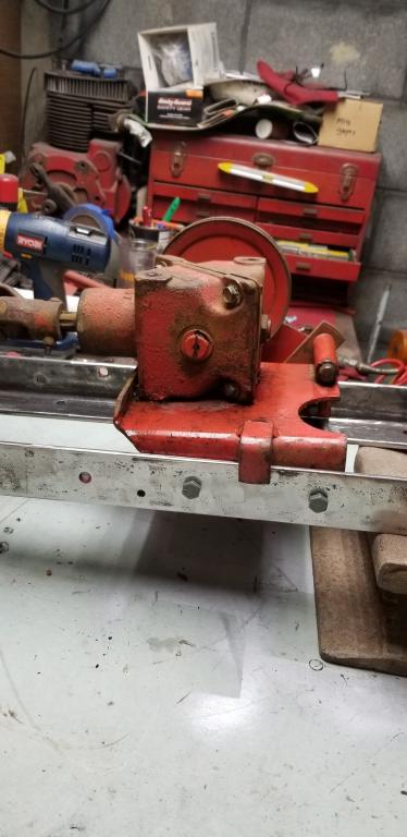

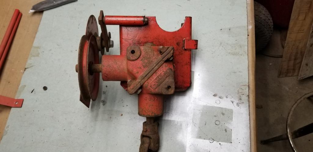

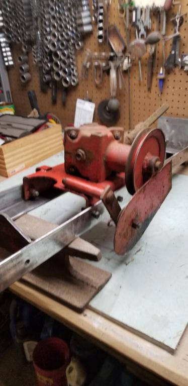

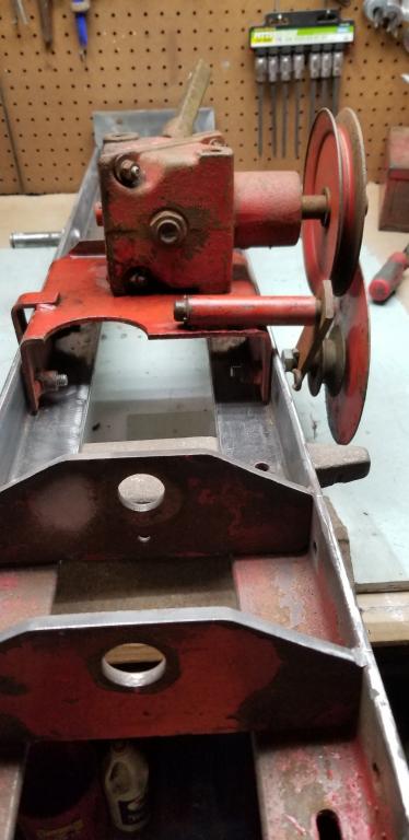

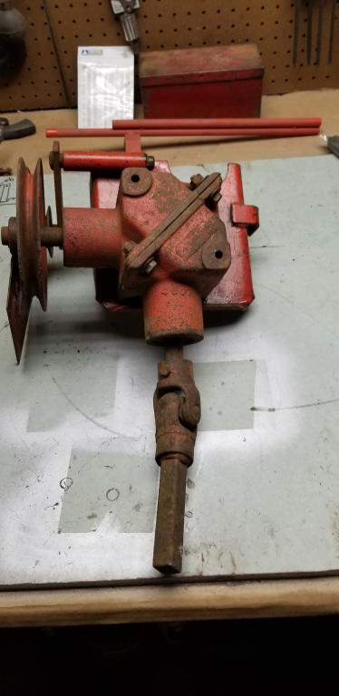

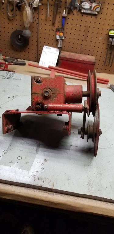

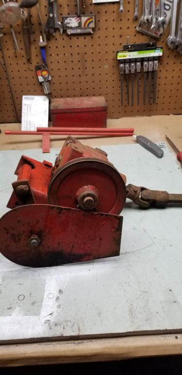

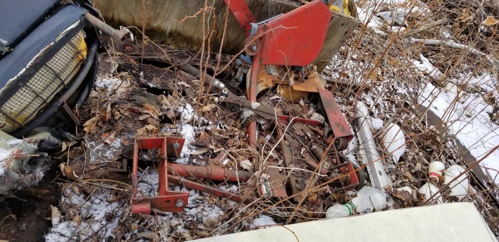

gt14rider 1,283 #1 Posted February 27, 2020 Hi all, can someone please help find a good printable manual for a haban 414 for GT14. The one in manual section on RS I can't figure out how to print it. It only wants to print one page at a time. Any help would be appreciated. I got the haban when I got the tractor but thought I was missing the 90 degree gearbox. Digging through some boxes and found it. Did anybody ever get one mounted up and running. Here's a couple pictures, holes line up on frame. Great something else to go through 1 Share this post Link to post Share on other sites

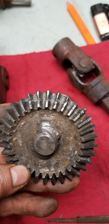

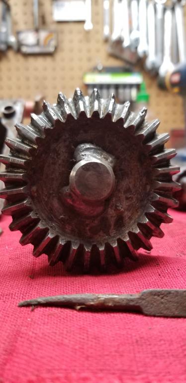

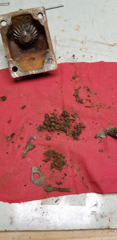

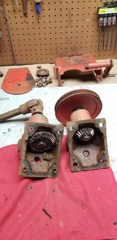

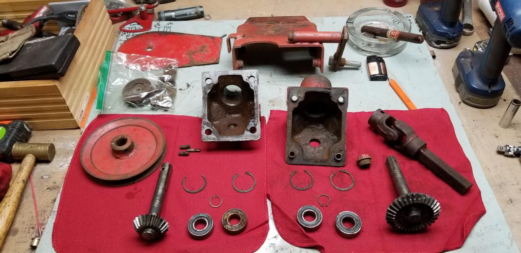

gt14rider 1,283 #4 Posted February 29, 2020 (edited) Well got the gear box apart, it was a little dry and stuck. The chunks of crud is all that's left of the lube and rust. Will replace bearings and snap rings, the output shaft gear has got a few teeth buggerd up, I'll put some saw dust in the crankcase to quit it down. Came apart fairly easy. Got it soaking in evaporust, that stuff works great Edited February 29, 2020 by gt14rider 1 Share this post Link to post Share on other sites
