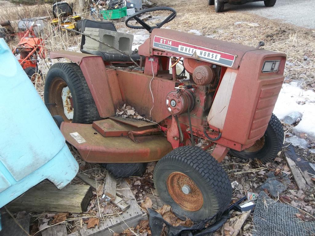

Oldskool 6,678 #102 Posted February 29, 2020 Here is the last pic Share this post Link to post Share on other sites
Oldskool 6,678 #103 Posted February 29, 2020 17 minutes ago, pfrederi said: Breakerless ignition People who messed with them frequently screwed them up. You can replace it or convert points battery.... I may need help with that Share this post Link to post Share on other sites
ebinmaine 81,150 #104 Posted February 29, 2020 1 minute ago, Oldskool said: I may need help with that It's pretty easy from what I've researched. I even have the parts here... 1 Share this post Link to post Share on other sites
ebinmaine 81,150 #105 Posted February 29, 2020 9 minutes ago, Oldskool said: Here is the last pic Yeah that carb is likely what's missing. The air cleaner housing should be vertical on that tractor. Easy enough to replace. Share this post Link to post Share on other sites

Pullstart 71,521 #107 Posted February 29, 2020 Looks like a killer deal for $200! That electric PTO is worth at least half of that if it works! As Richard said, the automatics are well sealed from the elements, that’s not a worry. The engine if sitting with pout a carb... well that might have a bit of moisture in it. 1 Share this post Link to post Share on other sites
Oldskool 6,678 #108 Posted February 29, 2020 5 minutes ago, pullstart said: Looks like a killer deal for $200! That electric PTO is worth at least half of that if it works! As Richard said, the automatics are well sealed from the elements, that’s not a worry. The engine if sitting with pout a carb... well that might have a bit of moisture in it. If the engine is a loss i would guess it would be some what easy to repower. 1 Share this post Link to post Share on other sites

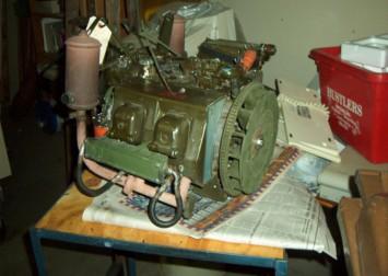

ebinmaine 81,150 #109 Posted February 29, 2020 1 minute ago, Oldskool said: If the engine is a loss i would guess it would be some what easy to repower. True enough. There's Kohler engines around... Be nice to find a 16 to pop in there. I've a couple 12s but bigger would be better. With the electric clutch that gives you the freedom to use other types like a twin... No need for a side loaded thrust bearing on the crankshaft. Share this post Link to post Share on other sites
Oldskool 6,678 #110 Posted February 29, 2020 6 minutes ago, ebinmaine said: True enough. There's Kohler engines around... Be nice to find a 16 to pop in there. I've a couple 12s but bigger would be better. With the electric clutch that gives you the freedom to use other types like a twin... No need for a side loaded thrust bearing on the crankshaft. I do have one of these LOL teledyne 4a084-4 4cyl 1 2 Share this post Link to post Share on other sites
ebinmaine 81,150 #111 Posted February 29, 2020 13 minutes ago, Oldskool said: I do have one of these LOL teledyne 4a084-4 4cyl How is that not already in a tractor??!!?? Share this post Link to post Share on other sites
Oldskool 6,678 #112 Posted February 29, 2020 1 minute ago, ebinmaine said: How is that not already in a tractor??!!?? To be totally honest I forgot I had one. 1 2 Share this post Link to post Share on other sites
pfrederi 21,312 #113 Posted February 29, 2020 The 3 point hitch by itself is worth more than $200. 2 1 Share this post Link to post Share on other sites
953 nut 70,347 #114 Posted February 29, 2020 Carb has been removed, your picture shows that. Not too big a deal though, if the rest of the engine isin good condition it will be OK. 1 Share this post Link to post Share on other sites
pfrederi 21,312 #115 Posted February 29, 2020 13 hours ago, Oldskool said: I do have one of these LOL teledyne 4a084-4 4cyl Army used them for 10kw generators 1 Share this post Link to post Share on other sites
ebinmaine 81,150 #116 Posted February 29, 2020 3 minutes ago, pfrederi said: Army used them for 10kw generators Musta been decent torque. I'd use one on a horse.... 1 Share this post Link to post Share on other sites
Oldskool 6,678 #117 Posted February 29, 2020 24 minutes ago, 953 nut said: Carb has been removed, your picture shows that. Not too big a deal though, if the rest of the engine is in good condition it will be OK I am not sure why the engine stopped running in the first place. I did swing by this morning to try and turn it by hand. Not much to grab ahold of but couldn't get it to wiggle. 1 Share this post Link to post Share on other sites
Oldskool 6,678 #118 Posted February 29, 2020 24 minutes ago, ebinmaine said: Musta been decent torque. I'd use one on a horse.... Now that I remember i have one it will end up in something i am sure. It is at my second stash spot 1 Share this post Link to post Share on other sites
ZXT 2,402 #119 Posted February 29, 2020 (edited) 41 minutes ago, pfrederi said: The 3 point hitch by itself is worth more than $200. I looked around a few times for a setup for my GT, and couldn't find one for less than $400. @Oldskool If you don't buy that tractor, I will consider you crazy! I love GT's, and you have far more than $200 worth of parts there. Engines can be had. Like others have said, if it just "quit running" the breakerless ignition system is likely to blame. I've seen plenty of engines that were good and tight (not worn out, in other words) stick from sitting. Might just need some MM oil in the cylinder. If it were around here, it would be in the back of my truck even if it didn't have an engine at all. Looks like the air filter is under the hood still, and with any luck it'll still have the elbow bolted to it. Edited February 29, 2020 by ZXT 1 1 Share this post Link to post Share on other sites
pfrederi 21,312 #120 Posted February 29, 2020 14 hours ago, Oldskool said: I do have one of these LOL teledyne 4a084-4 4cyl Now here is a use for it I never would have thunk 1 Share this post Link to post Share on other sites
Oldskool 6,678 #121 Posted February 29, 2020 14 minutes ago, ZXT said: I looked around a few times for a setup for my GT, and couldn't find one for less than $400. @Oldskool If you don't buy that tractor, I will consider you crazy! I love GT's, and you have far more than $200 worth of parts there. Engines can be had. Like others have said, if it just "quit running" the breakerless ignition system is likely to blame. I've seen plenty of engines that were good and tight (not worn out, in other words) stick from sitting. Might just need some MM oil in the cylinder. If it were around here, it would be in the back of my truck even if it didn't have an engine at all. Looks like the air filter is under the hood still, and with any luck it'll still have the elbow bolted to it. I did not see an elbow. Yes I have used MM a few times to free up engines myself. I may be crazy but not THAT crazy lol. Yup buying it. Share this post Link to post Share on other sites
Oldskool 6,678 #122 Posted February 29, 2020 13 minutes ago, pfrederi said: Now here is a use for it I never would have thunk Oh ya planes and small swamp boats home build cars. They used to make some HP parts for them too 1 Share this post Link to post Share on other sites

Oldskool 6,678 #125 Posted February 29, 2020 Oh yes. The carb is among the missing never to be found I guess. So what is my best replacement carb? Provided I can free the engine Share this post Link to post Share on other sites
