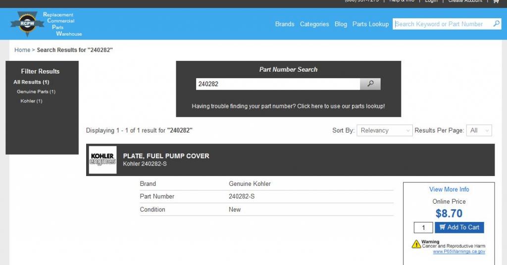

pfrederi 20,994 #2 Posted February 24, 2020 (edited) ACC only hot in run. But I wire mine there anyway. turn switch on listen to pump when sound changes float valve has closed turn to start and she fires right up i do not use "I" because i do not want to take any chance of reducing voltage to the coil while cranking. I tend to leave old pump in place or make a plate. Kohler #240282 Edited February 24, 2020 by pfrederi 1 1 Share this post Link to post Share on other sites

squonk 47,751 #9 Posted April 4, 2020 Kirk Engines. Billet aluminum fuel pump cover with gasket and screws. https://www.kirkengines.com/index.php#AluminumCovers Share this post Link to post Share on other sites
