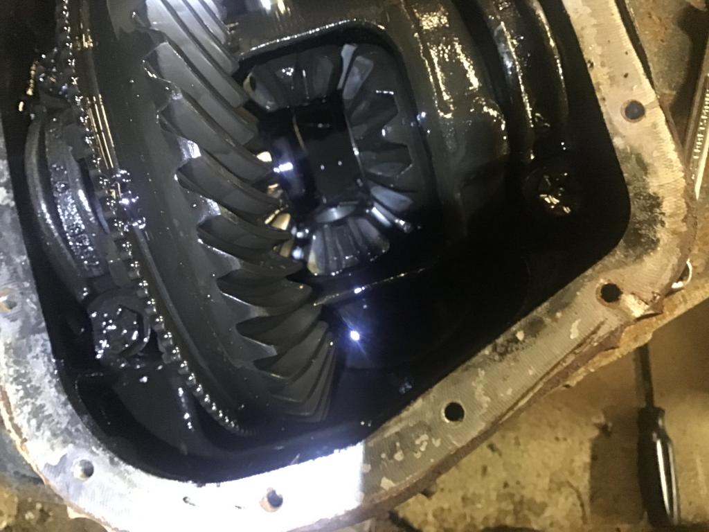

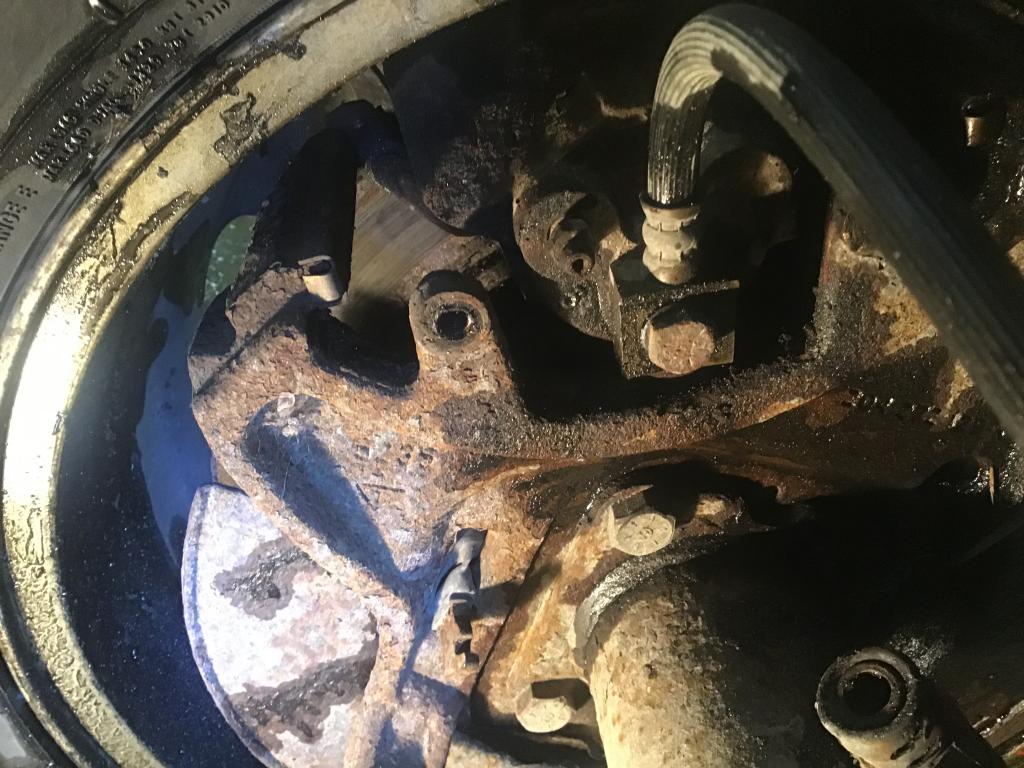

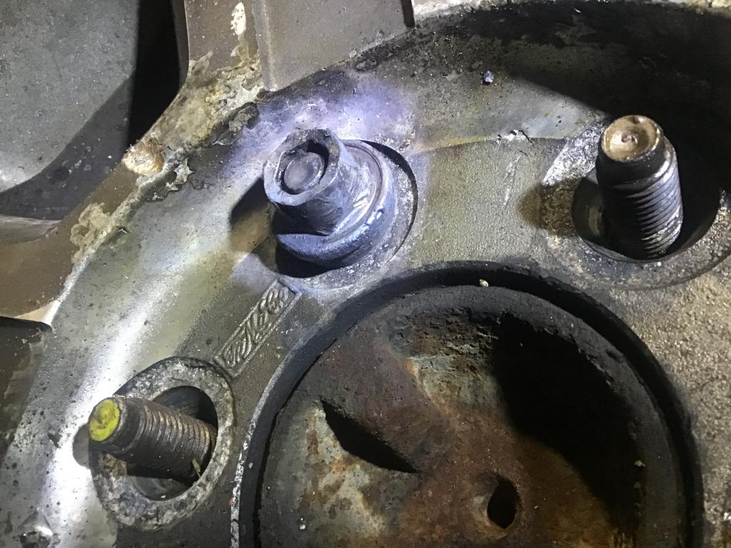

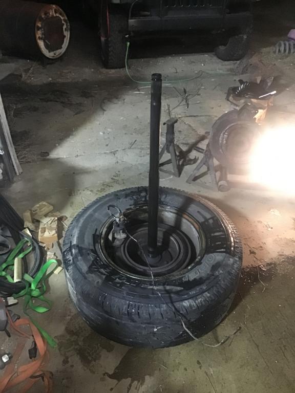

Pullstart 69,001 #1 Posted February 24, 2020 I have a friend’s daughter’s truck in the shop. A bearing in the center section littered the entire differential with metal shavings and bad news. There even appears to have excessive wear on the ring and pinion because of the slop. Yep, it was howling real good by the time it made it here. It was decided it might be cheaper to find a replacement rear end in the local U-pull-it. After two broken breaker bars, plenty of torch action and other quenching methods like water, wax and various oils, plenty of sledge hammer action too, I’ve decided to pull the whole axle out of the differential! Yep, I even left the junk yard with the additional wheel and tire, just to get it home and get that torch set on it! What kind of crazy things have you had to pull off just for a small task? 1 2 Share this post Link to post Share on other sites

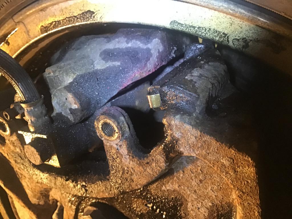

Pullstart 69,001 #2 Posted February 24, 2020 I cut the ears of the brake caliper off and it’s sliding out! Woo hoo! 1 Share this post Link to post Share on other sites

Pullstart 69,001 #5 Posted February 24, 2020 6 minutes ago, Shynon said: I see the FoMoCo logo that's your problem I agree. I am victorious so far... I hope to get the old unit pulled tonight so I can return the core (and unwanted wheel and tire) and hope like crazy that my favorite flannel hoodie is still hanging on the side of the donor 2 Share this post Link to post Share on other sites

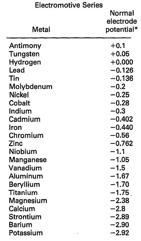

ZXT 2,401 #10 Posted February 24, 2020 1 hour ago, briankd said: i had bad luck with chrysler junk doing this Lets change that sentence to "I've had bad luck with dissimilar metal corrosion". That's better. 1 1 Share this post Link to post Share on other sites
bc.gold 3,406 #11 Posted February 24, 2020 In the electromotive series titanium is below aluminum so compatibility should not be an issue. https://www.acerracing.com/collections/titanium-lug-bolts Share this post Link to post Share on other sites

JoeM 9,650 #13 Posted February 24, 2020 (edited) grind some flats with a zip tool. maybe a drive on nut remover or weld a nut over the existing nut? air chisel maybe a good bet. since there has been heat added already and thermal expansion if you can get a nut welded on tighten it first then loosen? 20 years ago I had one like this and it was because I started out badly. Not wanting to get the correct socket. It was recessed and I had to use a torch melted the nut off. Ugly. Edited February 24, 2020 by TractorJunkie Share this post Link to post Share on other sites

ri702bill 11,421 #15 Posted February 24, 2020 Back to removing a stuck aluminum wheel once all the lug nuts can be untightened...... I learned this trick working part time doing front end work at a local tire store. We had a Mercury Cougar XR7 come in for 4 tires - it was quite apparent the owner never had the tires rotated by the tire wear. One of the two younger guys got the job, but neither of the 2 front aluminum rims would budge - even with the large mallet that looked like the kind you see in the circus. The Service Manager told him to reinstall all the lug nuts by hand and back them off 2 turns. He did, and the Service Manager took the car outside to the end of the parking area and did a series of left and right figure eights at about 5 MPH - sure enough, snap, snap and they were loose. Bill 2 1 Share this post Link to post Share on other sites

prondzy 3,889 #17 Posted February 25, 2020 On 2/23/2020 at 7:50 PM, pullstart said: I cut the ears of the brake caliper off and it’s sliding out! Woo hoo! Before you heated up the problem nut you should have just drilled out the stud. Just got done doing this a couple weeks ago at work. Had the wheel off in less than 5 min. 1 Share this post Link to post Share on other sites
Pullstart 69,001 #18 Posted February 25, 2020 31 minutes ago, prondzy said: Before you heated up the problem nut you should have just drilled out the stud. Just got done doing this a couple weeks ago at work. Had the wheel off in less than 5 min. I guess I would have had to pull the axle to change out the seals anyway, but that would have worked too! I’ll remember that trick... Share this post Link to post Share on other sites
